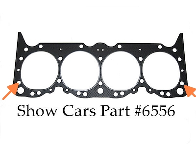

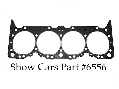

    I also looked at the head gaskets for Mark IV's and 409's it looks like they only moved 2 head bolts in the top row per bank, it looks like the rest of the head bolts even line up...

    Over lay the gaskets and I think you will find at least two more, end cylinders bottom outsides..What did those heads use for alignment dowels, like SBF bushings at couple head bolts or separate location? Lotta holes ....

    yes, the two larger holes at the ends of the upper row use alignment dowels that the head bolts p*** through. I always liked that deal on BBC's. As far as the alignment, you could be right, i dont have any 409 head gaskets here to compare, was just looking at the photos. Regardless, the majority of the head bolts look to be in the the same place.

    Seb, you figure these two? (orange arrows)
    Could be right, the Mark IV looks closer to the bore centerline??? But its hard to say, the photo of the 409 head gasket was taken at a slight angle from the bottom, the Mark IV gasket photo looks dead center. Would be interesting to lay the two gaskets on top of each other.

    Just me eye-balling them --> the 409 head gasket and the Mark IV head gasket are definitively different. I don't think much of anything is an exact match, except they are both Chevrolets. :)
