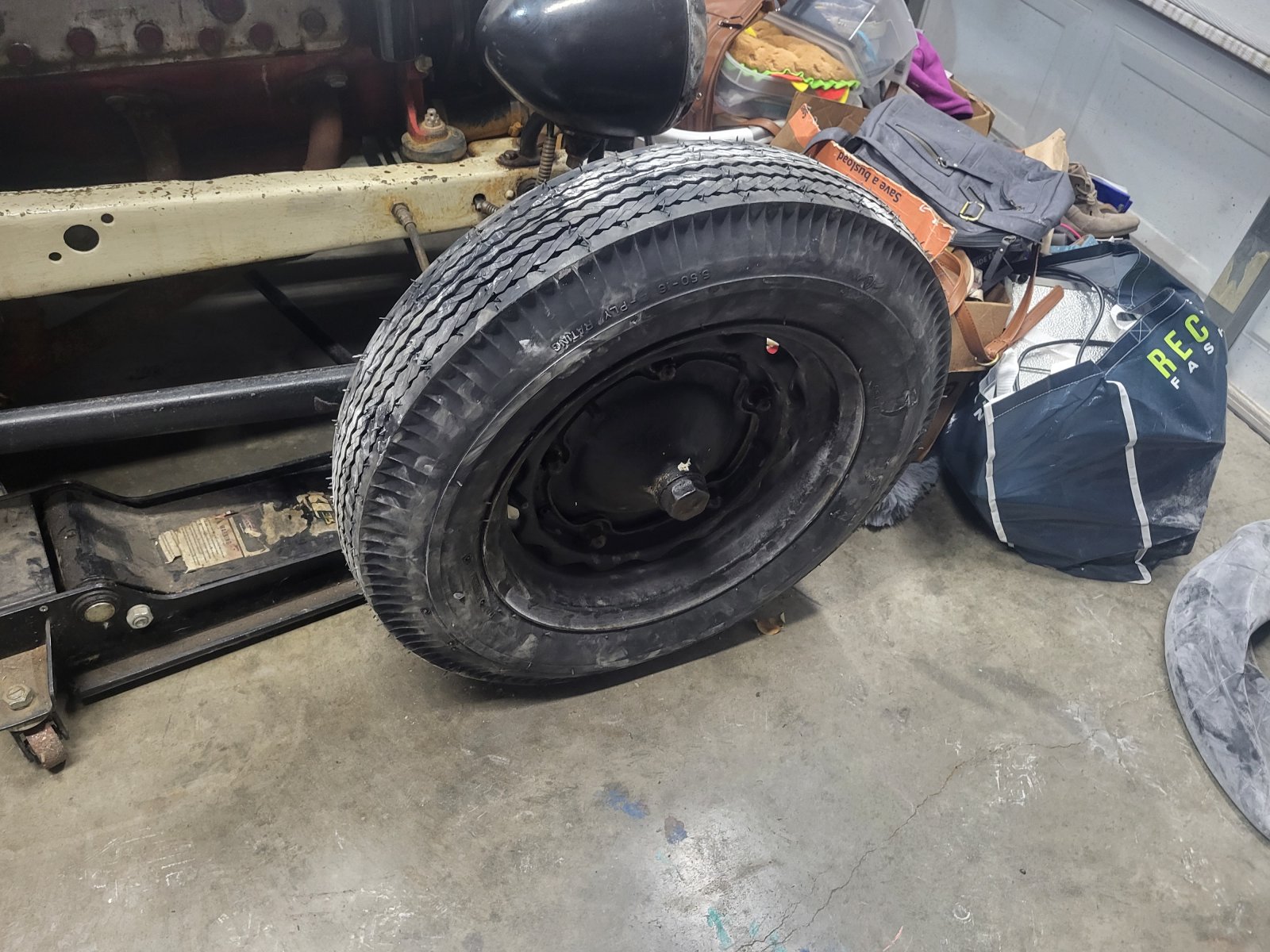

    Per usual I can't leave well enough alone. Had a few minutes today. My front tube is supposed to he here shortly. Just something to get it on its own weight for now. The actual tires and tubes won't be here for a bit.
    Got the tire off the rim.
    Duck tape as a "flap"
    Half the tire back on.
    Baby powder
    Tube partially inflated and installed
    Make sure nothing is pinched
    Install the 2nd bead
    Fill with air.
    Done
    Never done that before but I watched a YouTube video once lol how hard can it be?
    Wheel off
    Tire off
    Back on and down on all fours
    Turns out pretty straight forward really. I guess we'll see how it goes with the new rubber later. I ***ume that will be more challenging.

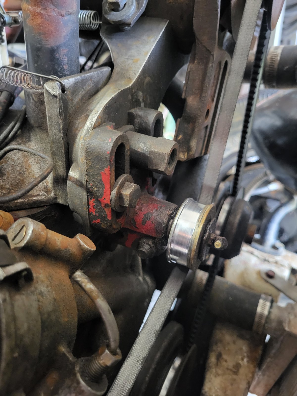

    What do I need to locate to put a fan on here?
    This little idler would go away. As well as replacing the narrow belt with a wide one that actually fits the pulleys

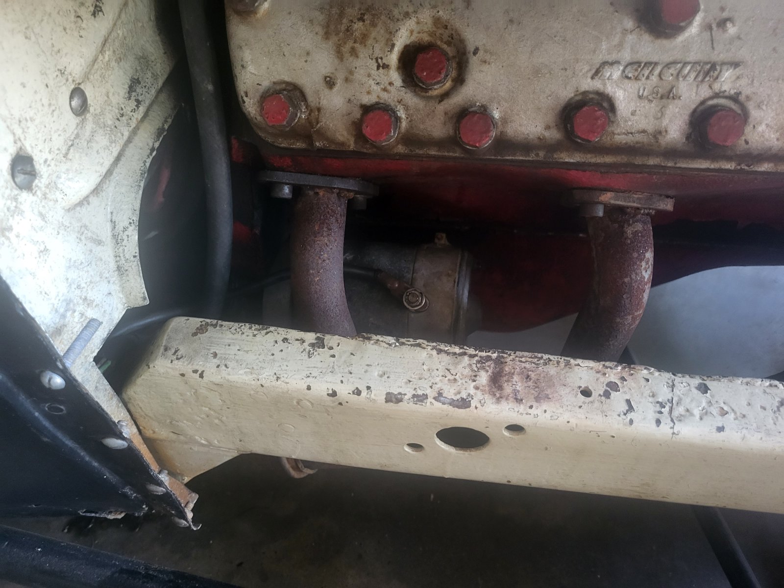

    Can we see what kind of space your working with with the photo taken from a little further back?

    Actually kind of figured it out already just haven't put anything together with the upcoming move.
    Got basically a NOS 8BA fan and mount from my friend Gene Cross back in IA.
    Got a dual belt crank pulleyto drive the water pumps and Gen on 1 belt and the fan on another. Seems like it will have room with 1 exception.
    The current crank pully is up against the front crossmember so I'll need to adjust things to make 2belt pully work. Either by raising the front of the engine or clearancing the crossmember.

    Is the front member stock? Most hot rods I see have the whole back area where the banger mounted cut right off

    @Tim no that tray that's normally on the backside is gone already.

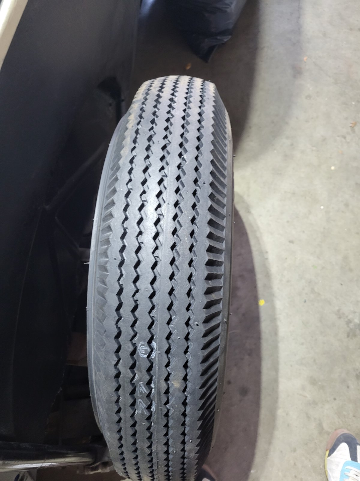

    First order was new tires
    Went from 600/700x16s to 550/750x16 Firestone blackwalls. Basic hot rods 101
