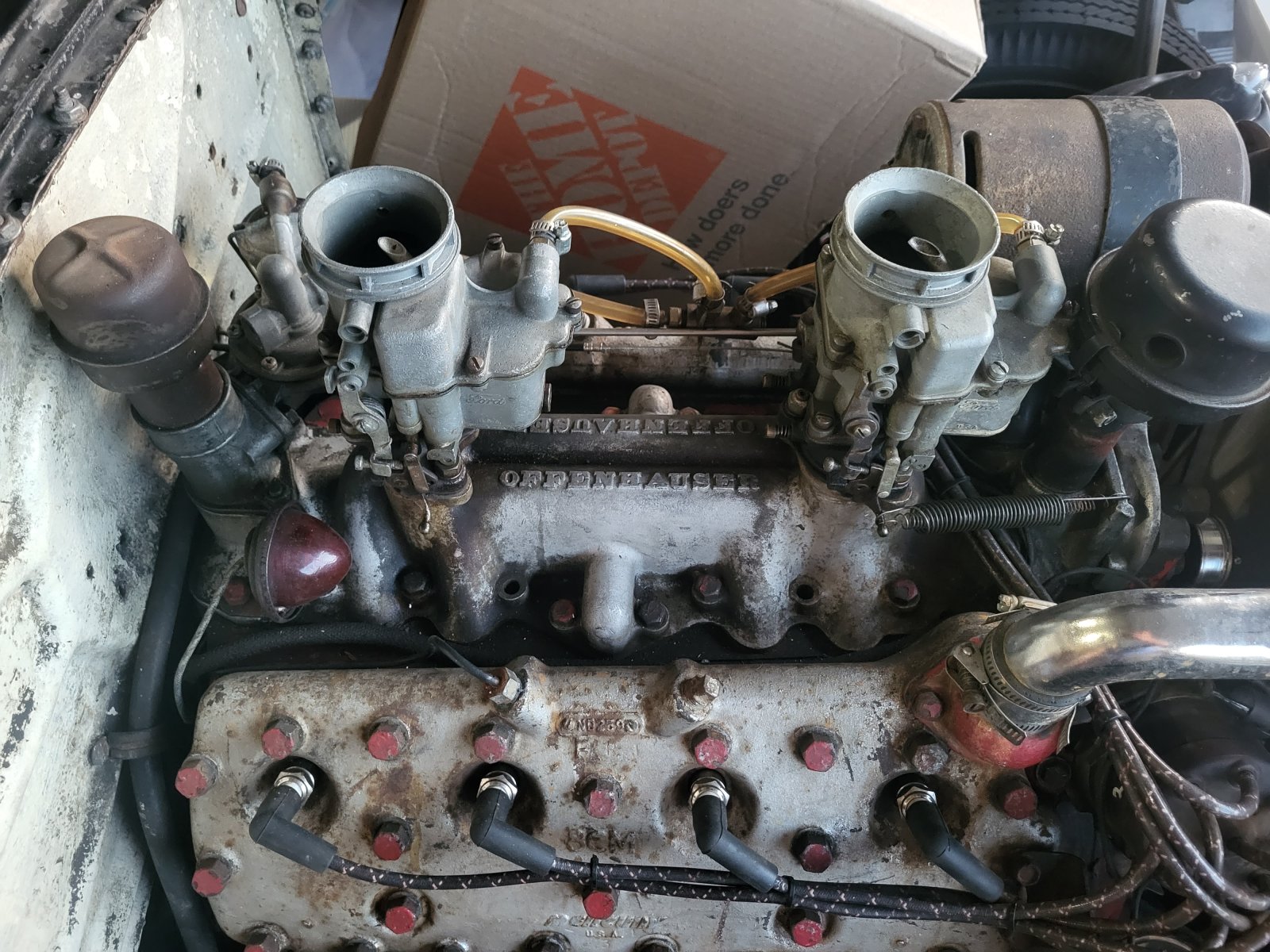

    So as you do when moving the got boxes in with boxes and air that needs to go to storage cause this temp home is only temporary. Until we sell our TX house and either get kicked out for being a hoodlum or our lease runs out at which time we will look to buy something here.
    Anyway I started digging it out today cause I like being able to see it when the garage is open (+ street cred with my law mower jockey retiree neighbors)
    Ordered rebuild kits for the carbs.
    Ordered choke parts for both carbs as I've always been told 94s like the choke plate in place even if you aren't using them.
    Got intake bolts to replace the ones that are missing (more on that later)
    Got a proper throttle pedal so I can relocate the one that's in a goofy spot on the floor
    Got an 8ba fan ***embly and dual belt crank pulley
    Rebuilt starter (installed)
    Rebuilt Generator (not installed)
    Need to clean up a bit more before I can really dig in. But I'm full go with bench building.
    Current goal is to have it roadworthy by the Run to the Sun car show here in Myrtle Beach in early spring. Not sure if I'll get everything sorted out to make that happen but it's a spot on the calendar to shoot for. Not too close not too far.
    So I got some bolts to replace the missing bolts holding the intake on. Turns out I didn't actually look at the holes. There's no holes in the block to put bolts in. This 8ba intake is drilled for a 59a with extra holes that aren't there on an 8ba block. That normal for these intakes? The rest of the intake says it's for an 8ba. It has the front oil fill and road draft tube that 59as don't have since they road draft through the block and oil pan.
    But it also has the 59a style oil fill%fuel pump stand on the back too. That's easily bolted on though so not that weird there.
    I also got an 8ba dual belt crank pulley so I can run a mechanical fan but I'm realizing i'm going to need to raise the engine to use it since the one on there now is too close to the front crossmember as-is unless someone has any better ideas.
    That's pretty much it just getting thoughts in writing for future reference lol.

    I rebuilt both carbs. 1 carb I found the throttle plates were flipped and upside down. Probably not a big difference maker but I switched them back.
    That same carb had 1 jet that was put in crooked and boogers the threads. Not bad enough that I was able to work the new jet in and out slowly and straightened them out and got the jet fully seated without ****ing things up so that was a win. I tried going to my parts stash but didn't have a better main body than what I had
    Both carbs had mismatched gaskets for the clusters and a**** some other gaskets that definitely needed replaced.
    That was last night and I had a tank set at work first thing this morning so haven't had a chance to try running it yet to see if anything changed with the popping as soon as you crack open the throttle
    Went with 5.5 PV in 1 carb and a power valve plug in the other. Same as I did on the 59a in my old '47
    .048 jets
    Both pv and jets are the same as I ran back in Iowa so I'm ***uming I may have to play with jets a little since I'm at Sea level now.
    Also not above any advice for jets or PV selection. So shoot away.

    Kick *** looking forward to hearing how it goes. I’m curious if you checked the bottom of the carb for flatness while it was off? Seems like a pop could be a vacuum leak?

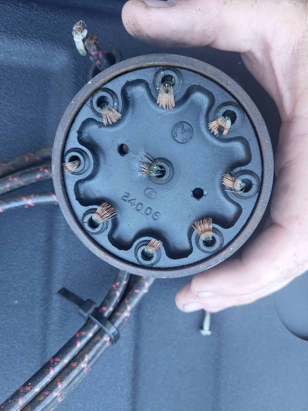

    Video was last night. You can clearly head it missing when you try to give it any throttle. You have to sort of work it up to get the rpms up and then it pops out the exhaust at random intervals. Its kind of hard to hear the pops in the video but in person they are much more snappy and louder.
    Pulled the distributor this morning. I have new stuff coming as I said but still wanted to mess around with what I have while I want for new parts.
    The cap is 2 piece. There's definitely some crustyness inside. Amd what looks like arc tracing between 4-8 and the beginning of another trace off of #5
    I wiped some dirt and oil off the unit. Grabbed some 400 and touched up the points, touched up the contacts in the cap as best I could. Made sure firing order was correct base timed to get it running. And it seemed a little better but still popping. I pulled wires at each plug while it was running. 4 & 8 didn't seem to make any difference while the rest you could head it drop rpm a little.
    My currently thinking is that 4 & 8 aren't firing and the unburnt fuel mix is getting pushed right out into the exhaust where uts getting ignited by the hit exhaust from the other cylinders. That would seem to explain why the popping out the exhaust isn't timed consistently and also why it happens more after running a little bit and things start warming up.
    I feel like I'm starting to narrow in on it and am hopeful my new parts will help.

    Is 4&8 getting spark? Weak spark? Put one of those light up thingys in line with the plug wire. What do those 2 plugs look like?
    Since 4&8 are across from each other, makes me wonder if those cam lobes are going away, hope not.

    If my theory is right then the cam would need to be operating to get the fuel mix out into the exhaust right?
    I suppose maybe going out but not gone yet would still work.
    I'll look into that.
    After the new ignition stuff my next step is going to be pulling heads I think.
    Fuel, spark, compression.

    I could be wrong but, if the 4&8 are arcing across each other, wouldn’t they both be firing when 4, and then 8 fire? So both actually firing twice on one revolution.
