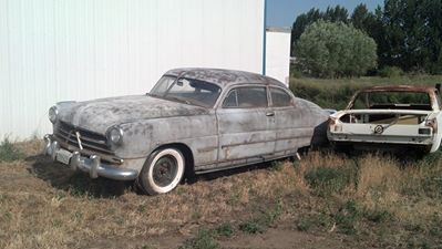

    Hey guys my name is Jeremy. Some probably remember I'm the guy who traded my red ram hemi for the slaughtered 50 Hudson with 95% of parts minus motor and Tran. I also kept the carb off the hemi and he gave new a running nv3500 5 speed with shifter and driveshaft, and a 360 4bbl motor. The hemi wasn't running. Well the body work on the Hudson has begun! She is covered in surface rust but no really bad rust, floors are great, and suspension is actually really nice. The previous owner changed a 4 door sedan into a "suicide pick up truck door set up". That's the best I can explain it. I will show before and after photos. You have to open the front door to access a mini back door... Its awful. I love strange unique things, but this hurts my eyes to see this done to such a classic. Sunday was my first day on the build. I pressure washed the frame, sanded and primed the hood, and media blasted the dash frame. I plan to weld the "back door" to the body and turn both back side windows into one window and have a 2 door sedan. I may take her back to for door sedan but that requires more money and I have everything i need to fix this awful body modification. By awful I am not saying its not great from a skill standpoint because he did a great job, I'm just saying it does ruin the look of the car in my opinion. Here are some pictures of before and what i've done so far. I would love some honest opinions. I'm a mechanic guy and am newer to body work. The hood was rough and still needs some. work, but I did this with good ol' sandpaper and an air compressor to blow off the rustf ...

    Here is another picture of the hood and some of the before pictures.

    Here's the hood before and the crazy doors before I weld the small one down and add a door post.

    The doors may work now, but without the center support pillar, I would be concerned about body flex.

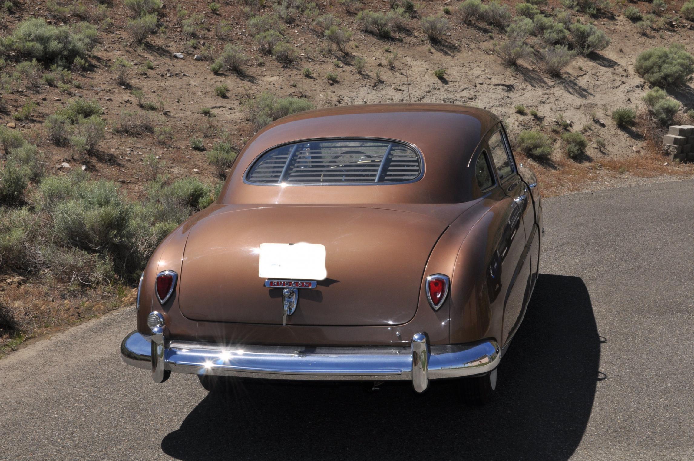

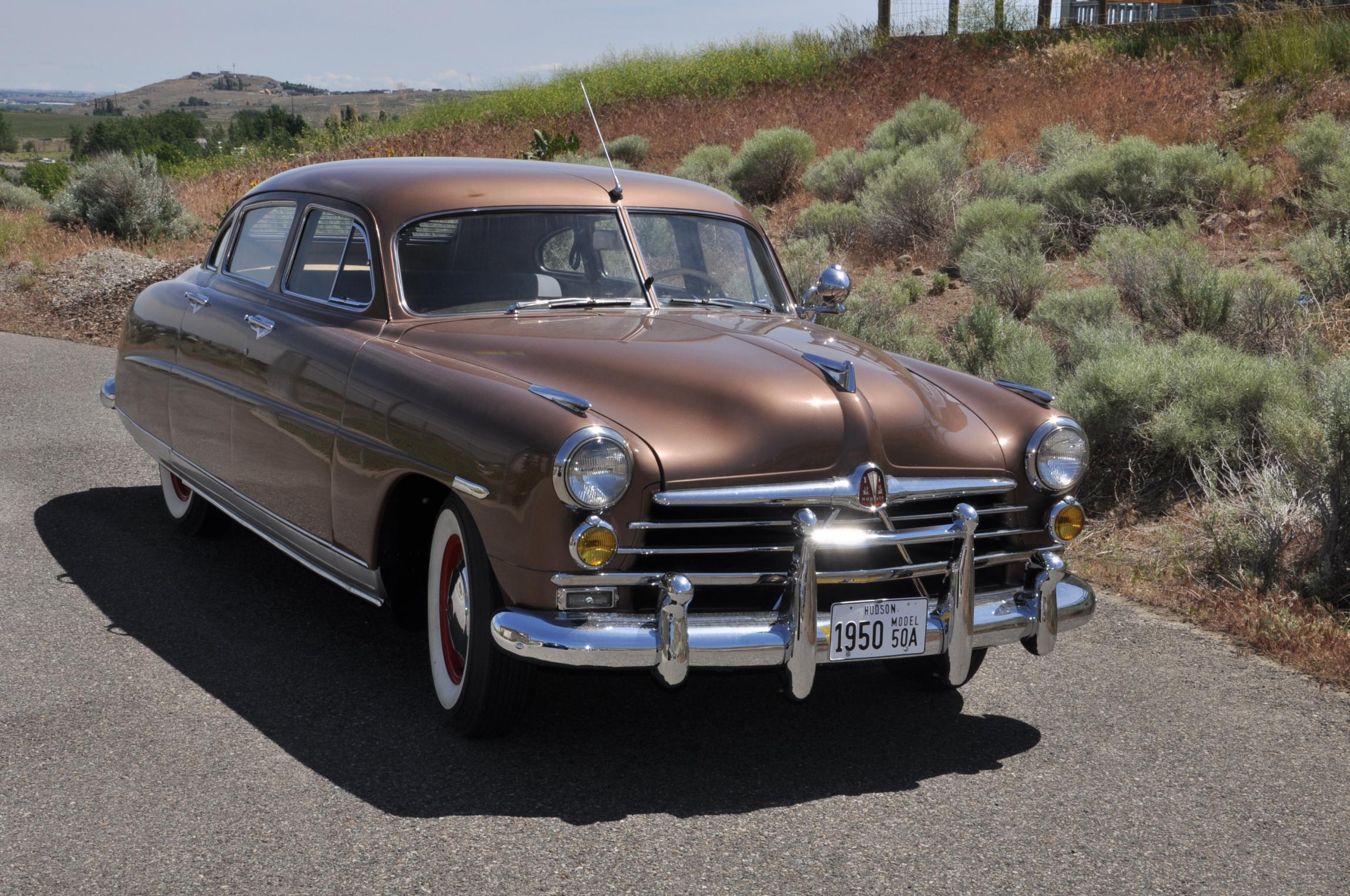

    Interesting, looks like what they did was put the larger coupe doors on the car because they liked the bigger doors, moved the B-pillar back, and cut the rear doors down to a much smaller size and changed the hinging system. Good luck! Here's some pictures of my 1950 Pacemaker Deluxe sedan that I restored a few years back. Runs and looks great!

    Oh, didn't see the latter picture. yes, you need to replace the B pillar for stability. You could put it back where it goes and obtain proper sedan doors for your car. Those are readily available. The couple doors could easily be sold to others looking for those for their cars.

    See, I don't believe he even used coupe doors. He elongated the original doors and cut the original back doors. The first thing I asked him was what he did with the pillar and he said he threw it out. No idea why...he saved everything else.I have 2 sedan doors and two more elongated doors. Does anyone know offhand how long the coupe doors were?

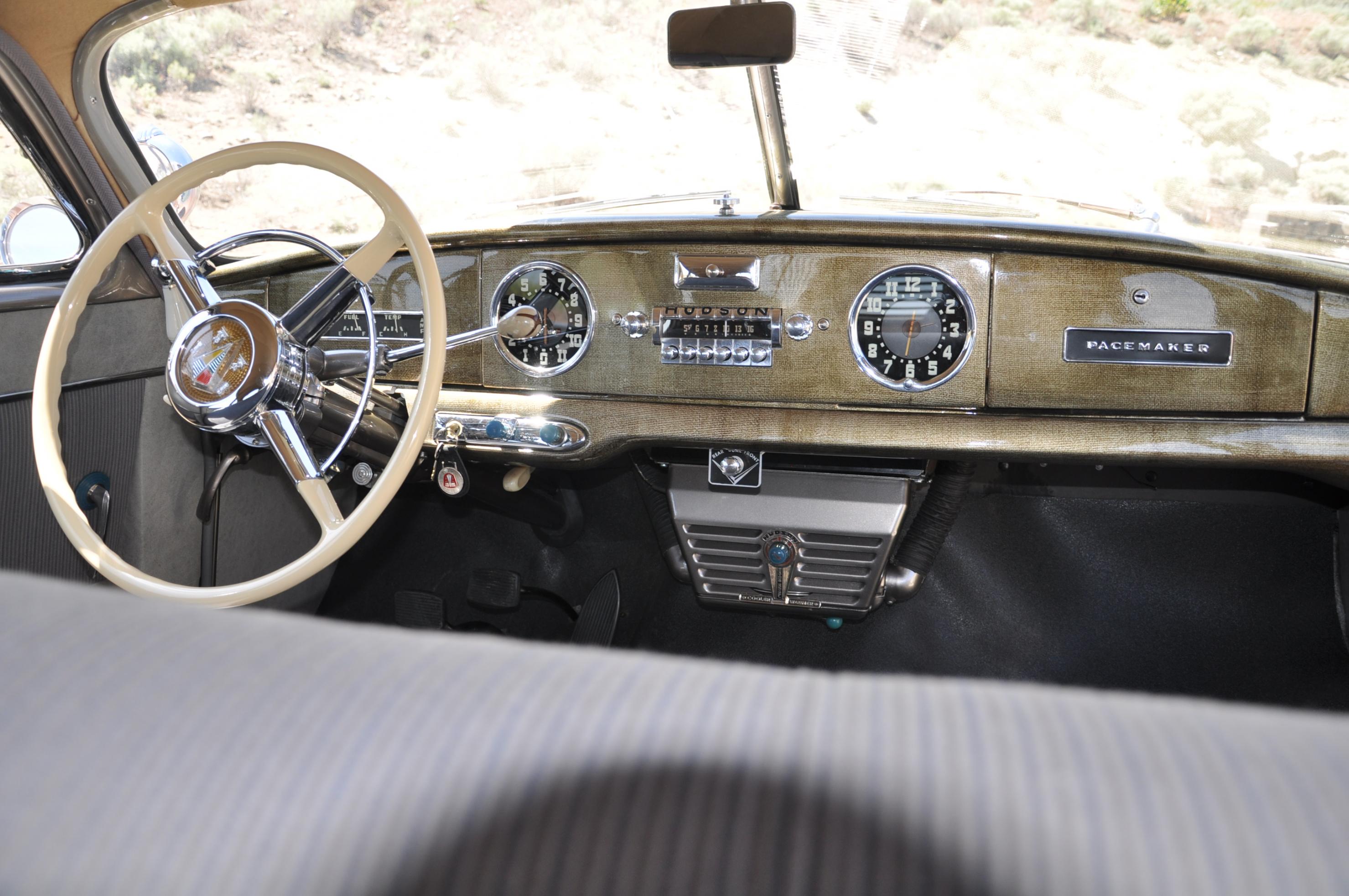

    Your car looks awesome. That was the same kind of color I was thinking... i was going to go through the code list from' 50. Was that the three spoke steering wheel? The only glove box door I have says Commodore.

    Yeah I love the interior. The three spoked steering wheel looks great.

    Doc Hubler where did you get those rear window shades and how do they mount?
  18. Doc Hubler
    Joined: Aug 17, 2013
    Posts: 41
    Doc Hubler
    from Washington
    The window shades were an actual Hudson option. I think they are screwed in at the top and bottom and they do not move at all. One of the nicest options to have. It's as easy to see out the back as without them and it keeps the hot sun off the package shelf.
    The steering wheel is the original wheel. Pacemaker Deluxe got the fancy Commodore style wheel with horn ring. I think the regular Pacemaker was a two spoke Plain Jane.
    The 1950 Pacemakers were the only year and only series that Hudson used the "Fabric" dash on, or burlap design. Very hard to replicate, especially considering how the originals were made.
    My car has added options including the cigar lighter, fog lights, back-up light, radio/antenna, rear speaker, spare tire valve connector (can check spare tire pressure without opening the trunk), and grille guard. I also have added an electric fuel pump. The original engine was gone when I got the car, but it has a 1950 Super Six, or 262 engine, with the original Pacemaker 500 head, so it has a little better compression than the standard 262.
    SMS Upholstery Fabrics in Portland, OR is now reproducing the upholstery used in Pacemakers.
    I have a 1950 Commodore Six Coupe that I am going to restore. It is stock, but fairly rough right now. The dash on the Supers and Commodores were the same basic layout as the Pacemaker, but there was added brightwork to the dash, especially the Commodore. The heater/fan controls were on the bottom of the dash where the driver could easily reach them. Here's a picture of that car. We are doing restorations at Perfect Shape Auto Body in Benton City, WA. We have just started a Facebook page and will have much more to post. I am finally almost starting the downhill side on my 1967 Oldsmobile Toronado restoration project.

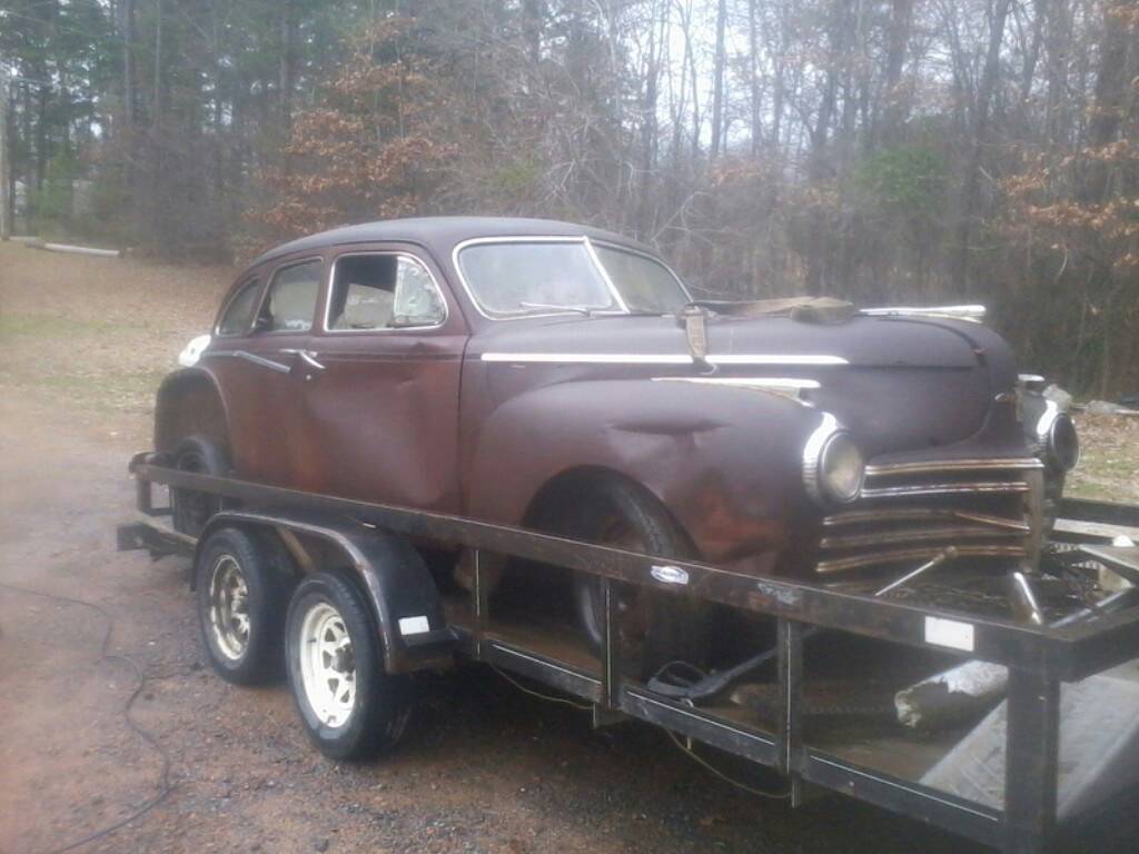

    Well guys, I've got a trade offer for this huge Hudson project. 1941 Chrysler Royal which is ALL there except a starter. Has a spitfire inline six. What everyone's thoughts/opinions?

    It is a four door with "suicide" doors. I'm a coupe guy myself. I've
    got the Hudson for sale. You can have it in your backyard for a good price! I have so many projects. Here is a picture of the 41 Chrysler royal. The rear fenders are not on but they are included.
