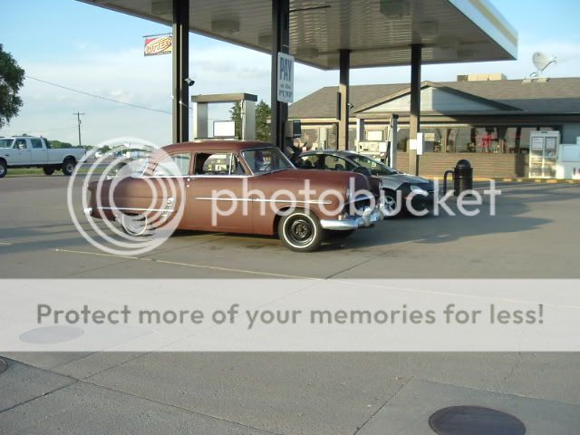

    gasing up getting ready to leave

    Cool man! That things a ****ing cream puff! I like the nosed, olds taillights, no grille and hubcaps. Get some bias plys for it and it'll look like a high schooler's car! :)
