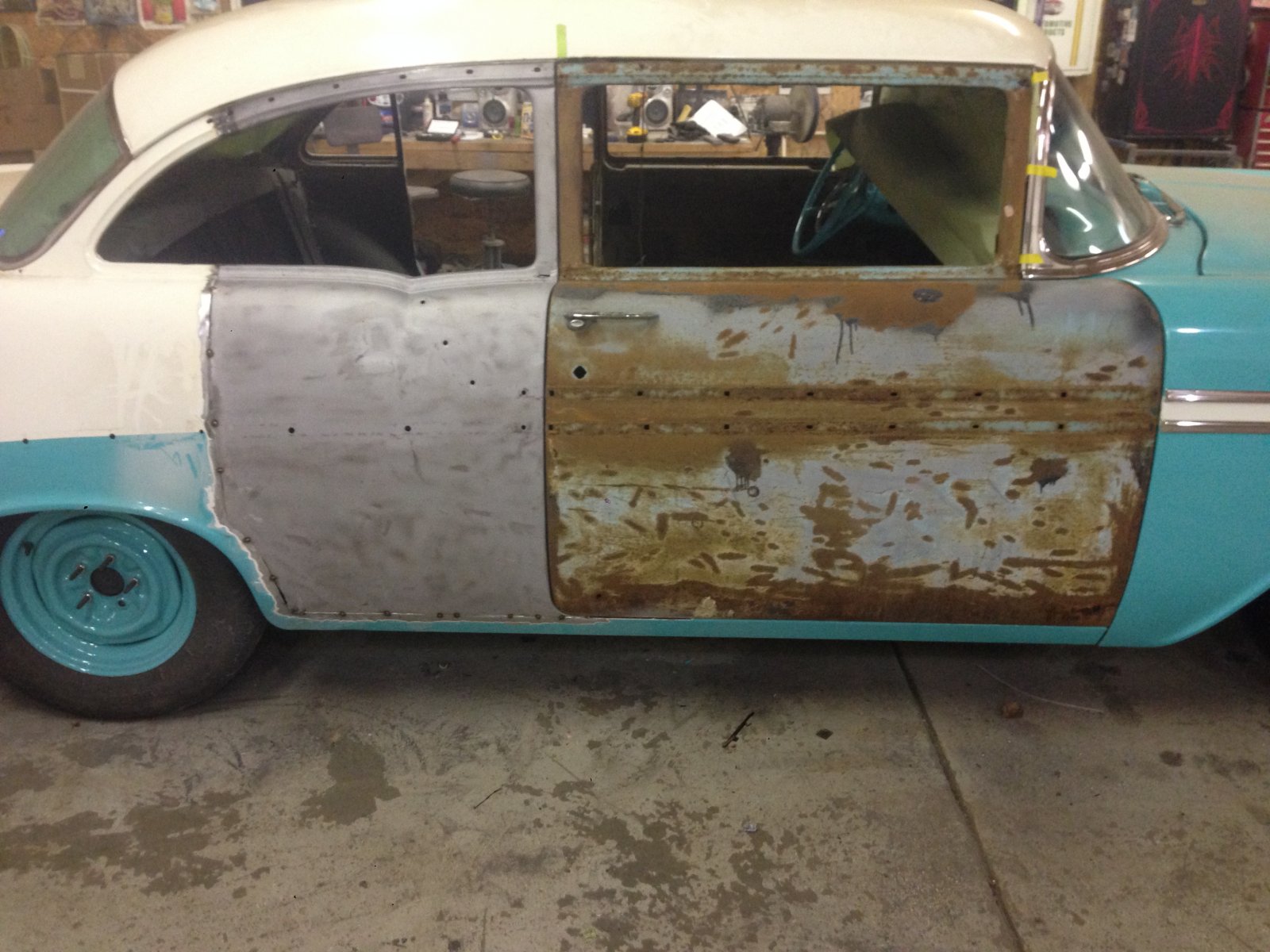

    I've done a bunch of 2 door conversions, here's my latest on a '57 that I have been driving all summer (drove it to work today in fact)
    https://www.jalopyjournal.com/forum/threads/57-chevy-2-door-conversion-pics-build-thread.1199065/
    and here's an old one on a '56 I did for my dad
    https://www.jalopyjournal.com/forum/threads/56-chevy-2-door-conversion-build-thread.753008/
    You really want to get some donor B pillars, I know guys do it with just longer doors and fill in the back part with old rear door sections and the 4 door posts but having donor bits makes it so much easier and then quarter window regulators bolt right in, too. I have extra pairs of B pillar cutoffs I could sell you but you're awfully far away and I don't know how you'd possibly ship them.
    Certainly if you have any questions about the conversion let me know, it's kinda my signature move at this point and I love to talk about it. Lots of pics in the threads linked above (along with 2 different methods of cutting) but I've probably got more if there's something specific you need to see.
