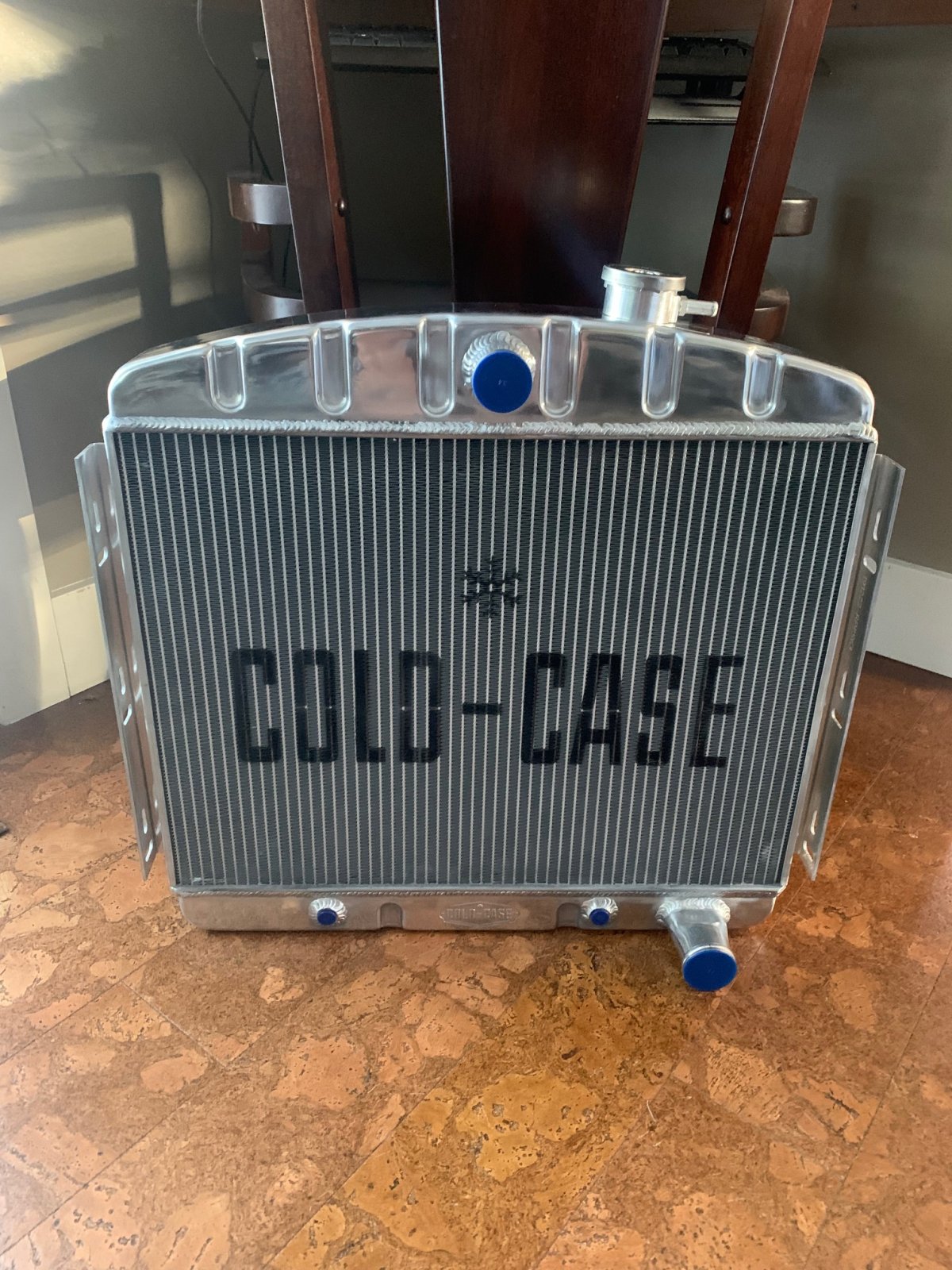

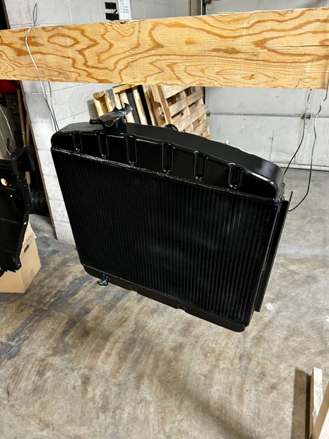

    Not much new picture wise to report as I have been finishing off most of the dirty ugly work. Almost ready to apply the POR15 to the floors. I'm only going to do the rear of the inside of the floor where the rear seat sits as that was the only surface rust inside. I will be putting on the peal and stick sound deadener in the car so don't need the 15 up front. This showed up from Summit this week. Have to say the fit and finish of the rad is great. I will be painting it black like most of everything else that will be under the hood. This is the 6 cylinder mount rad as i want to run a mechanical fan as well as an electric. Cold Case says it will cool a big block no problem so we'll see.

    I have basically the same rad but Griffin, also in the 6 banger position. Painted the tanks and sides black but not the core. Paint on the core is just one more thermal barrier imo. Whether it makes a difference or not, I can't prove. Mechanical Jones fan only, no shroud. Needs a shroud but I haven't made one yet. As long as there's some air movement thru the rad, even 10-15 mph it will stay cool. Stop and go traffic forget it.

    I have an aluminum rad in my coupe and I painted the whole thing. Has always ran cool so not sure if painting the core makes a difference or not. I'll fab a shroud once I have everything in place and know the dimensions I need.

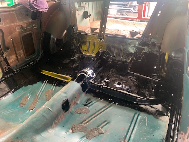

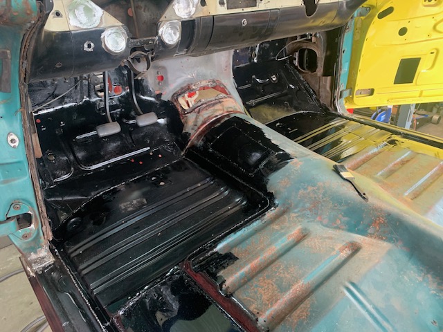

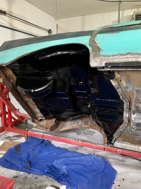

    Applied POR15 on the floor boards front and back today. Stuff is nice to work with for sure. Will be doing the underside of the floors tomorrow with the exception of the last few inches in the back as I still have to weld in that new section. Car needs to come off the rotisserie to do that hence why I am saving that for last. I'll be laying dynamat on the floor as well which is why I didn't do the POR15 over the entire floor. Happy to be at this stage and rolling forward.
  8. SS327
    Joined: Sep 11, 2017
    Posts: 3,881
    SS327
    Don’t cheap out paint the whole floor and seal all that rust up. Dynamat will do nothing to protect the floors.

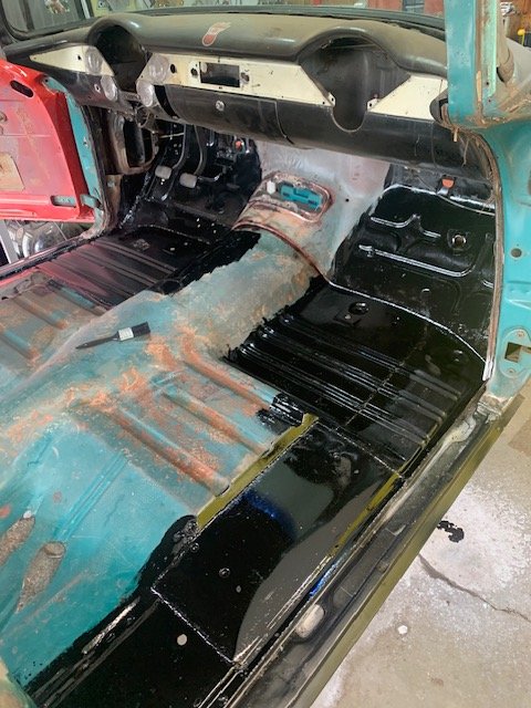

    Slowly but surely... Really took my time on the final prep of the floor and then the cleaner/degreaser, and metal prep steps to make sure we get the best application. Lots more to go but happy so far.

    and done! Sure looks a lot better than before. The POR15 gives nice coverage.

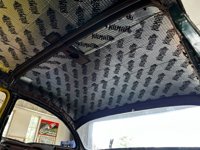

    Keepin the bus movin! Put the sound dedeaner on the roof today. It's the little things that are satisfying on a build... :)

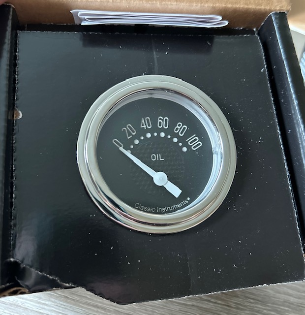

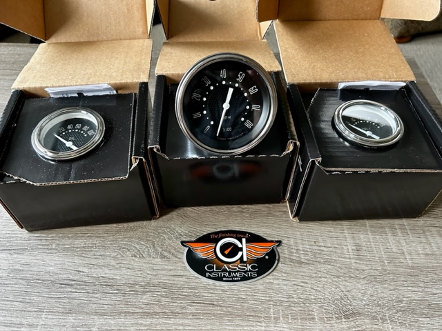

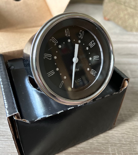

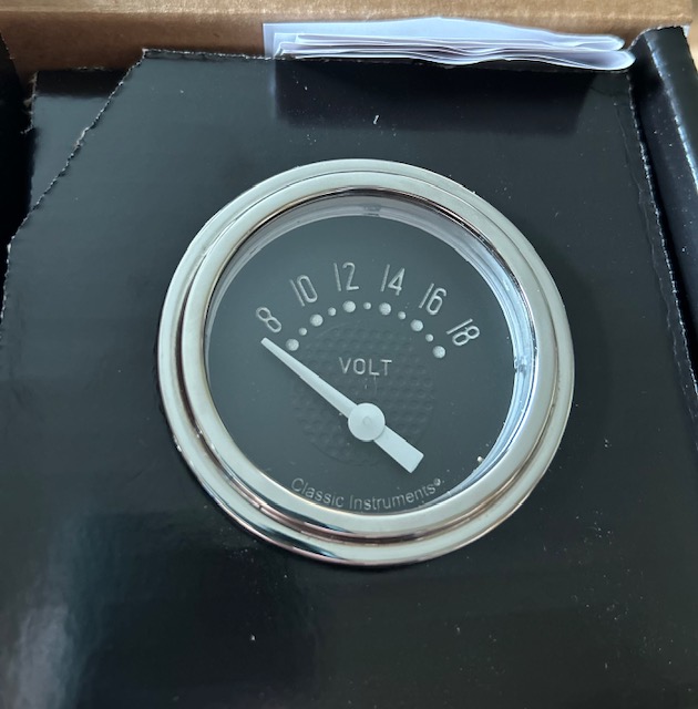

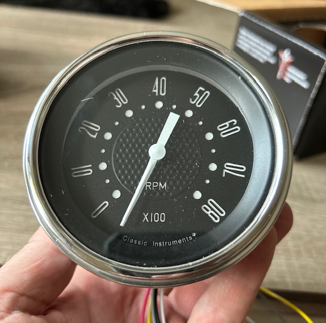

    Stoked to get this package today! I ordered a set of custom gauges from Cl***ic Instruments and they just arrived. I had them design the tach, volt and oil pressure to match the font and layout of the original gauge cluster as I will be running that cluster that I restored. I can't claim the original idea as I saw a pic of a guy online that did the same thing with just the tach. I just expanded on the idea with the two other gauges which I will mount under the glove box as is traditionally done. Tach will mount on the steering column in a chrome gauge cup. Think they turned out awesome! Not inexpensive by any means but there are a few things I always wanted to do and doing a custom set of gauges was one of them. Can't take it with you so what the hell! :)

    When I was chatting with the designer on them I told him they should just make them a regular series as there would be a ton of tri five guys that would run them to match the cluster.

    One of the 3 would need red/orange needles. ;)

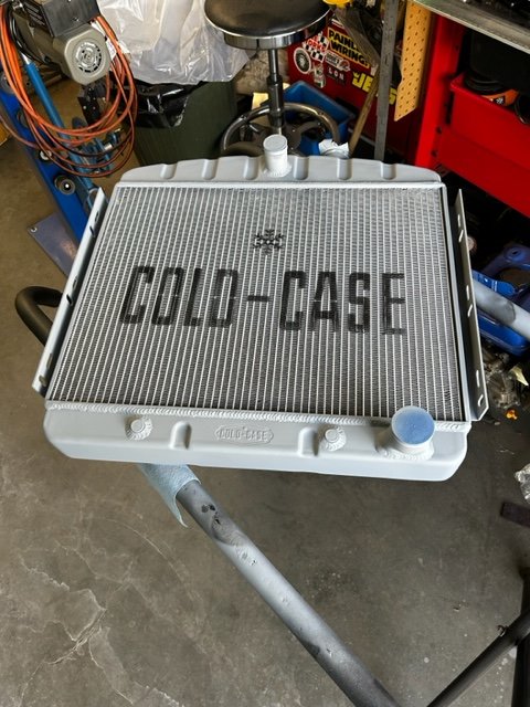

    Been doing a ton of work on the car lately. Lots of piddly jobs which aren't worth pics. Painted the frame and all components, built brake lines and ***embled rear end, mounted rear discs. mounted the CPP 25 gallon tank and plumbed the fuel line and also ran the battery cable that will run from the trunk to the master shut off etc. Have been painting a lot of different parts like rad support, inner fender wells and other little parts along with the new rad. Got the doors fully scuffed removing all the clear coat that was on them. Will start on body work pretty quick. Got my buddies to colour match the pinecrest green. Will tackle the Sherwood green tomorrow. Should hopefully have everything done far enough to roll the frame under the body in a month or so if everything goes to plan. Starting to get more and more excited! Off to Seattle this weekend to take in the national event at Pacific Raceways. The boys first time seeing top fuel in person. Can't wait for him to have the experience and I'm stoked to see the big boys run again as it's been several years since I have gone down.
    IMG_0627.jpg IMG_0626.jpg IMG_0614.jpg IMG_0637.jpg IMG_0639.jpg IMG_0638.jpg

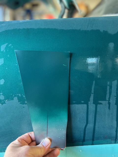

    winner winner chicken dinner! Think we got a match. Will fun blending the new with the old but I think I'm up for the challenge!

    I've watched a bunch of youtube vids on how different guys do it. Lots of different techniques but nothing that looks too crazy.

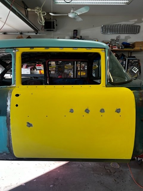

    Lots of HAMB illegal activity in the last few weeks. New frame completely together. Brakes installed on all four corners, rearend fully ***embled, brake lines built and she's a full roller. Started bodywork today. My first time ever doing body work so after watching lots of how to vids on the ol youtube I dove in and so far happy with what I got done. I guess the one luxury is I really only have a small amount to do vs a full car and because I am matching up to old paint/bodywork it's more forgiving. I am actually purposely not trying to make the filler skim perfectly straight so it doesn't stand out vs the rest of the quarter panel if that makes sense. I'll take it slow and make sure I get it done well/blendable.

    A straightedge is a great tool to use when doing this kind of bodywork, it probably won't be perfectly flat, but the straightedge should rock slightly along the whole area. You don't want to have a low spot at the seam in the quarter panel, or it'll be obvious what was done. A few test-fits of the quarter panel moldings would help too. Sometimes, if you use the type of trim clips that have studs and nuts instead of the factory snap clips, you can actually pull the panel into shape slightly with the molding, and it'll hold it there. If you can get that area nice and flat, you're golden.
