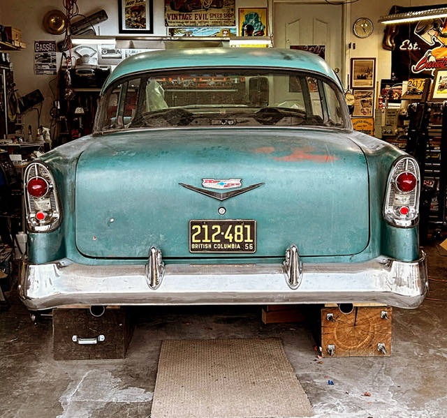

    Big milestone for the build as I got the body mounted onto the frame. Very happy with how everything went and the RS frame is as advertised with the body dropping nicely onto the frame with zero interference and just a couple shims needed. Have the car lifted onto some nice high blocks now so I can easily get under the car. I definitely have room for wider wheels/tires in the rear now that I have the body on the frame. I'll mull that over for the winter and decide what to do. I can easily run the ones that are on it for now so no rush. Onto the fun part of the program now! Anyone that wants to see more pics (HAMB illegal) here is the link to the build thread on the Trifive.com site.

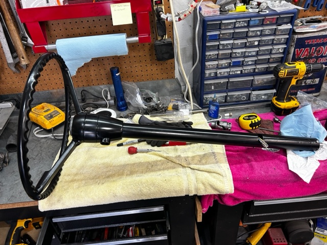

    Keep marching away at various tasks. Restored the original steering column and finished the conversion so it's like new columns with bearings top and bottom. Exhaust is installed and I got the AFR gauge bung welded in along with the Moroso vacupan tubes. First coat of POR 15 on the trunk pan today as well. Second coat on tomorrow and then carry on with more tasks. Weather has been super nice out here so taking advantage of the warm weather to keep doing work in the shop with the door open. White stuff will be on the ground before we know it!

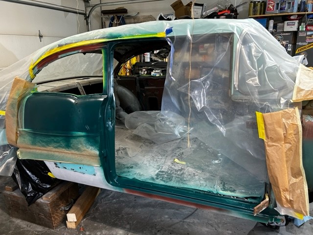

    Squirt squirt! Finally time to blend in some paint. Sherwood on the body today and doors tomorrow then the pinecrest in a few days once everything cures up real good.
