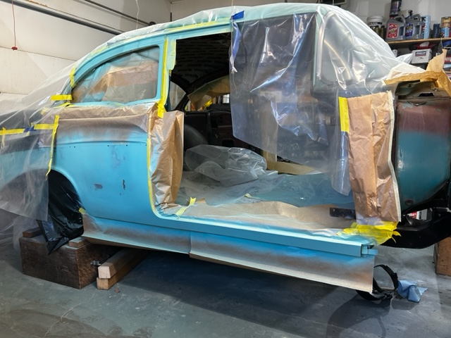

    Pinecrest sprayed on the body today. Doors tomorrow. Will let it cure nice for a few days then scuff the whole thing down to be closer to the finish of the original paint.

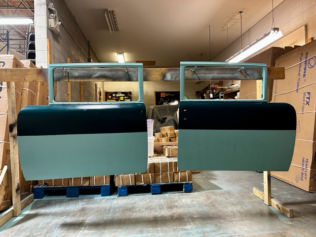

    Doors sprayed. I'll let them sit for the week then I'll start some scuffing to age them. Thinking I'll hang them on the car so I can have the rest of the body to view and match up the worn look as close as possible.

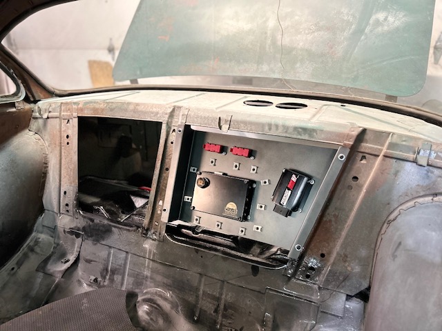

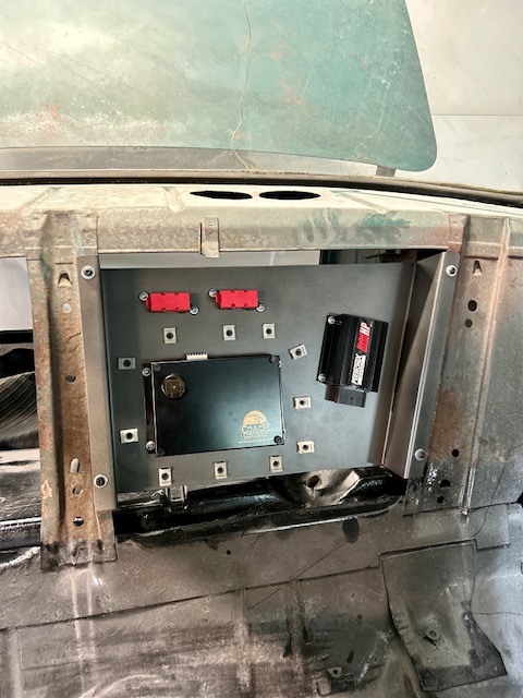

    I made a new mounting panel for the electrical as I needed more space for wires vs the first panel I made to mount in the other opening. Once I have the motor back then I'll start on running wires.

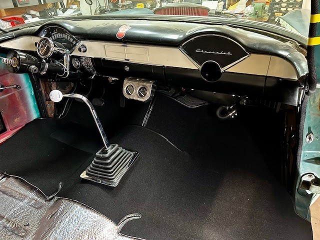

    Back by popular demand here is a nice big update on the 56. Car is essentially done and went for a small maiden voyage on Sunday. I slow down and really take my time at the back end of a build to be careful double checking stuff and making sure I'm not rushing and making stupid mistakes. Did have an older steel flex fan that apparently had a crack in one of the blades take out my brand new Cold Case rad on the second engine startup... :eek: That was a piss off buuut could always be worse. New original style horn for the 150 is giving me grief. Sporadically kicks on which after doing some reading on trifive.com seems to be related to the new replacement upper horn/bearing ring for the original columns. Can ground out on the steering shaft. Haven't quite licked that challenge but we'll get there. New original style temp gauge/sender for the cluster basically didn't work so ordered up a matching custom temp gauge from Classic Industries and fabbed a new three gauge under dash mount. My OCD would kill me not knowing the exact temp of the motor! Other little piddly shit to button up but for the most part we're at the finish line. Still have to install the remainder of the interior. Having an upholstery shop do the headliner install which they can't do until July. Have to say I love the stance of the Roadster Shop frame. Here's a link to my instagram showing a quick vid of part of the first drive.
