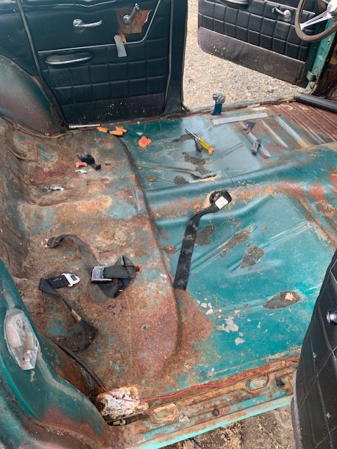

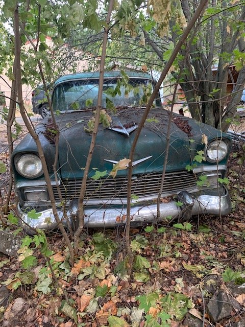

    And the fun begins! Nothing too major, just got the car up on blocks. The front blocks are solid wood that my father in law cut for me from his sawmill. Weigh a friggin ton but I wanted blocks that are tanks! Hate jack stands and have no desire to be squished like a g**** so it's blocks all the way. Having the car up nice and high will make the rockers replacement and floor pan work a whole lot easier. Rockers are here but still waiting on the floor pans and floor braces. Spent the rest of the evening going over the car with my son talking through the steps we are going to take and showing him some stuff. He's only 14 so has never been around the car much at all and this is going to be his first intro into a full build. He was too young and didn't have any interest when I built the coupe. I'm getting excited now too that we are at this stage. The sheet metal work will be the grubby work but has to be done so we can get to the more fun stuff!

    I use crib blocks like that too, I only use jack stands if I have to take the wheels off of something. I really think it helps when doing floor supports and inner rockers and stuff like that to have all the weight on the suspension so nothing flexes in unnatural directions.
    chryslerfan55, Stogy and loudbang like this.
  7. Same here for longer term work. Front wheels sit on blocks, and I use a 6 ton jack stand under the rear axle, so that the load is on the suspension, same as when in operation.
    Stogy, Fitnessguy and loudbang like this.

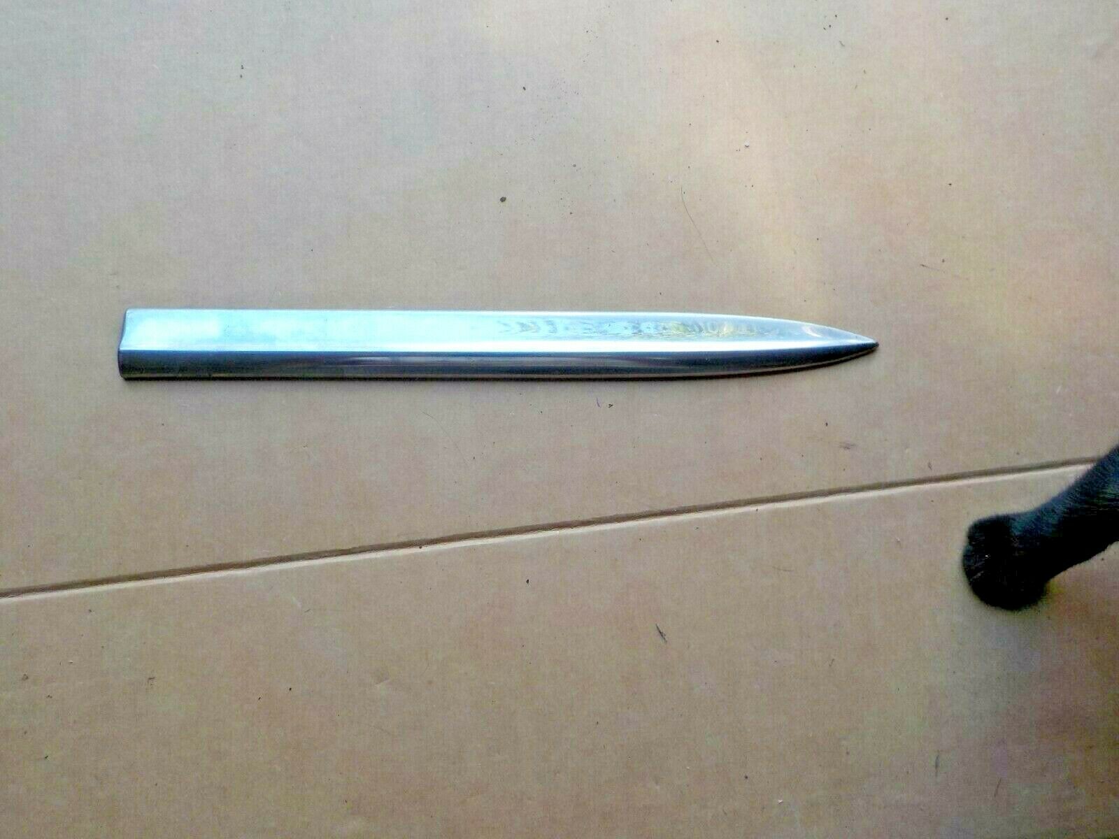

    s-l1600.jpg Looking for the drivers side 150 quarter panel stainless spear side trim. Was able to find a p***enger side piece. Anyone have one let me know!

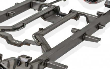

    Took the big plunge today. Ordered a complete frame from Roadster Shop. I won't show any pics other than this cropped pic so I don't get in trouble with the bosses. I've always wanted to do a build with a full aftermarket frame and all the cool parts. Realistically this is going to be the last car I build from the ground up and with the car being in the family for 50 plus years, she deserves the best! I did a ton of research on all the manufacturers and different designs and then I did a side by side comparison of restoring the original frame and upgrading all of the suspension, adding a K member etc vs going the full new frame route. Not as far off a difference in price than a guy would think by the time you factor in all the fab work. Yes I would have done the work myself but it's still time which is money when you own your own business. This way I can pull the body off the OG frame once I'm done the sheet metal work, get it sand blasted and then send her off to paint jail while I have the frame sitting waiting. I will build my brake lines and exhaust and anything else that needs to get done while I have the frame on it's own. The best part is the boss signed off on the purchase so I didn't even have to hide it from her! :D
