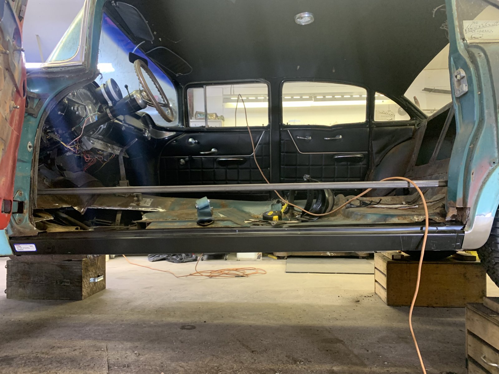

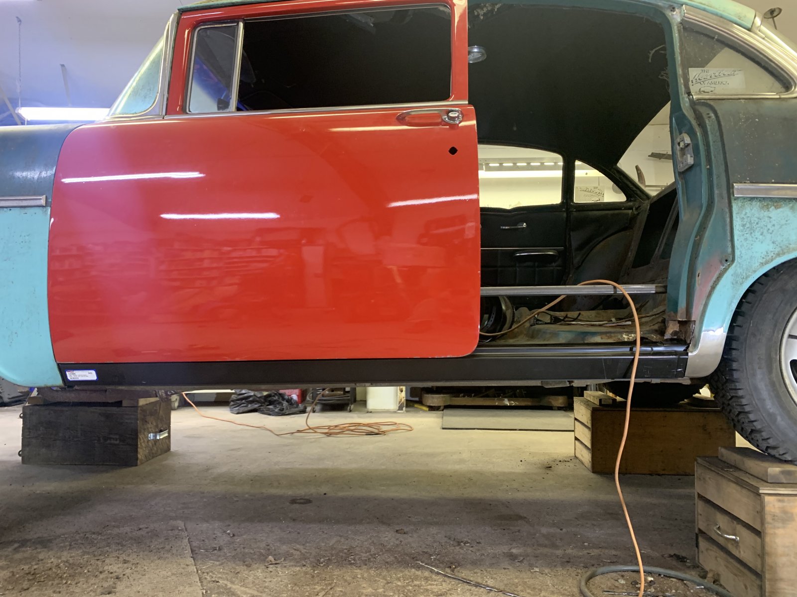

    Finally a day to get in the shop and make some further progress. Brought the young apprentice along and had him getting his hands dirty. Left the cutting to me just to be safe both with fingers and how much cutting to be done. Cut up the toe board a ways as well and will make a patch for that myself. Happy with the test fit so far of the new floor panel. The front portion of the old rocker fought me quite a bit getting it out so wish I would have been a little further along but still making headway.

    Keep moving forward. Got the rest of the old rocker finally ripped out and cut out the rest of the bad along the floor pan. Got the new rocker mocked up. Started making the couple patches needed as well. Need to carve out some time so I can get things pushing forward.

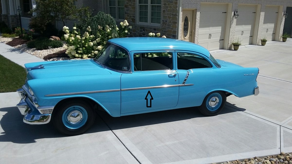

    anyone know if they make the 2 door 210 side trim for the door?
    chryslerfan55, Stogy and loudbang like this.
  20. Squablow
    Joined: Apr 26, 2005
    Posts: 18,498
    Squablow
    The car above is a 150, not a 210, although that door molding might be the same for both, not real sure about that.
  21. Johnny Gee
    Joined: Dec 3, 2009
    Posts: 14,352
    Johnny Gee
    from Downey, Ca
    Yes it's reproduced. Same door trim for either 150 or 210. It's Bel Air that is different. Not because there are two running parallel to one another. Bel Air trim is approx. 1/4" narrower.
