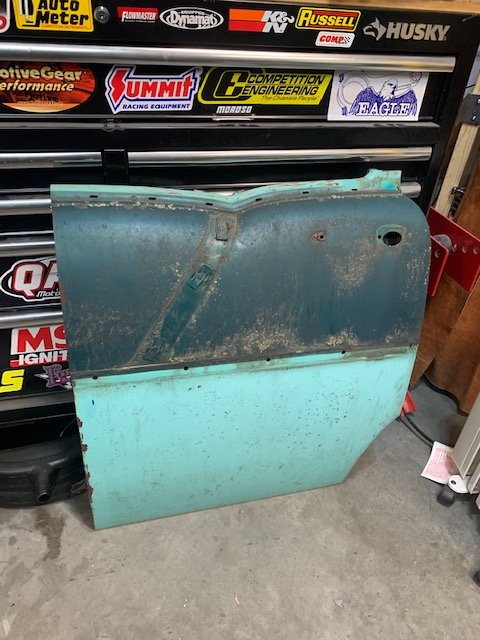

    Got the door all stripped and ready for the knife. Plan is to be at the shop on the car all weekend so will get the door cut and ready for test fitting. Will get the rocker all welded in then the B pillar and start making stuff happen. Work just always seems to get in the way of the fun stuff.. :D

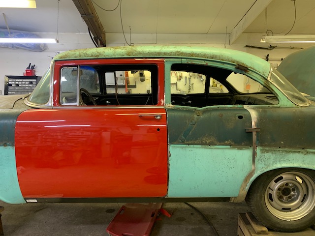

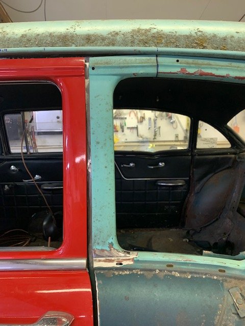

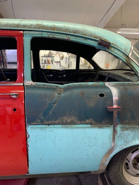

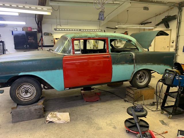

    Have everything fitted in place and ready to weld in. Will make that happen tomorrow and then get the B pillar tacked in. Got the door cut down this evening. Left it an inch long so I'll have some room to trim. I have a laser set up with a tri pod and I'll use that to make the final trim. Funny how I didn't chop my coupe and here I am cutting up my classic! But the goal will be to make it so no one will know the difference once I'm done. Scary cutting the door but exciting at the same time.

    Do you have 2 door 1/4 panel belt line mouldings and interior window garnish trim? They come in handy when setting rear door skin fore and aft so there will not be any surprises in the end.

    I have the garnish trim. As for the beltline moldings that's why I cut the door on the front post the way I did so i can cut in the contour of the 2 door door to match up. As for the rear part I'll have to fab up a little to get it to flow nice. We'll see how it all plays out.

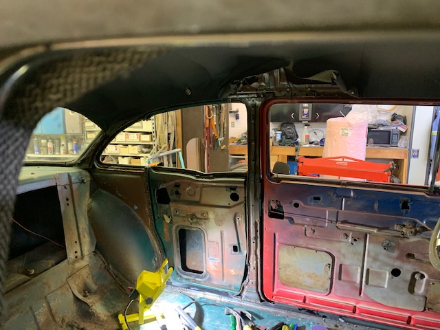

    Got the B pillar all welded in and door opens and closes. I removed the outer door edge off of the B pillar so I could move it back slightly and reattached leaving the door gap larger as I have to bring the door back slightly. Still have to massage it a little to follow the top profile of the door better but it's close. Tomorrow I'll weld in the door skin but definitely feeling accomplished for the day. At least I know the passenger side will go quicker as I have done all my learning on this side. Lots to do!
