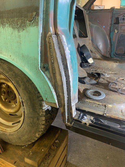

    Got the door fully welded in today as well as the upper door portion. Need to weld in a small filler strip along the bottom of the door as the gap was a little too wide to weld as is but otherwise she's officially a 2 door! One small patch to make and burn in on the floor and then I can cleanup a few remaining welds. Going to pull the motor and ****** next week, pull out the gas tank and then arrange to get her moved to my friends body shop. Now I'm starting to get excited! Has been somewhat cathartic working on the car after losing Dad in the fall. Had a few days where he's been on my mind a lot while working away. Sure he was lecturing me a few times on how I was doing things but that's what Dad's do! Miss him a lot.

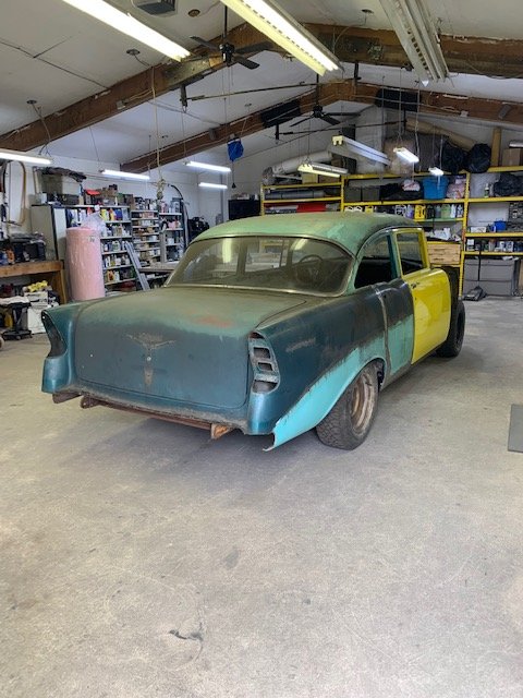

    My Miller has requested a holiday... :D 2 door conversion complete. At least the major fabrication. Floor panel replacement all done and got the inner rockers all welded in as well. I need a nap

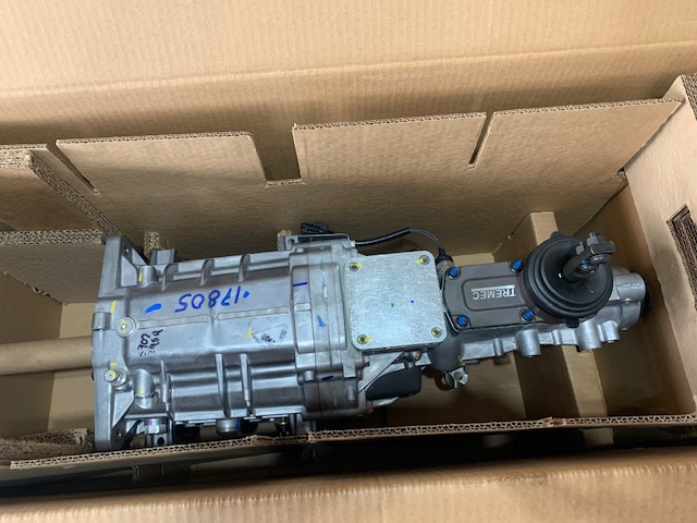

    Life's been busy otherwise so nothing new work wise on the car but Santa did bring me this present today! Tremec TKX goodness! Always like new toys

    It's the 0.68 5th gear model. 1st 2.87, 2nd 1.89, 3rd 1.28, 4th 1.00, 5th 0.68

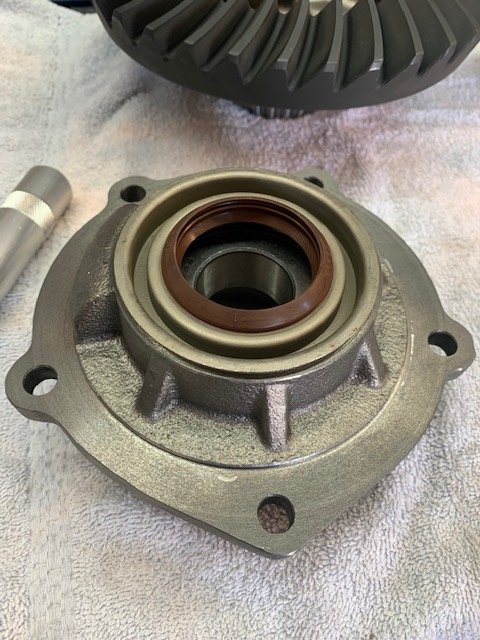

    Time for a little center section ***embly. Eaton true trac and 3.50 gears going in. I love doing this work on a build.
  30. Fitnessguy
    Joined: Sep 28, 2015
    Posts: 2,042
    Fitnessguy
    Got the majority of the centre section put together. Need to pick up an extra pinion yoke nut they I can ***emble to pinion carrier and set the preload. Then we'll get the rest of it ****oned up. Fabbed a simple spanner tool to adjust and tighten the carrier bearing adjusters.
