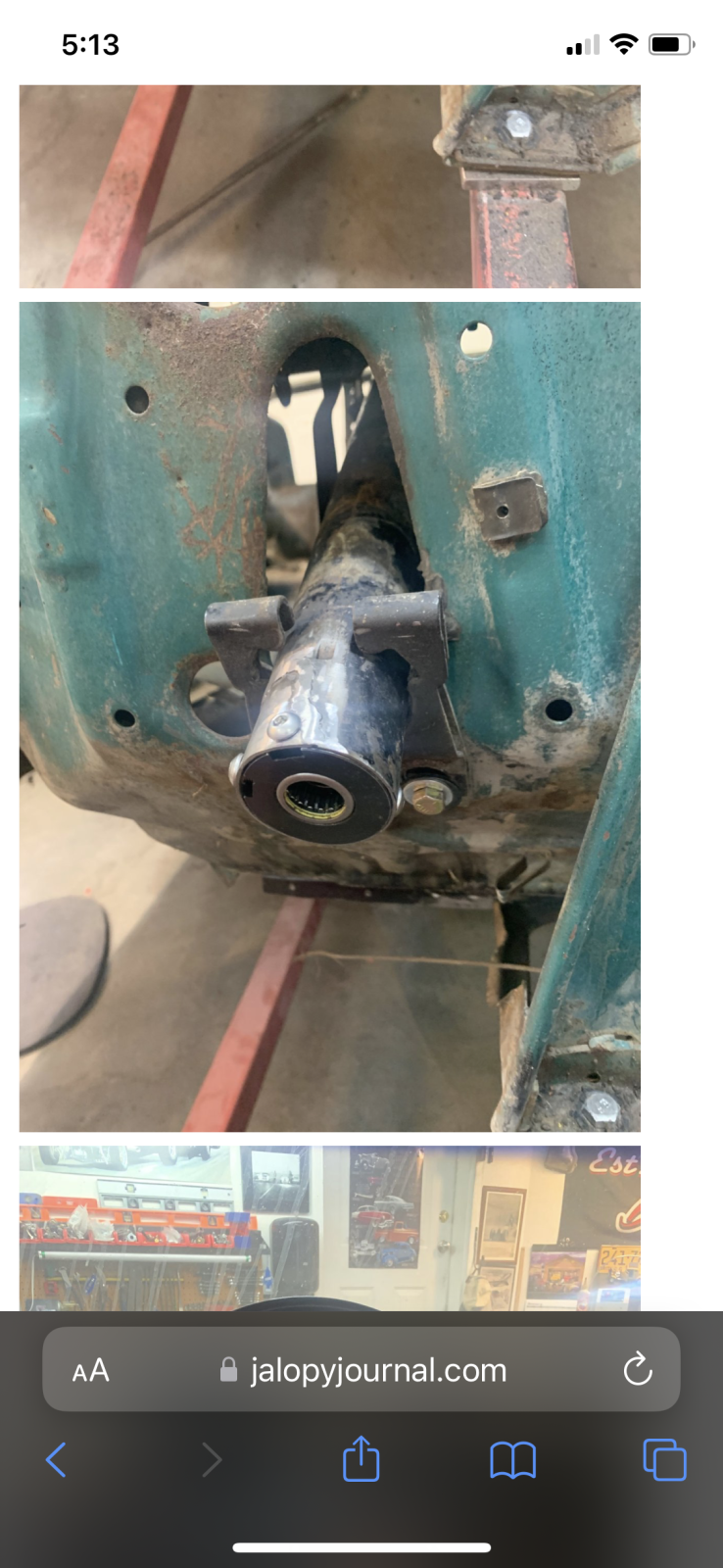

    Needed to take a break from sheet metal work so I decided to start tackling the steering column. I'm going to rebuild the original and I'm gonna be running the 150 wheel I am currently restoring. Pulled the inner tube out and filled in the bottom of the column where the shifter levers were located so I can run the unisteer bottom bearing. Want to leave some meat on the welds so it's nice and strong & safe being steering related. Just for fun I mocked up this 55 Pontiac wheel I have. Need to order a longer splined shaft than what I had on hand.

    Without the lower bearing then the 3/4" shaft would be sitting loose through the bottom of the column.
