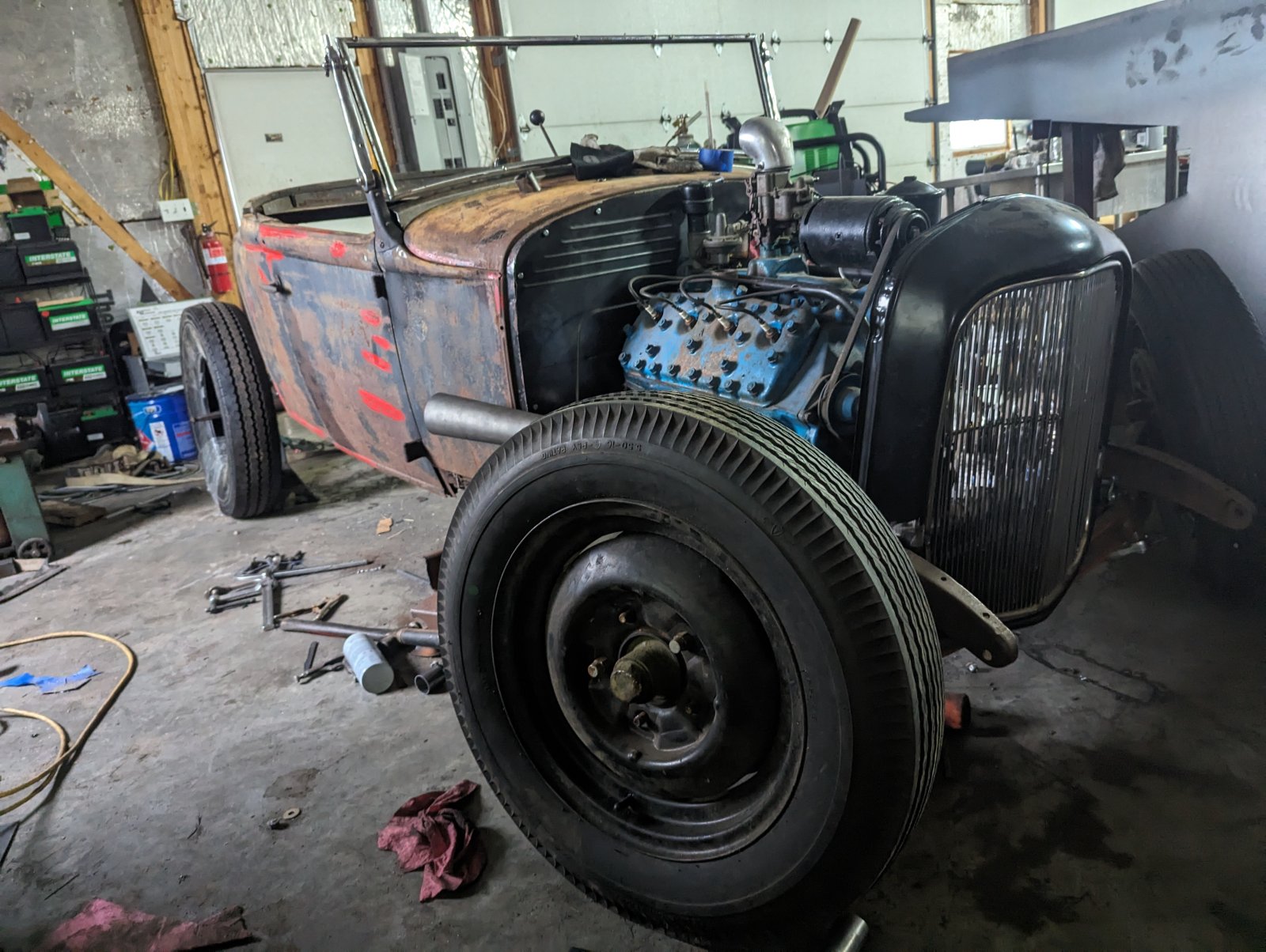

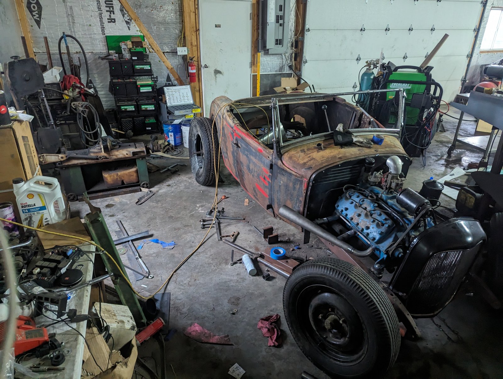

    The story of finding this thing is pretty good as well. I've been working on my 32 5 window for 3 years off and on, but ran into some frame issues, and let it stall. I was cruising marketplace and came upon an add for an all original 32 frame only an hour away, messaged the guy and set up a time to go look, and when I went. Man oh man, it was early Ford heaven, every model of model A, a 200 foot long shelf of original 28-34 parts. A pile of flatheads. The 32 frame is beautiful, all original, still has the factory rear bump stop rubber on the frame. While getting the tour and the guys story I mention once I get my 32 done, I'd like to do a 30/31 roadster. He mentions he has a body he'd sell as he'll never get to it with the list of projects he has. We strike a price, and I went back the next weekend and picked up the 32 frame, the roadster body, a "junk" A frame, A front crossmember, F1 box, 12 40 wheels of various widths. And an agreement that I'm coming back for some 39 transmissions, some flathead stuff, his stash of 40 rear ends. Etc...

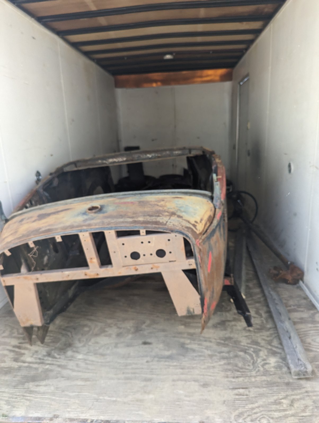

    The body is a sweetheart, very little pitting. It had been channeled deep at some point in it's life, subrails pretty well gone. While cruising marketplace in between seeing it for the first time and picking it up, I stumble on an ad for "roadster windshield" turned out to be a 31 roadster deluxe windshield frame. Went and grabbed it, and started throwing parts together between my parts stash and what I bought from him. I still have to go get the trans/flattie and 40 rear end which I'm doing this weekend.

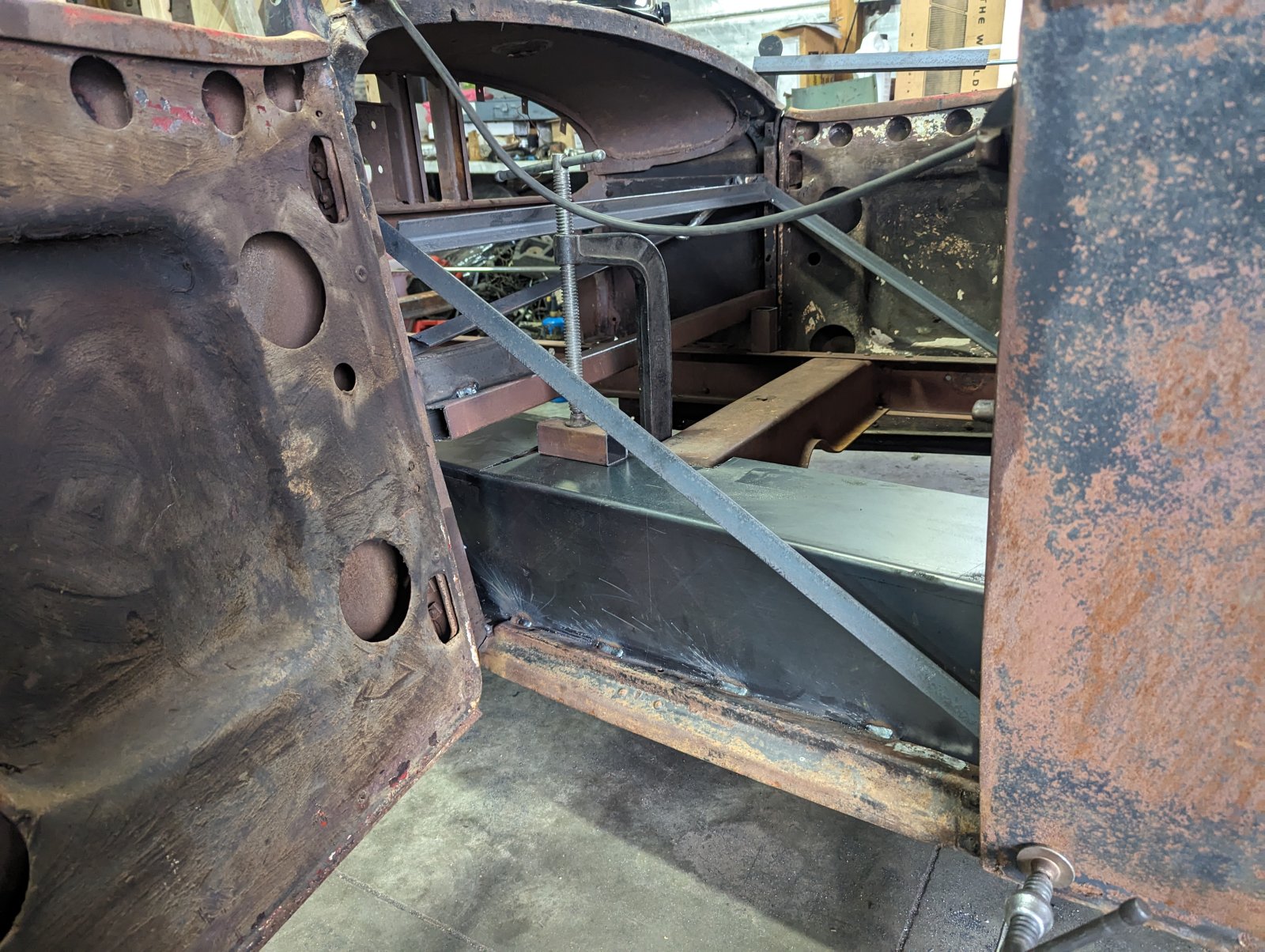

    So I'll let the pictures speak for themselves. I started out setting the "firewall" on the frame and went about using some turnbuckles to get the doors to where they would function, then started adding bracing. Brookville supplies the under deck lid panel, and rear body crossmember. Then I started making my new subrails by breaking 1/8" steel into a 8x8 90° and pie cutting to fit the body.

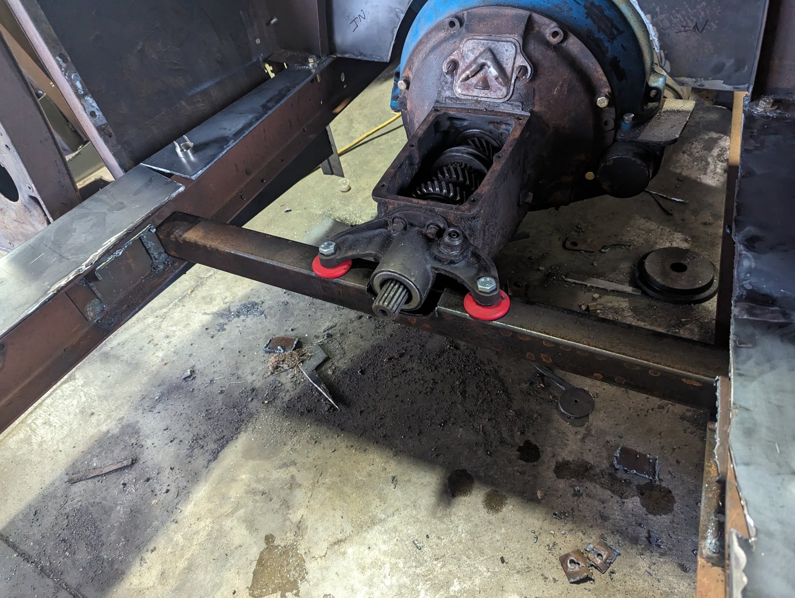

    It was set up for swing pedals, which I happened to get a set of genuine ansens with my 32 score years ago. I cut out the super thin mount they used and put in some 1/8" along with a IH master cylinder I had left over from last years 64 IH pickup I did for the same car show.
    Then I started laying in floor crossmember/body mount out of 1" c channel, which will be split and a piece of pipe put in the middle for driveline clearance.
    I set the rear most c channel even with lip in the back of interior so I can make a bulkhead between the trunk/cab.
    Ordered a set of ultra shield bomber seats (my one splurge in this project)

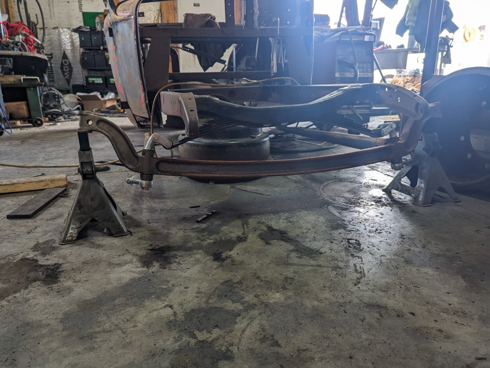

    Front end is a speedway drop axle/split bone kit id acquired a long time ago. I robbed a 40ish axle I had out back of the spindles and hubs and slapped them on, a long with a set of used 5.50s the gentleman sold me with the car, that I of course mounted on a set of 40 wheels.
    Ordered one of the cheapo eBay 32 grills as I knew I was going to have to cut 8" or so out of it, and saw no need to chop up an expensive one. Ended up cutting out 8.75" from the shell, 3" channel, 5.75" section and modified the insert to fit as well. I'd already ordered a aluminum Civic radiator, once again guesstimating how much room id have, which worked out perfect, I'll just have to weld on some new inlet/outlets for the flatty.
    That pretty well gets us up to speed over the last week and a half I've had it. Almost, but not quite at a standstill into I go get the motor/trans/rear end

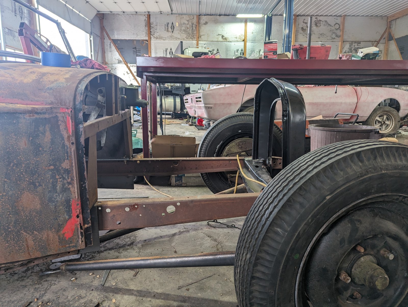

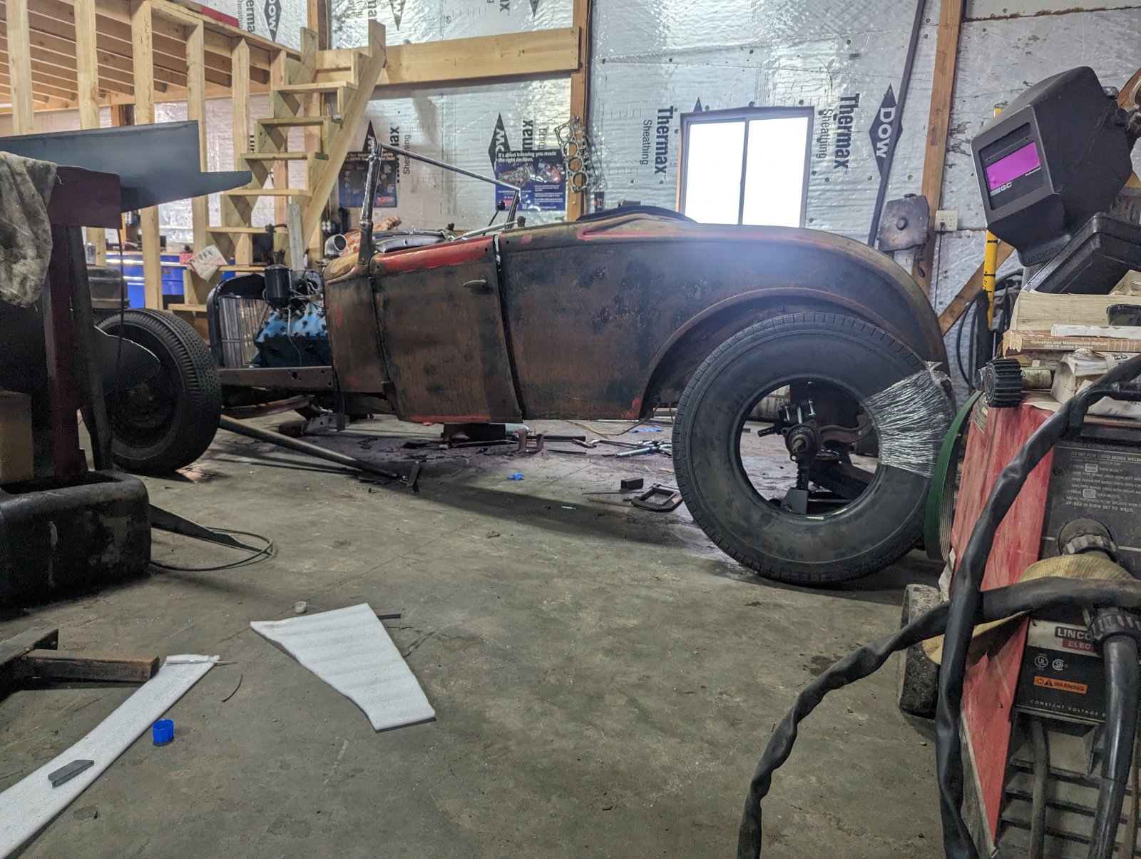

    I can agree with that, and I'm not above bringing it back up correctly down the road. But for now and my time constraints, I'm putting it back similarly to how it was/what they were doing. Luckily they didn't cut much out to where it can be brought back without a ton of issues in the future.
    I've been struggling, because I don't want this to be thought of as a rat rod, and unchanneling it would probably help with that. But at least for this 4th of July show, channeled it is, a long with all the issues I'm learning a deeply channeled car brings

    PXL_20240527_190253103.jpg PXL_20240527_200120098.jpg Not much progress today, cut out all the bracing and started mocking up floors and firewall.

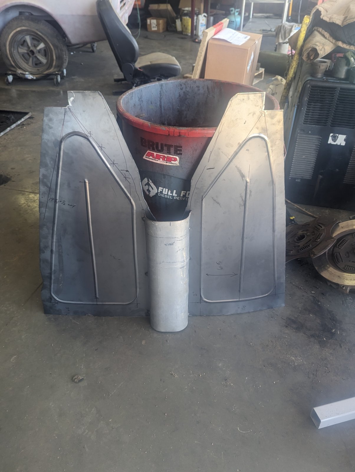

    PXL_20240529_235640855.jpg PXL_20240530_004920081.MP.jpg Started out on the trans tunnel. Took a piece of 4" exhaust tubing and sliced it, opened it up a little bit and hammer and dollied until I was happy, tacked it in square and started hand forming the tunnel. After a few hours, I got it close and needed to quit, before I started welding before it was 100%. Decided to go ahead and bead roll the floor pan, halfway through the first roll (maybe the tenth total on this Woodward Fab unit) and it quit rolling, something isn't square in the gear box area, so waiting to hear back on what they want me to do as the love joy coupler won't Even go back together. So then decided I should start on the trans mount. Took an old Chevy leaf spring bushing I had and sliced it in half, took a piece of 2" square tubing and notched it for trans, and marked the holes for the bushings, roughed them in with the plasma and set the trans down on its own weight. Didn't get anything finished like I have been every night, but it's progress. Rear spring hangers should be here tomorrow, so hoping to get a axle under the back and figure out how much I need to Z the frame to get the stance I'm after.

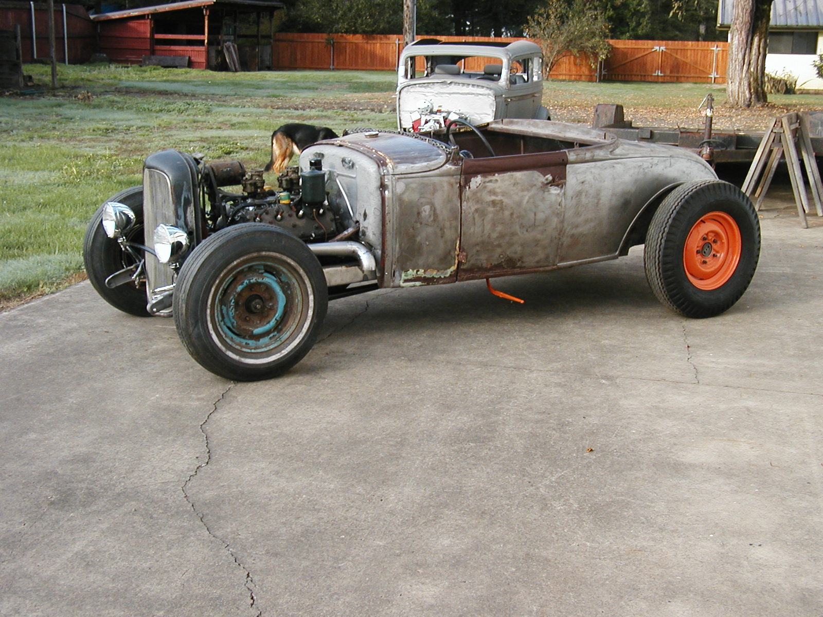

    Also I've been trying to figure out why they'd cut 6ish inches out of the bottom of the cowl. After seeing this photo, I think they were trying to make room for split bones. I may not get it done before the show, but I think this is how I'll finish it the bottom of the cowl to make it look a little cleaner Screenshot_20240527-191007.png
    Thor1, hfh, Outback and 1 other person like this.

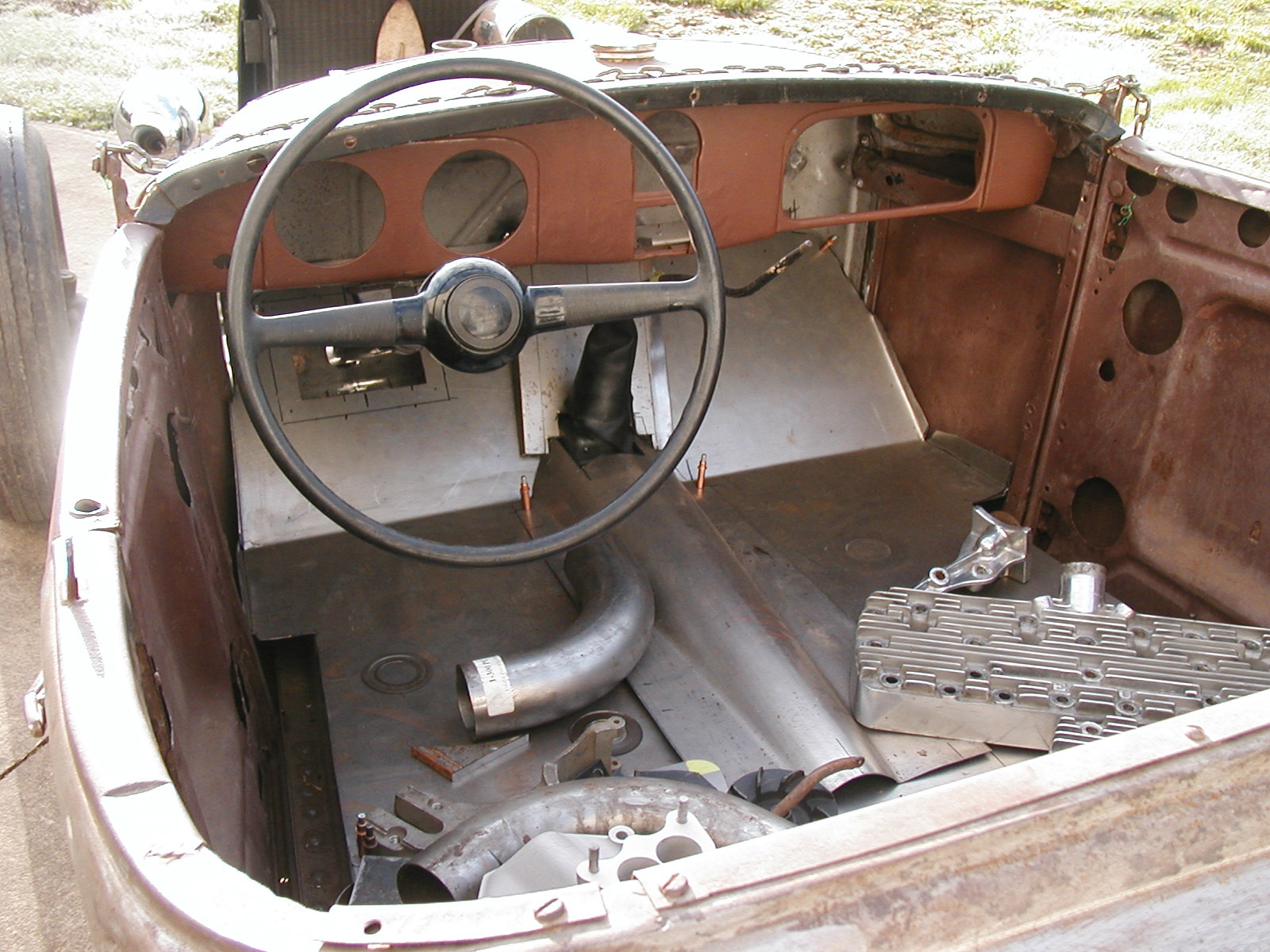

  20. Yeah I say keep it channelled. As many vintage pics I've seen of channelled model as unchannelled says rat rod to me if anything lol. Best way to TRY to avoid rat rod stigma is avoid the urge to preserve "patina" and like you said era correct parts exclusively.
    Also considering a channelled 30/31 roadster is on my top five list of rods to own and build I'm a lil jealous ;)
  21. And they could have cut out the cowl bottoms over rust. I've seen model as where that area was the only rust through.
    Outback likes this.
  22. Binderman01
    Joined: Dec 31, 2018
    Posts: 102
    Binderman01
    Yeah that thought has crossed my mind as well, just heard to Believe those would be rusted on this body, but agreeing is possible. The story I got was the body had sat since the 60s/70s so who knows. Either way, that lower cowl section is definitely going to interfere with the wishbones, so I won't feel to bad about hand making those pieces and doing some little scoops or something to church it up a little.

  27. Stock Ford buggy springs front and back. 3" of space front and back between Axles making contact with bottom of frame rails. Notice the fixed spacers on all 4 corners while building the ch***is. Then I used stock 32 Ford rear bump stops and lose 1/2" so travel is 2.5" of compression. Being it's still under construction I'm not sure how many leaves it will take to set it there and have a good ride but quite sure it won't be a full stack according to stock on either end.
  28. I'll add that my plan for a final job s to be full fendered with running boards sitting on stock iron mounts. That's the reason for the Orange one hanging out there, it's Orange so I don't trip over it. (doesn't work).
    NoSurf, orbitup and Outback like this.
  29. Wait.... channelled and full fendered? I definitely approve. Always loved that look
