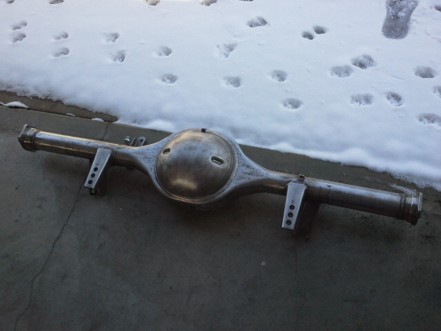

    Big web housings are strongest, top pic^[​IMG]
    This one is the small web housing^.
    When I bought my 9'' Ford truck rear, it seemed like a smokin' deal.
    $50 drum to drum. Well, the center section was a small bearing open diff. The 31 spline axles were too long. Guy who narrowed the housing said axles were only hardened at the ends and shorten/resplining would be risky. So all I used was the big web housing.

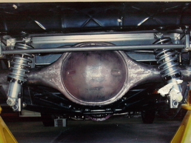

  12. chevy57dude
    Joined: Dec 10, 2007
    Posts: 9,709
    chevy57dude
    Big web shown here.
    Just Gary likes this.

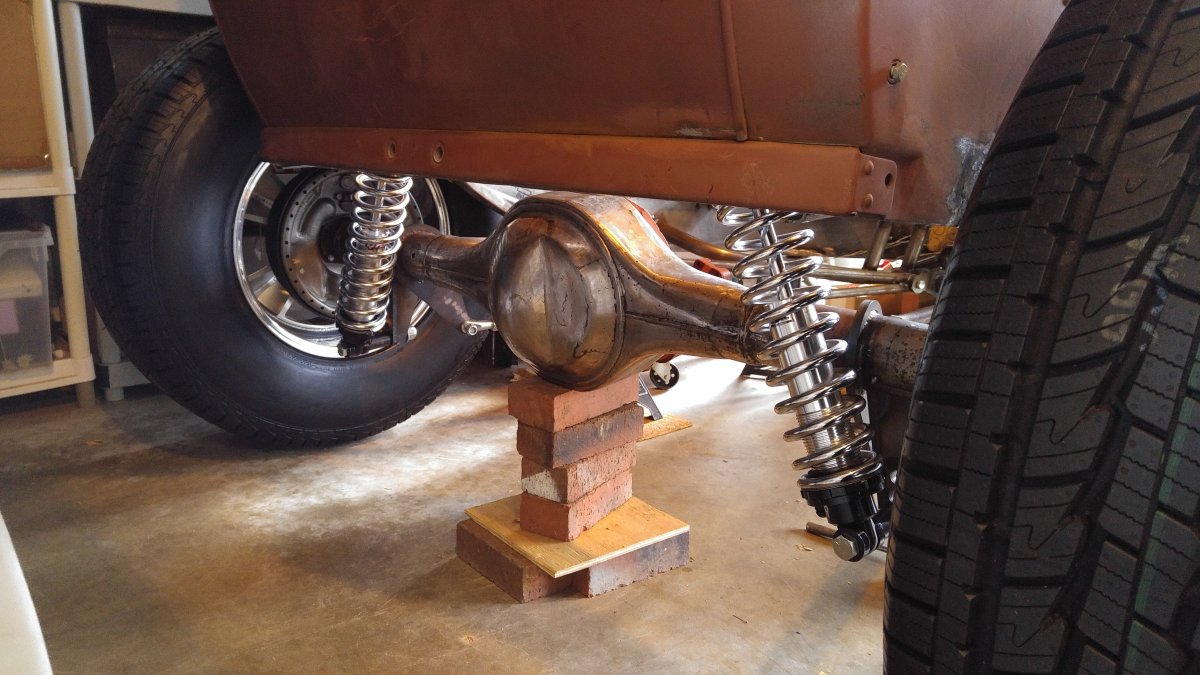

  13. seb fontana
    Joined: Sep 1, 2005
    Posts: 9,214
    seb fontana
    from ct
    LM14 likes this.

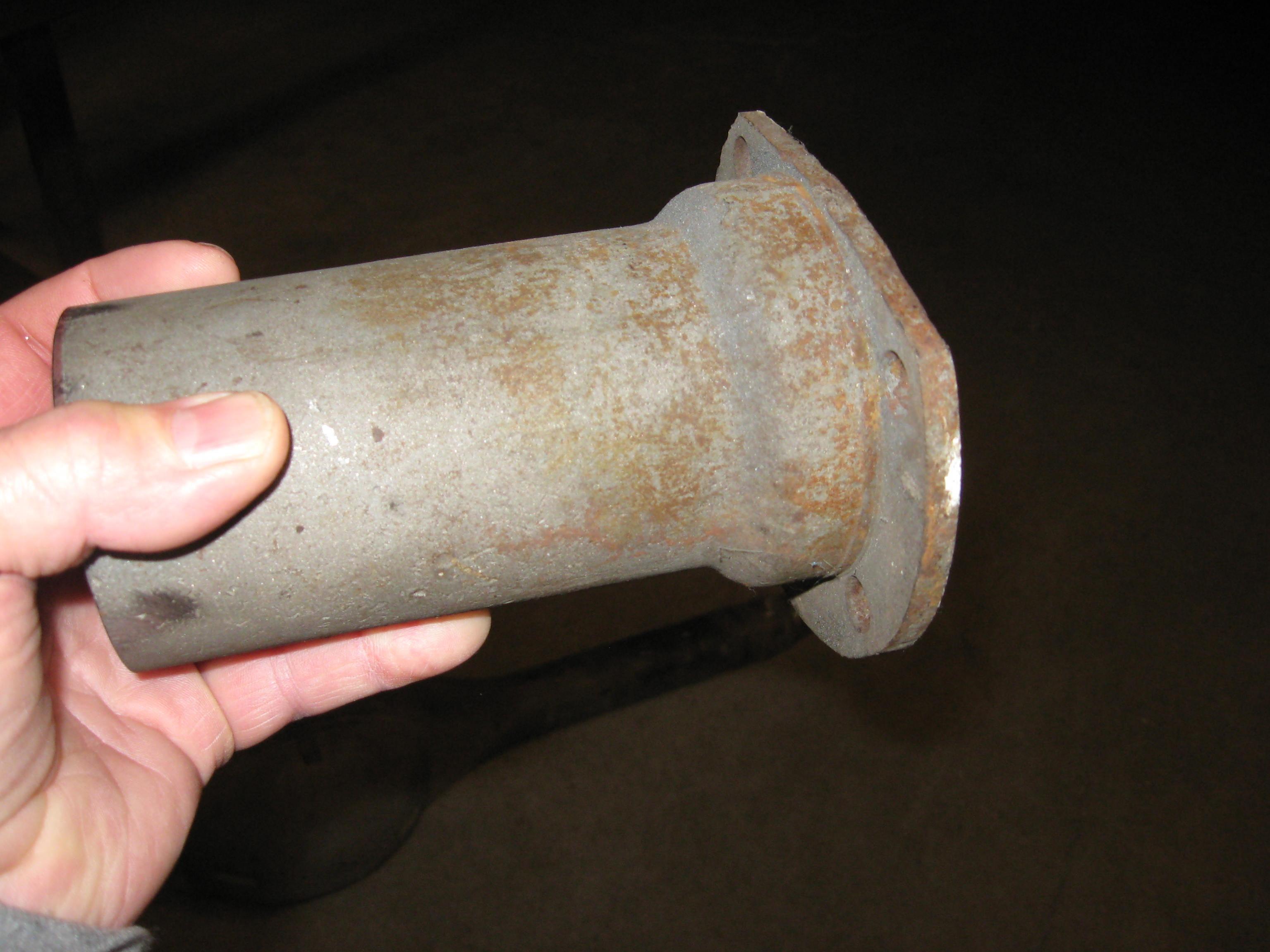

  27. DDDenny
    Posts: 22,547
    Another oddity about the 57 F100 housing, bearing ends are integral, not welded.
    Photo courtesy of Marty Strode.
    bchctybob likes this.

    Um' that rear goes with the 37' + tube front axle..!
