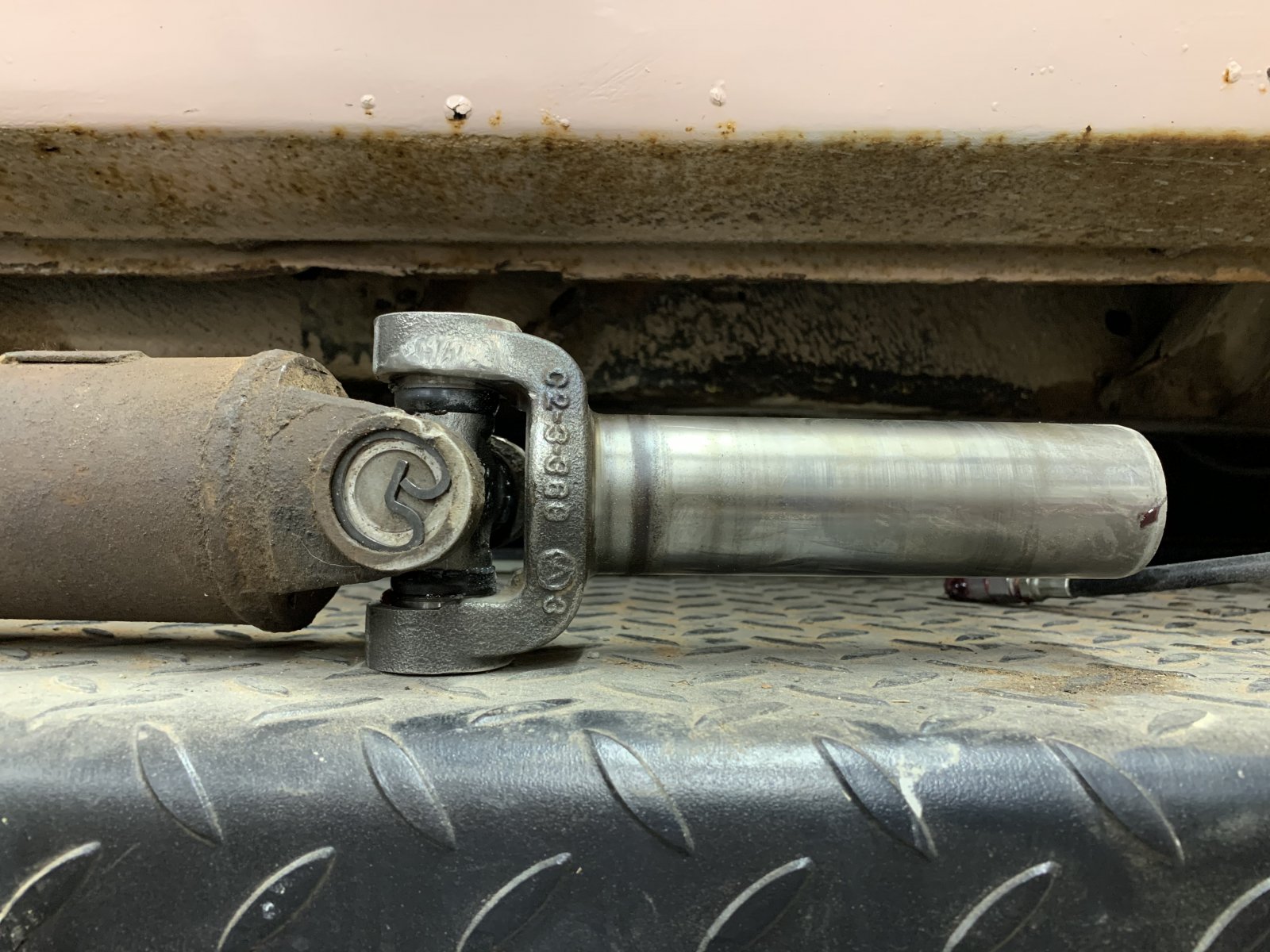

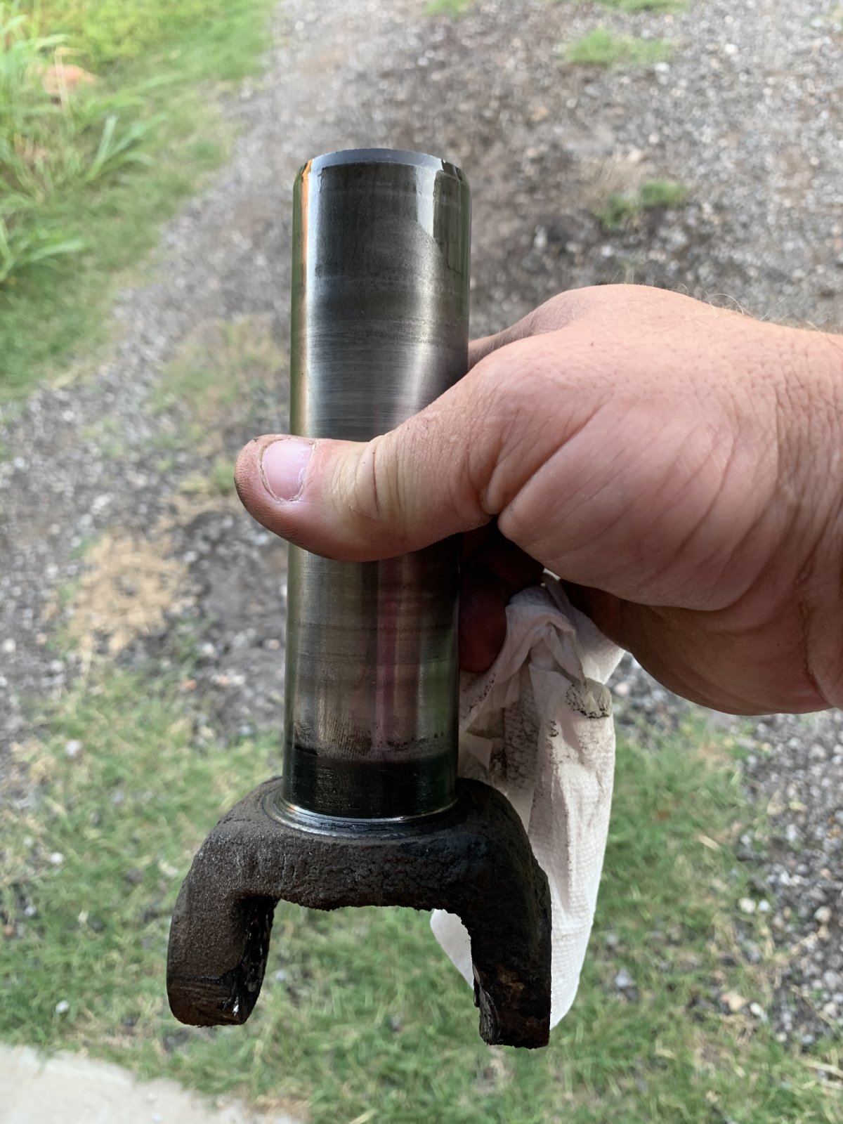

    Well, the adventure continues. Seems we didn’t do a very good job of checking over the u-joints a couple weeks ago. :eek: They both felt tight, but the front one came apart today on the way to vo-tech. Just thankful that didn’t happen over the weekend or cause any real damage when it happened. It did mess up the slip yoke, so we are now looking for one of those. Anyway, seems new u-joints, rear transmission seal, rear shocks, a pinion seal, and new spring bushings (while we are at it) will be fixed soon.
    Silas is leaving for a Colorado Springs for a camp Saturday, so we have a couple weeks before he needs the car again. We will get there one of these days.

    Sometimes, even before you can see or feel any real slop in the joints, you'll get a visual warning in the form of a rusty, red deposit around the u-joint bearing caps. It's the un-lubricated needle bearings "leaking" out.
    :rolleyes:

    Yep, I should have noticed the leaking rust. I suspect the signs were there and I just missed them. :oops:

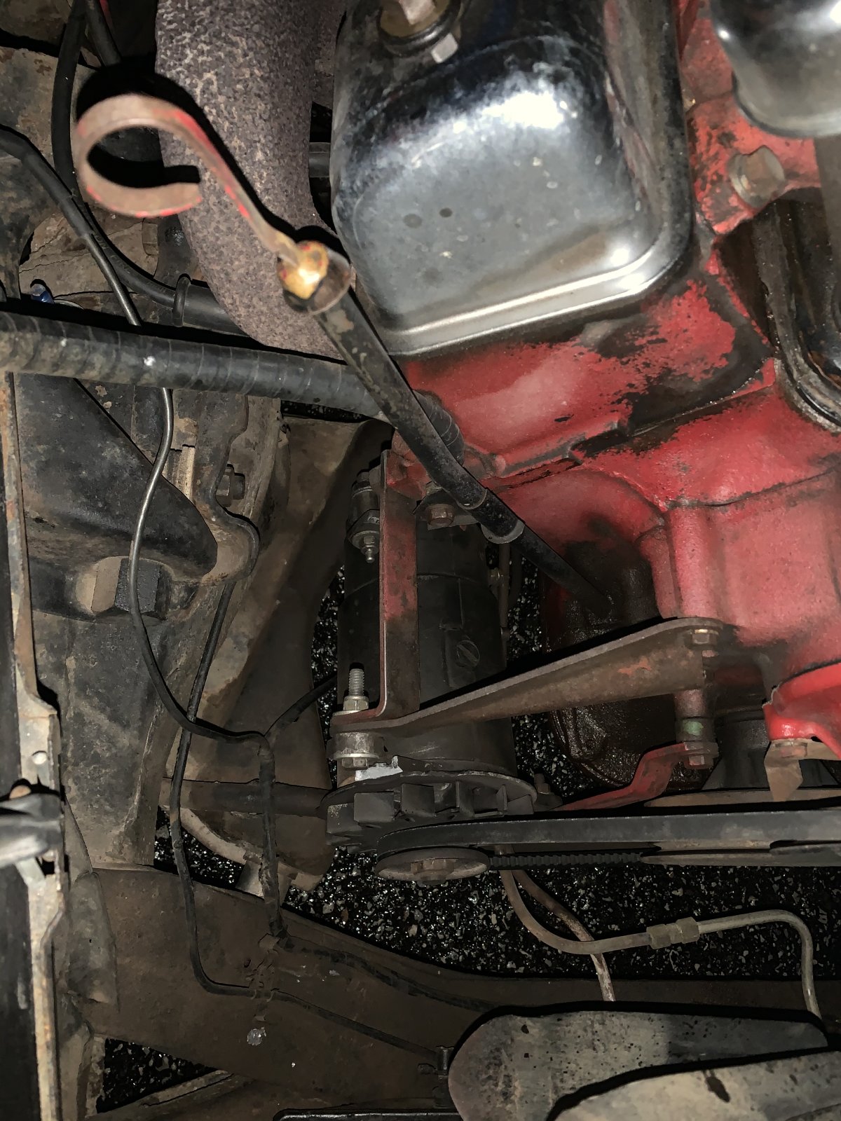

    Well...the adventure never ends. I got everything ****oned back up last night, so decided to drive it to work today to see how it did before Silas gets back from camp this weekend. And, it did great right up until the water temperature started climbing. I pulled over and popped the hood to find that the generator bracket failed which then failed the ear on the generator. So, seems the list never really gets shorter... Enjoying a cool morning watching traffic go by while I wait on folks that go into work later than me to give me a ride in. At least my boss is a car guy and gets it. :D
