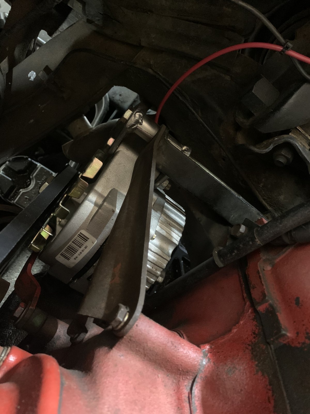

    Got the generator swapped. Pretty sure this thing had a GM generator on it before which explains the spacer on the bracket and likely why we kept breaking the bracket. Anyway, the one I put on is supposedly rebuilt, but has been sitting forever. It doesn’t appear to be charging, so I may need to polarize it? I have run multiple generators, but have never had to do that before. Yea, I know...this is something I should have already known how to do.

    Hmm...that didn’t work. I did it just like everyone seemed to agree on for a Ford generator. I pulled the field wire at the regulator and touched it to the battery wire for a second until is sparked. Didn’t seem to change anything. I figure we can mess with it more tomorrow. Too late to think about it too much tonight. Not sure if something is wired wrong or if the generator isn’t working. I do have another generator that is on my 57 312. I suppose I could try that one. We need to dig in more...tomorrow. Have I mentioned how much I hate tracking down electrical problems? :eek:

  24. Rebuilt generators used to come with a tag with polarization instructions. On an old one of unknown origin, good luck. Can you get one rebuilt so you have more confidence in it?

    Finally gave in and swapped to an alternator. It’s now charging, so we should be good to celebrate Silas’s 18th birthday going to a cruise tonight about an hour away. More pics later.
