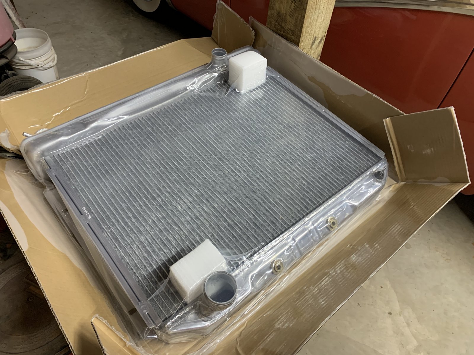

    Radiator at least appears to be good quality. Will see if it fits well and cools better tomorrow since it will be 102 or so... Flushed the system with vinegar and distilled water this evening and am letting it sit before we dump it tomorrow.

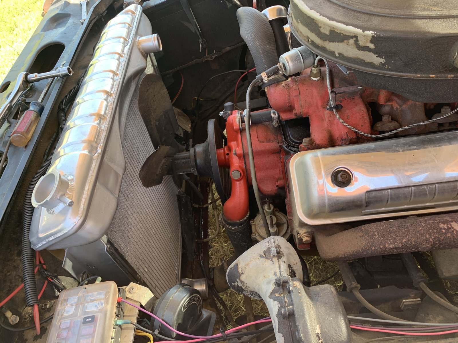

    Flushed it out this morning with distilled water and pulled the old radiator out. Did some comparison and appears to be an exact bolt in! Anyway, almost back in now.

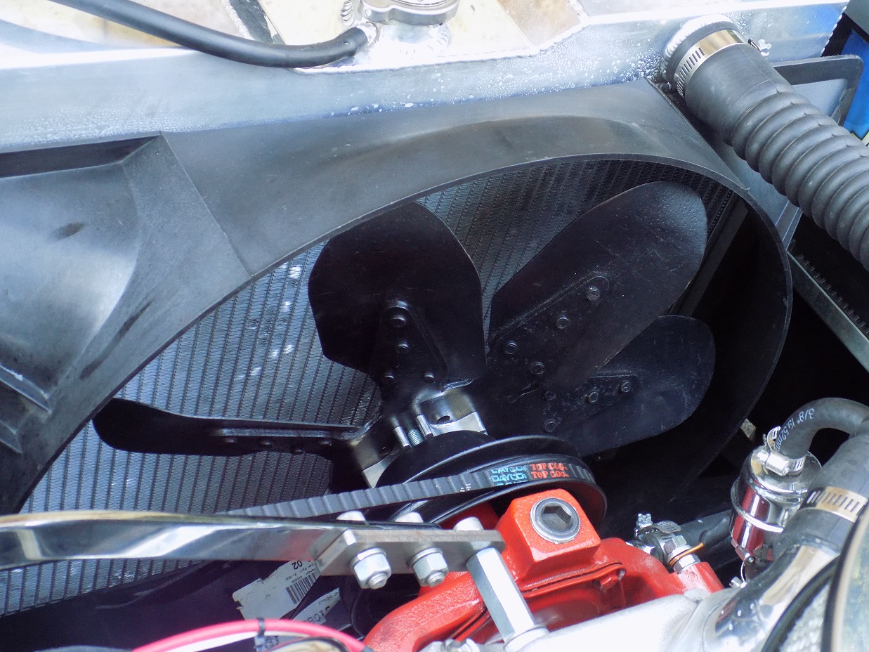

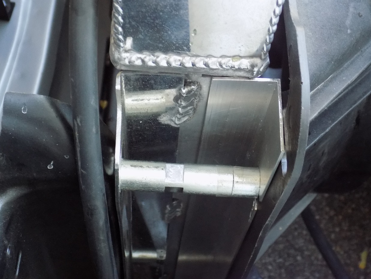

    You'll see how it goes. We used to make shrouds from chimney flashing for the stock cars. If it got crunched, it wouldn't take out the Caddy radiator. I have one in my Ford from Summit, meant for a Chevelle. It took a lot of work to get it in place.

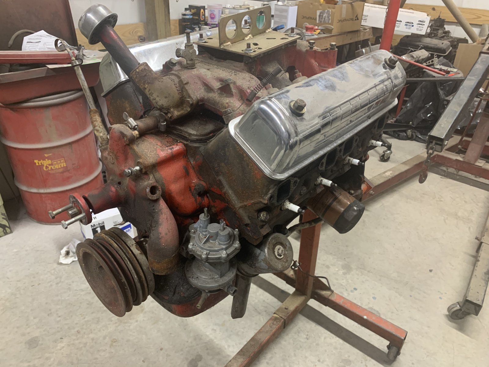

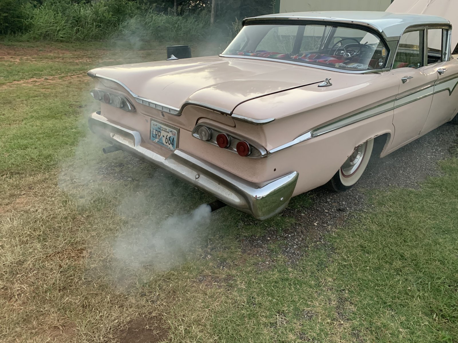

    Well...next on the list was to try to figure out the smoke screen problem. We tried to put new valve seals in last night on the p***enger side where the smoke was and everything appeared reasonable until the back cylinder. Couldn’t even really hold the valves up with compressed air to remove the keepers. And, the plug was completely oil fouled. Guessing we have broken rings or something. :( Looks like we will be swapping motors soon to the 312 I have sitting in the shop. That wasn’t my plan for that motor, but rebuilding this one would cost quite a bit and have the car apart for too long. More to come...

    I hear FE's pretty much install themselves in Fords of that era. Mileage shouldn't really be any worse, but it would provide a huge improvement in torque to get that beast rolling. Just a thought!

    Sounds like a good idea other than I don’t have an FE laying around. :D We discussed swapping to something besides another y-block, but I happen to have this 312 that is supposed to be a good runner just sitting in the shop. So, it will be the cheapest and easiest to deal with as best I can figure. :)
    Oh, and this car actually gets around 17 mpg with the 292, so not too terrible surprisingly.

    I havnt tried it yet. But my older buddy said it works sometimes. The 20 minute overhaul.
    Use an
    Old oil can. About 1/3 trans oil. Two table s****s of Bon ami and add a cup hot water. Hold engine at about 2000rpm and pour down the carb VERY slowly stop and stirring mixturE as you pour……WillSmoke like hell… but will clear up….if it works
    Might be worth a try, I could see it working if your fighting some stuck rings.
    firstinsteele, Thor1 and guthriesmith like this.

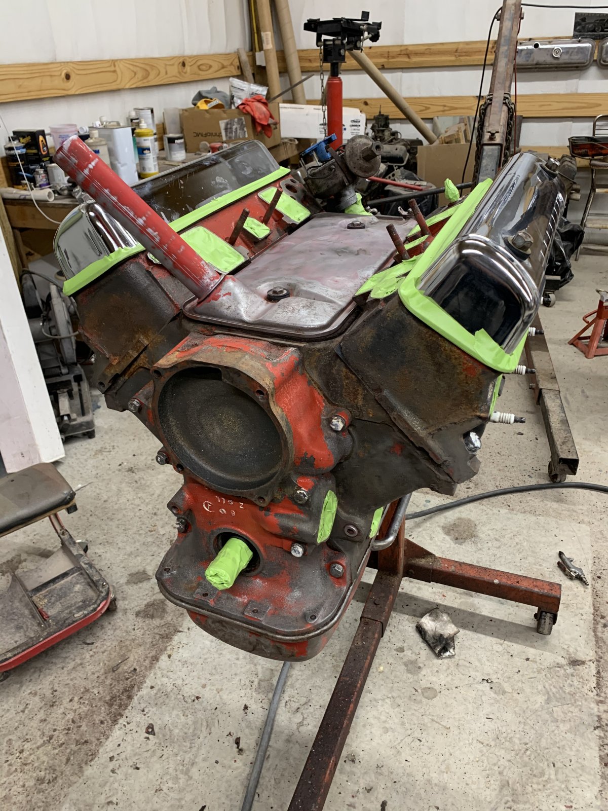

    Pulled the transmission and all the accessories off the 312 so we can start getting it cleaned up and ready to put in. Also ordered some new motor mounts and need to order a gasket kit as well. Slow progress... :)

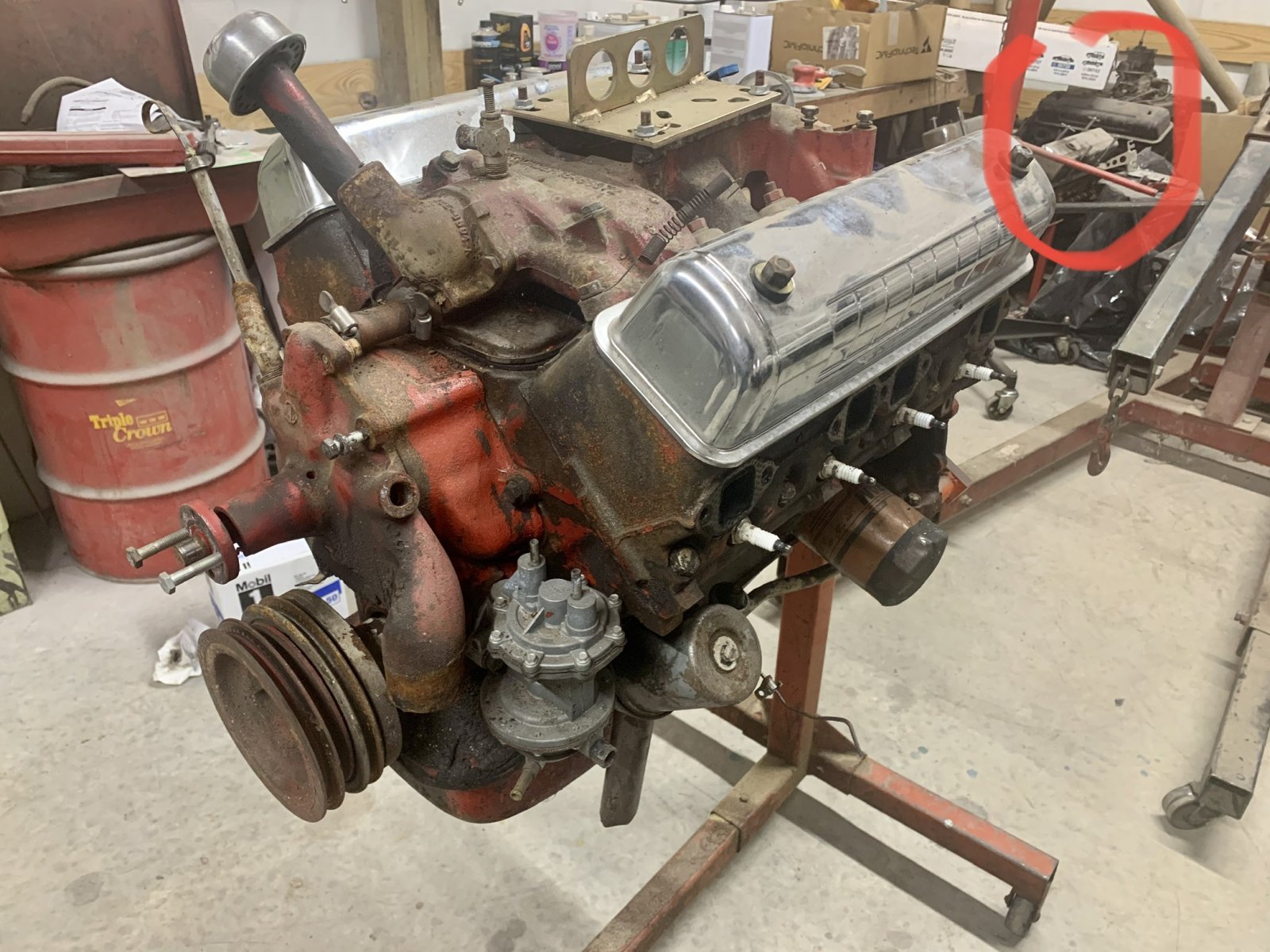

    And, for anyone wondering why we are using the 312 that was slated for my 56 in the Edsel, you can see the 56 312 that will now get freshened up for my car circled in the pic back by the wall. :cool: I will actually end up with a correct year 312 now for Ruth.

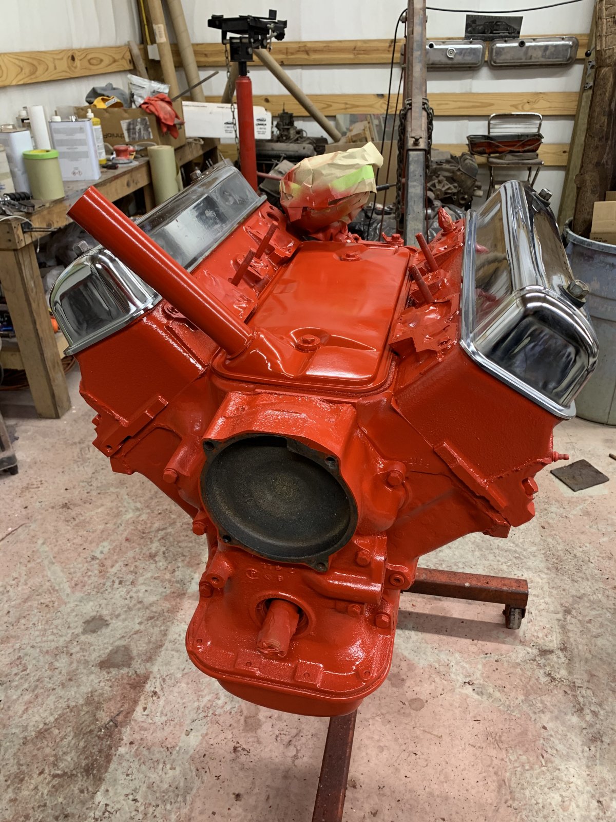

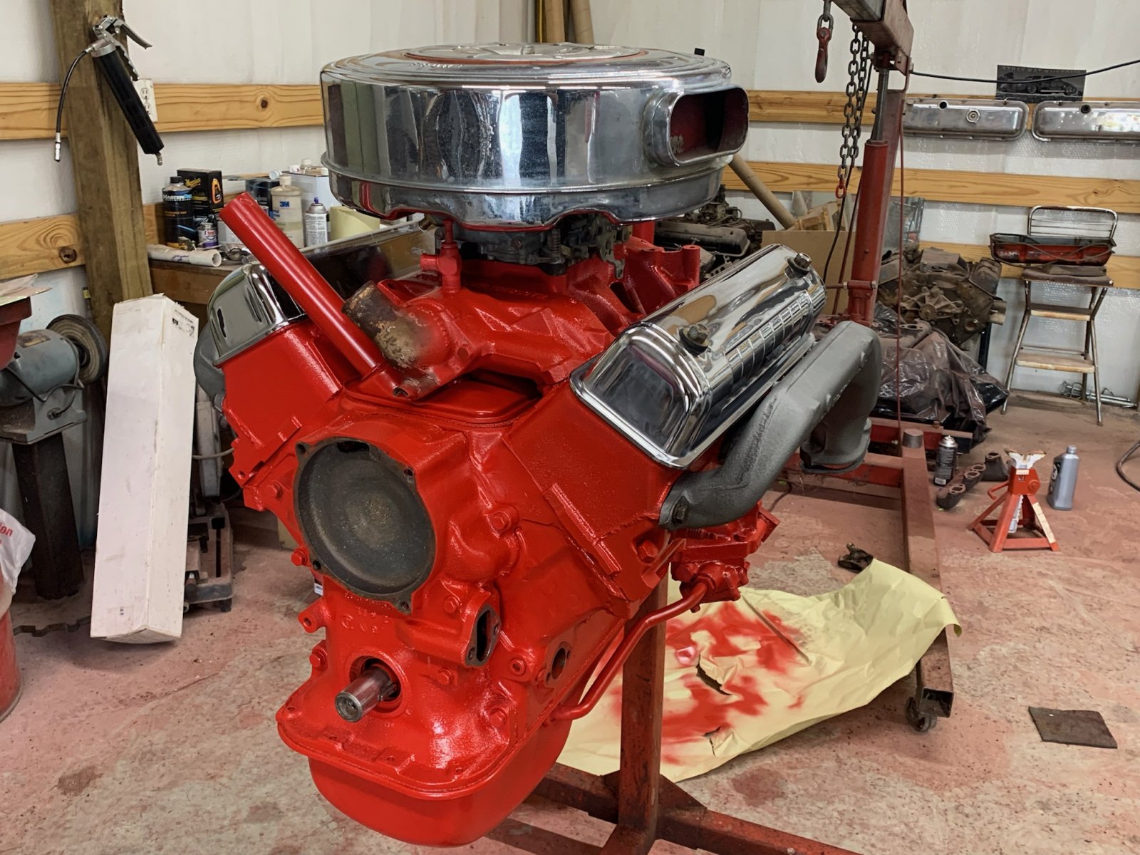

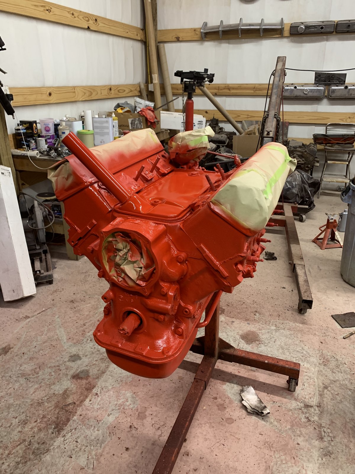

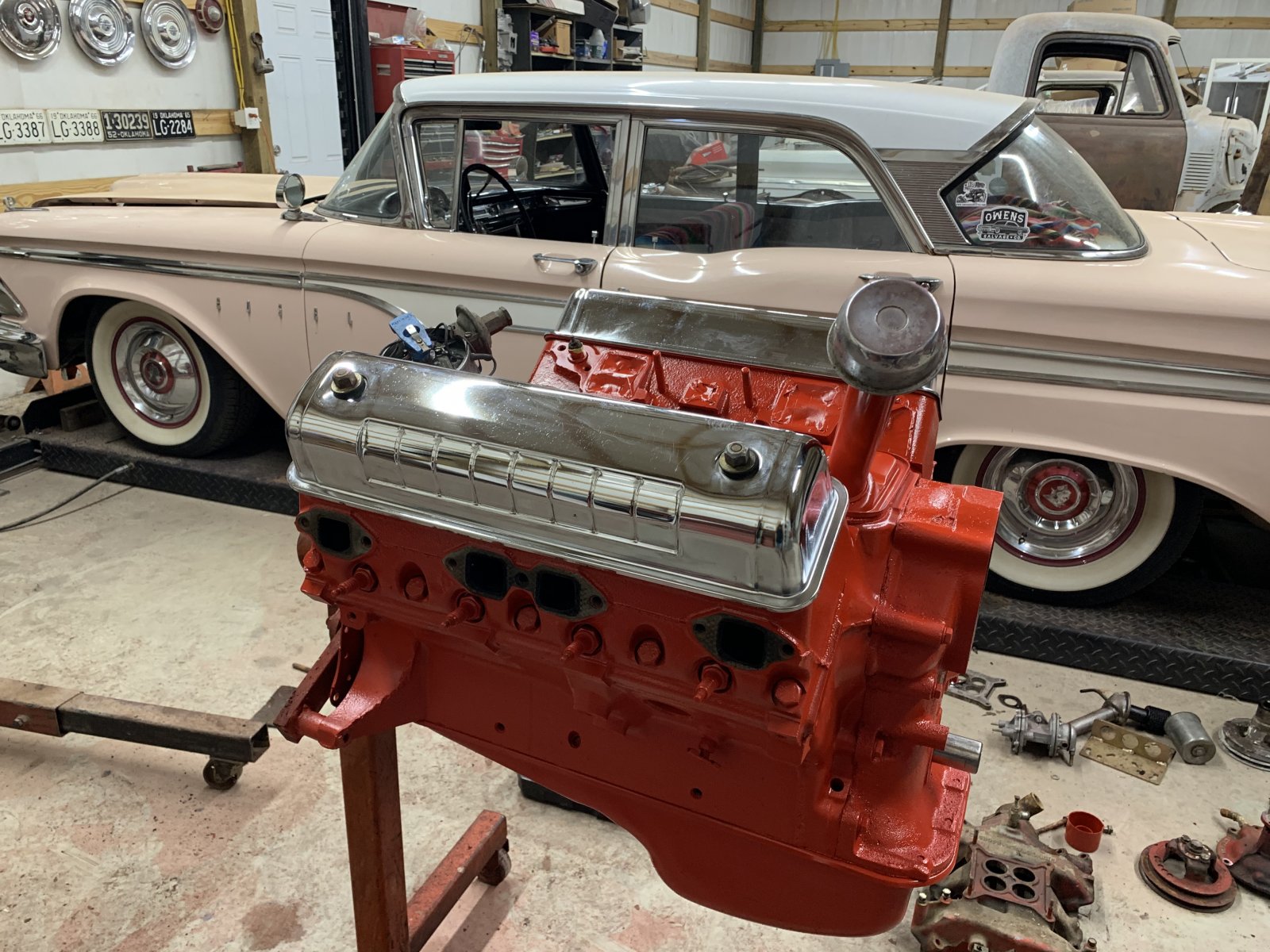

    Rebuilt! Well...new paint anyway... It does appear this motor is pretty fresh. Plugs looked great and someone spent the time to detail lots of stuff like painting bolt heads, and even highlighting all the casting numbers white on the red motor. Taking somewhat of a gamble, but mainly just cleaning it up to stuff it in. More tomorrow hopefully. :D
