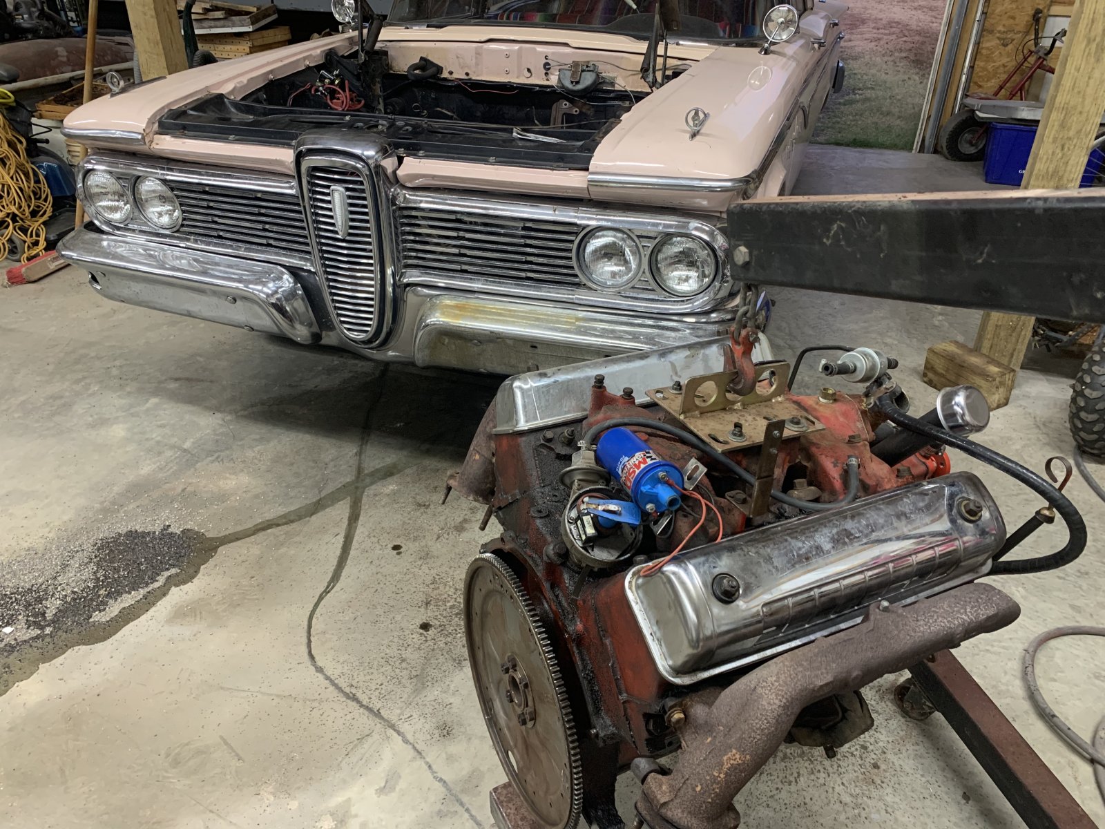

    Yep, pacing is what we did too. The 292 is still in the car although mostly unhooked. We spent Sunday afternoon cleaning up hardware, bolting the intake on, and getting the engine ready to pull. Pretty sure we have everything loose on the top side, just need to unhook everything underneath and pull it out.
    I did learn something Sunday. We went to put the intake on and one of the gaskets wouldn't line up right with the intake ports when it went over the studs in the head. I could have sworn that the gaskets were the same side to side, but apparently there is a left and right on a y-block? I have changed intakes twice on my 292 and sure didn't remember that. Anyway, I ran over to Sid's house and dug through gaskets and found a "set" and when I stacked them on top of each other, the ports were shifted over about 1/4" or so side to side. Apparently I just didn't remember this or got lucky when I put gaskets on my engine a couple times.

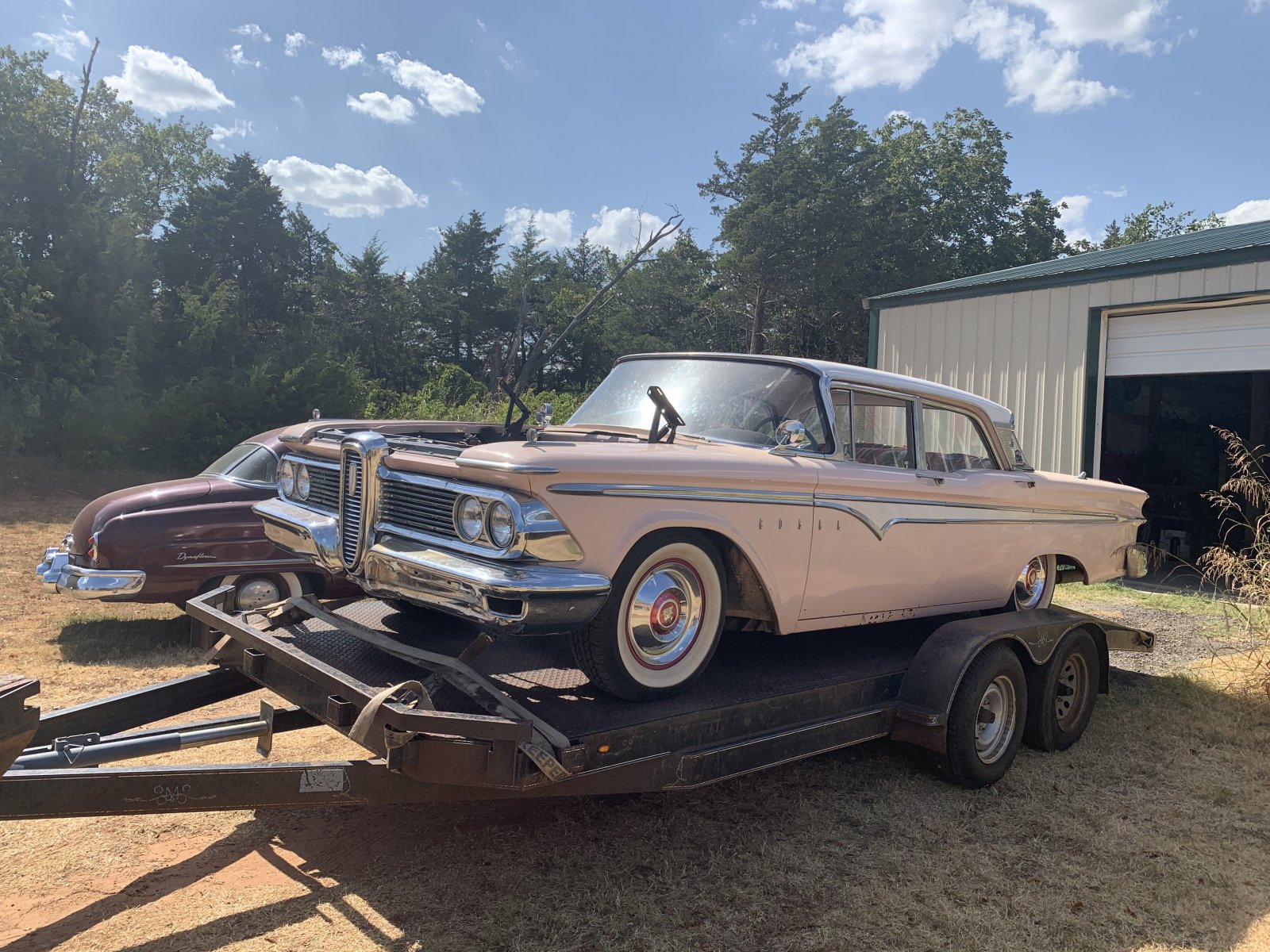

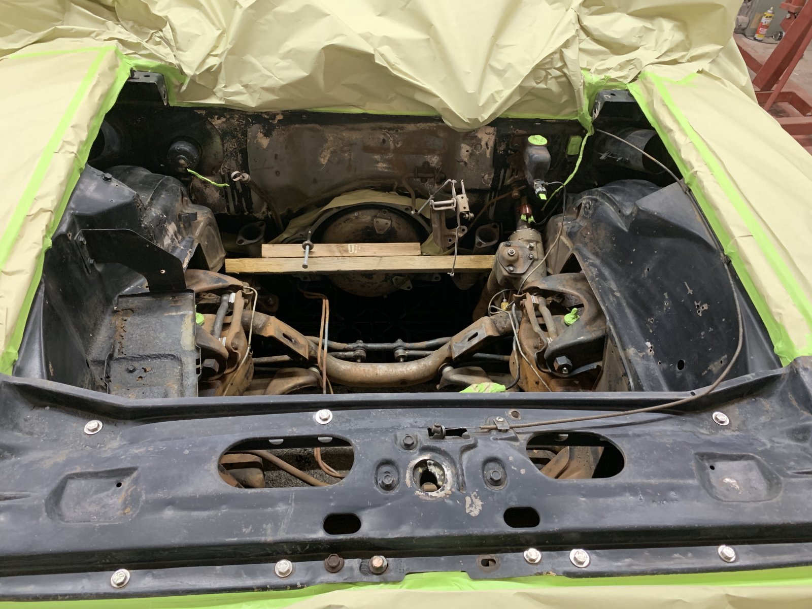

    Little more progress today a****st other work needed on other stuff. Loaded it up and took it to the car wash to try to clean up the engine bay some.

    I pressure washed my bay using Simple Green. Then hit it with a wire wheel followed by VHT paint. Probably blew a day with that task. But worth it.

    I actually reverted back to Easy Off Heavy Duty oven cleaner on this one. I figured it didn’t work as good as it did 30 years ago the last time I had used it. Seems most chemicals have been modified to be so safe to the point they don’t even work anymore. Anyway, seems it still works well and even still takes paint off. We may spray it all down a second time then do like you did. After having grease all the way to our armpits pulling the motor, some time cleaning up should make it nicer to work on going forward. :D

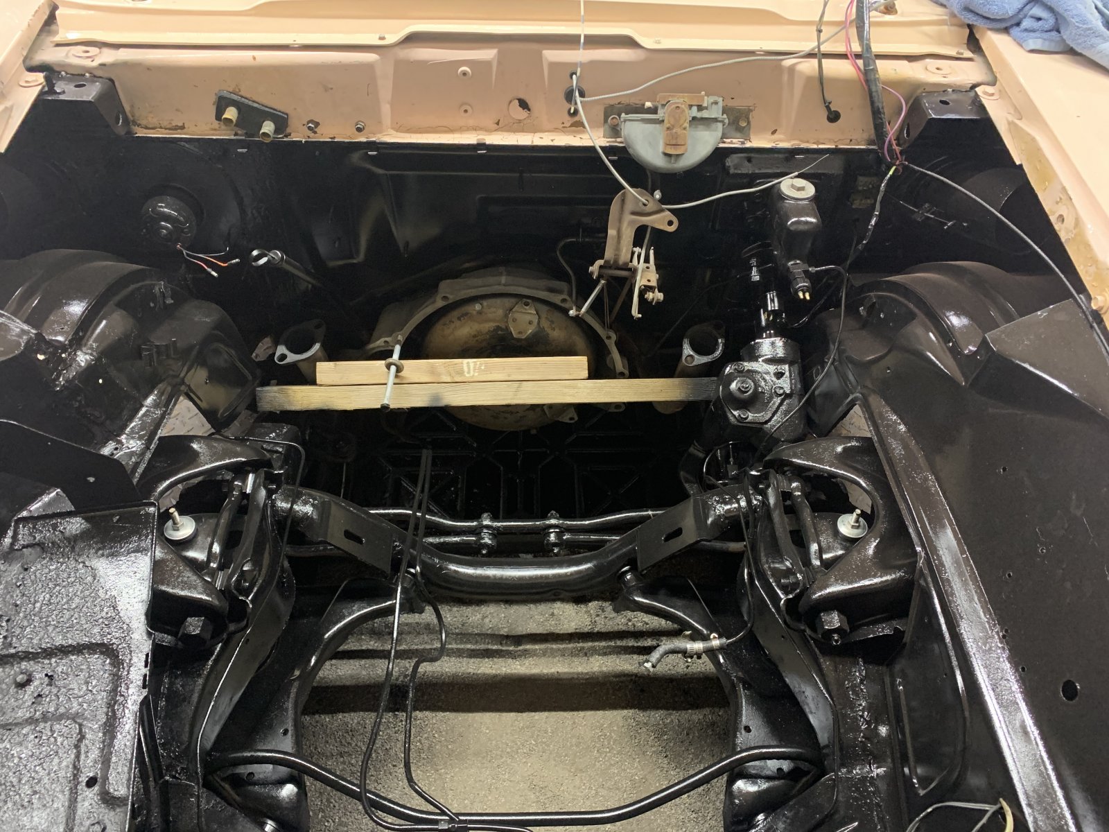

    Hoping to stab an engine back in this evening. We didn’t spend a lot of time cleaning and painting, but it does look a little better. Pay no attention to the rusty battery tray... :oops:

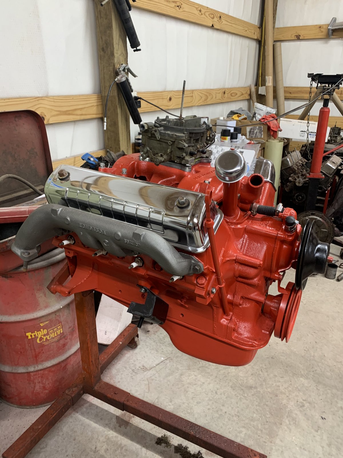

    Well, motor still isn’t in, but should be tomorrow. We should have spent more time on cleaning up the engine compartment, and I wish the paint was less glossy... But, it will do for what this is. Took most of the day to clean up more stuff and swap from old motor. And, I decided to clean up the shop some...tired of tripping over stuff.

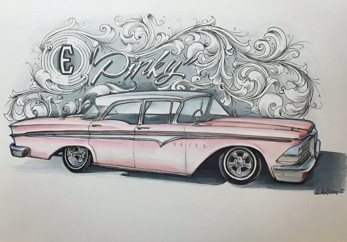

    Just got this last night too. Silas asked a friend of ours, Alan Childers, about drawing the car. Alan is a very talented young guy that works for Steve Cook Creations building some amazing cars. Anyway, drawing turned out pretty kool. Now we know what it might look like with Supremes and skinny whitewalls.

    I did my engine compartment with VHT ch***is and roll cage black, not a gloss. It blended well for touch ups.
