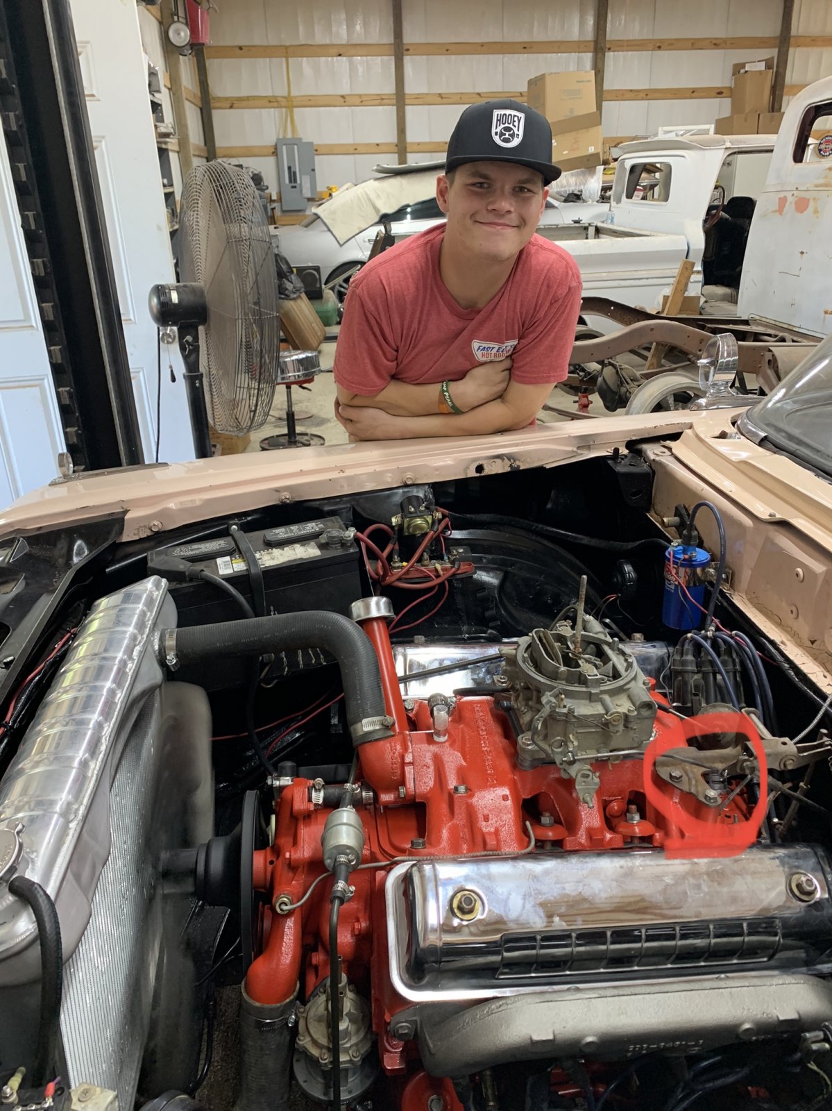

  7. so... what is that bracket behind the carb?
    my '57 has the mounts for it, but no bracket.
    guthriesmith likes this.

  9. guthriesmith
    Joined: Aug 17, 2006
    Posts: 12,030
    guthriesmith
    Are you referring to this bracket circled in red? If so... I happen to have the one that came out of the 57 wagon that this motor is out of that I don’t need...
  10. im more wondering, what is it? my '57 doesnt have it, but its a manual, so i dont know if its supposed to have one.
  11. guthriesmith
    Posts: 12,030
    guthriesmith
    Oh, it is part of the kick-down linkage for the automatic transmission. I ***ume that is why yours would be different since all you are controlling is throttle.

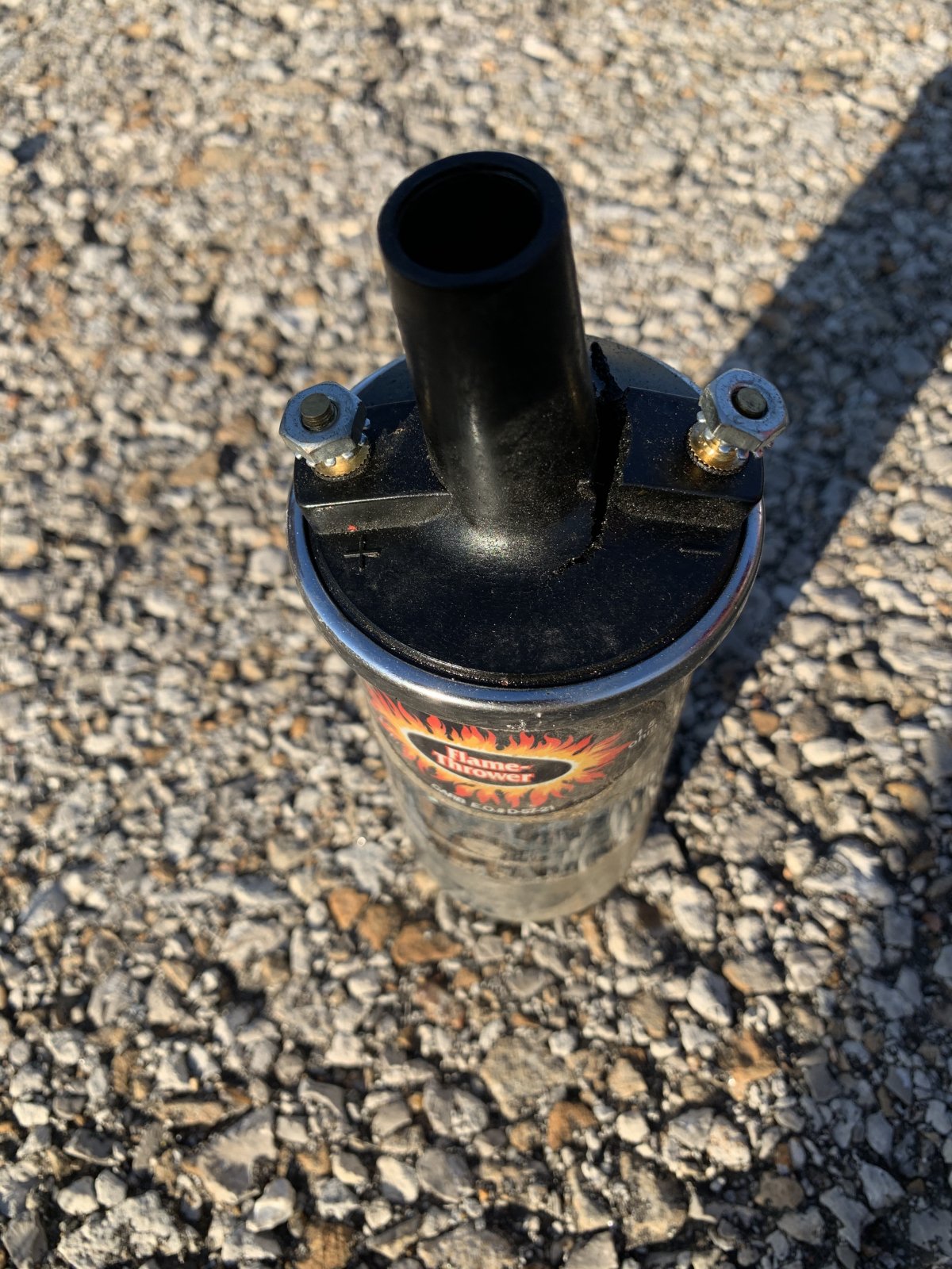

  12. also, why did you change the coil location from under the air cleaner to on the firewall?
  13. guthriesmith
    Posts: 12,030
    guthriesmith
    Mainly because it was on a homemade junk bracket when we got the car and it crashed with the original air cleaner. Now that we have everything pretty much correct according to the 57 motor, we can probably move it to the stock location now that you mention it. :D
    However, we also blew up 2 coils having them mounted horizontal as well now that I am remembering why we stood it up vertical. I know I have mounted them horizontal before, but haven’t got away with it on this car for some reason.
  14. ive never actually seen a coil fail... even the one the car came with was seemingly functional, it had just been exposed for who knows how long. and someone removed the screw inside of the coil.
  15. guthriesmith
    Posts: 12,030
    guthriesmith
    This is the first one we failed on this car. It split open on top and spilled out the oil.
  16. maybe its because i use oem stuff... and not performance parts.
  17. guthriesmith
    Posts: 12,030
    guthriesmith
    It has a stock one now after blowing up the Pertronix one that came on it and then another one we picked up on the road on the way to the Gathering at the Roc last year.
    On a related note...it now has points again since we left the Pertronix unit in the 292 we pulled out. I am one of those silly guys that would rather deal with points than electronic ignitions which is what came in it.
