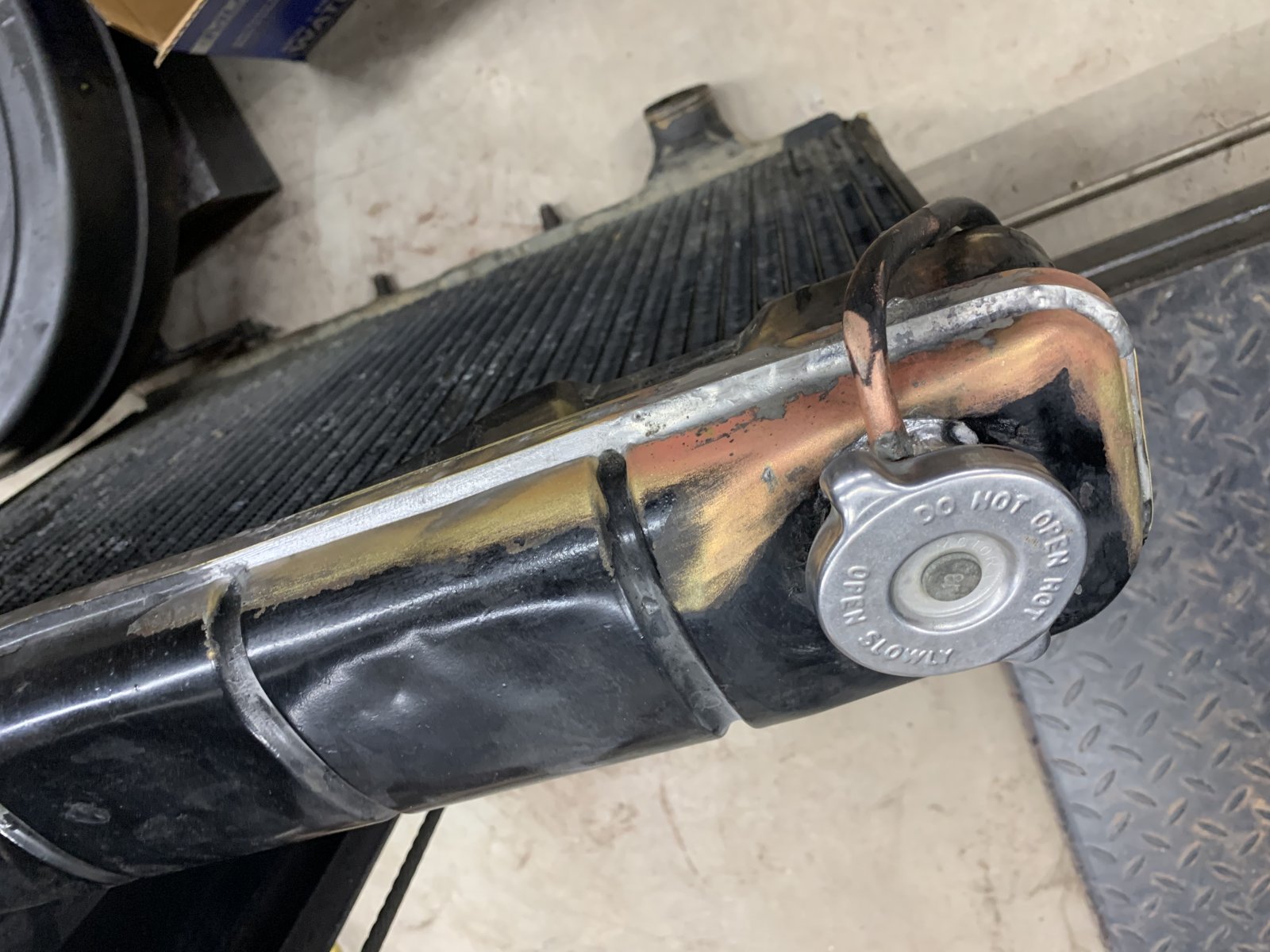

    Got the water pump on last night and also decided to fix the radiator right. The top tank sprung a small leak on the trip home from Arkansas, so figured now was the time to deal with it while we dumped the coolant. I called Sid (my favorite axle dropper and good friend) and he soldered up the area that had been “fixed” with some parts store radiator repair junk that was a pain to clean off. If we were smart, we would also go ahead and replace the heater core that I am guessing is bad as indicated by the looped heater hose. But, that will wait for another day so he can drive the thing and we can get it to the Roc this weekend if possible. Also picked up some lowering blocks and u-bolts for the rear while we were getting other stuff at the parts store.

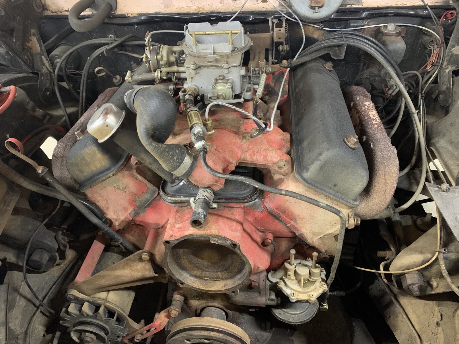

    In that pic of the engine bay I spy one of those glass housing w/cartridge fuel filters. I used the same for a few years, but there are a lot of people out there who caution against those, claiming O-ring failure, leaks and general Unpleasantness.
    A fuel pump for an FE will fit on the Y-Block too, and has a large, integral fuel filter so the glass filter could be eliminated. A straight section of brake line stick sold at NAPA can be bent up easy to make a seamless fuel line direct to carb.

    Good point on the fuel filter. I have heard many stories of issues with those, so have never used them. We need to get that dealt with. Thanks for the reminder!
