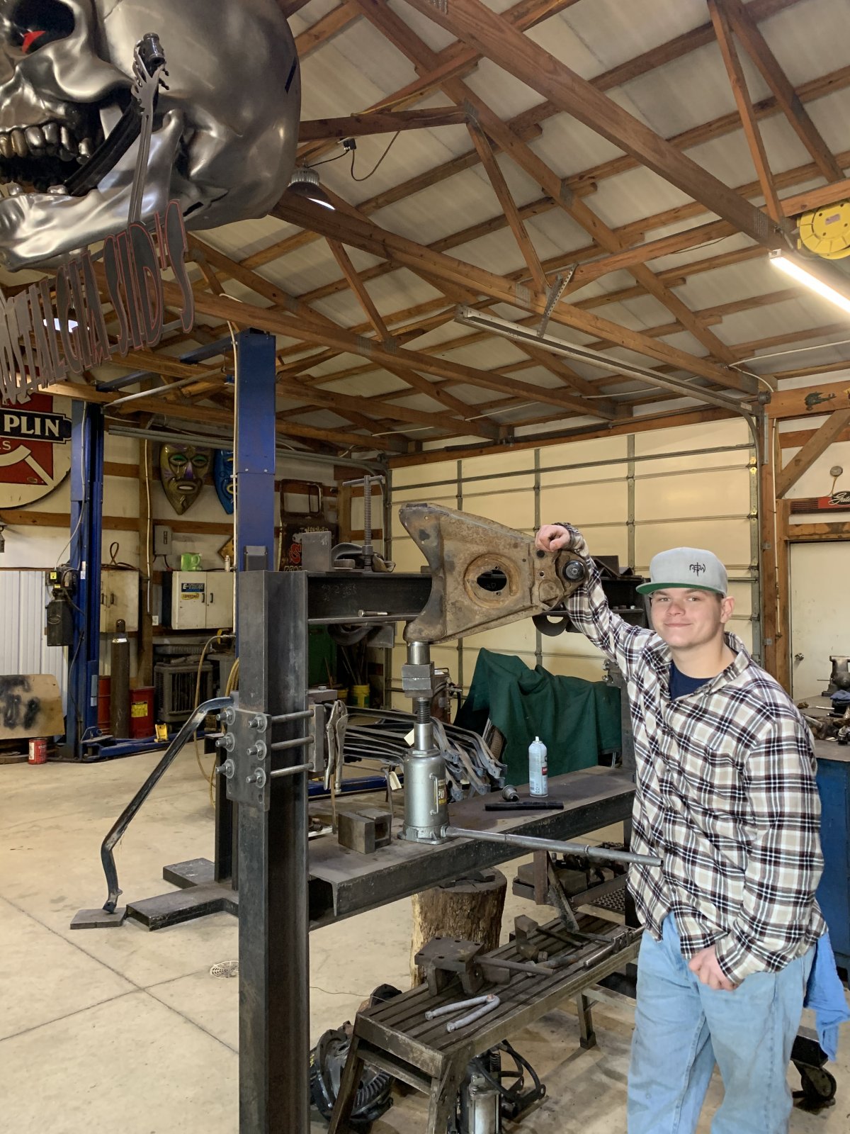

    Well, just now headed in the house after spending all day on the front suspension, wheel bearings, a new wheel cylinder, etc. Silas was off and my grandson went to spend the day with his dad, so we had all day. Pinky should be back on the road tomorrow after we bleed the brakes. :cool:
    Pic from Sid’s shop where we borrowed one of the axle presses to use as a bushing press.
