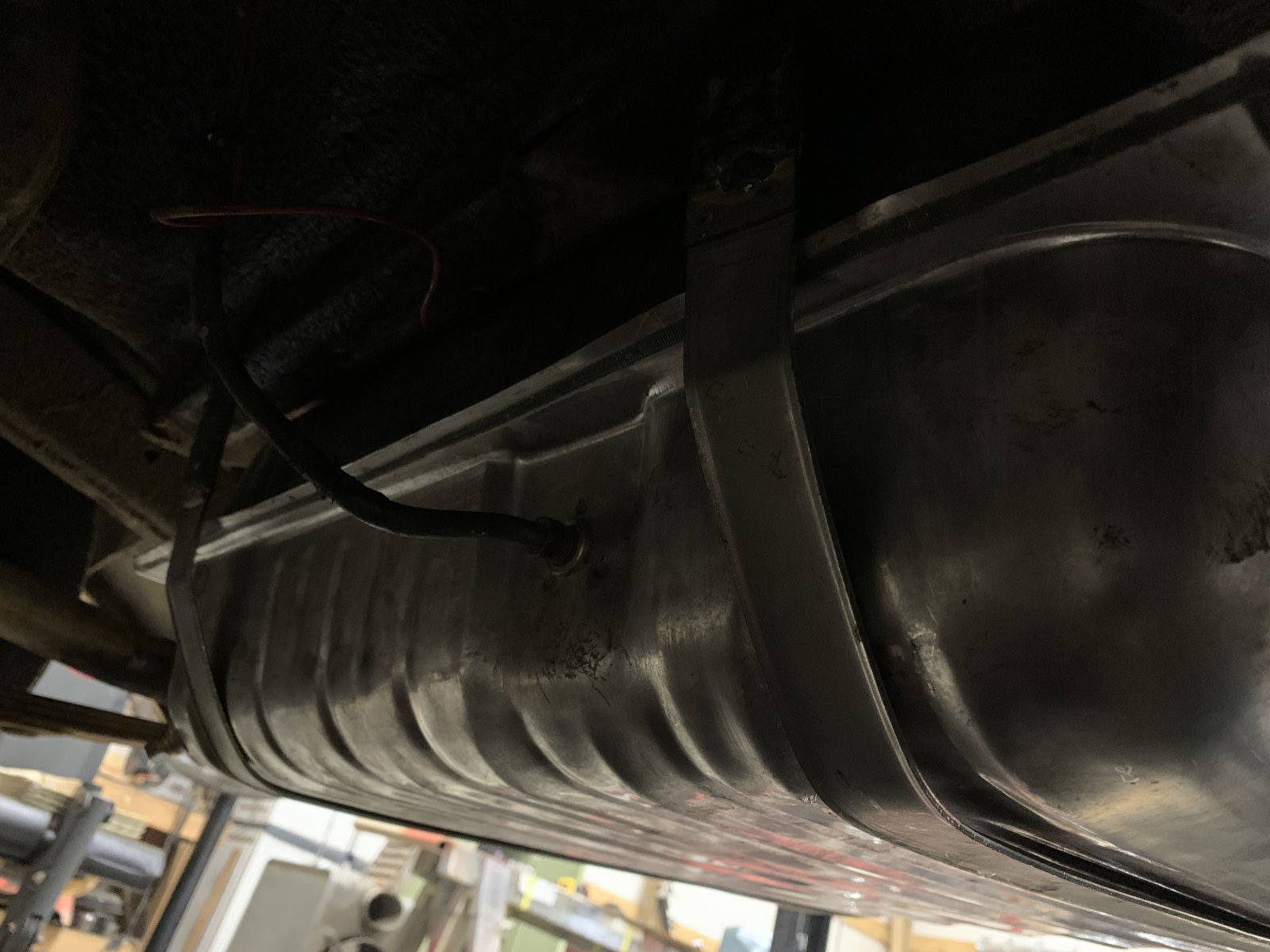

    This pic should help describe the progress we made this week on the gas tank... Snowmeggedon 2022 stopped productivity (or we diverted attention to my other son's heads on his car first).

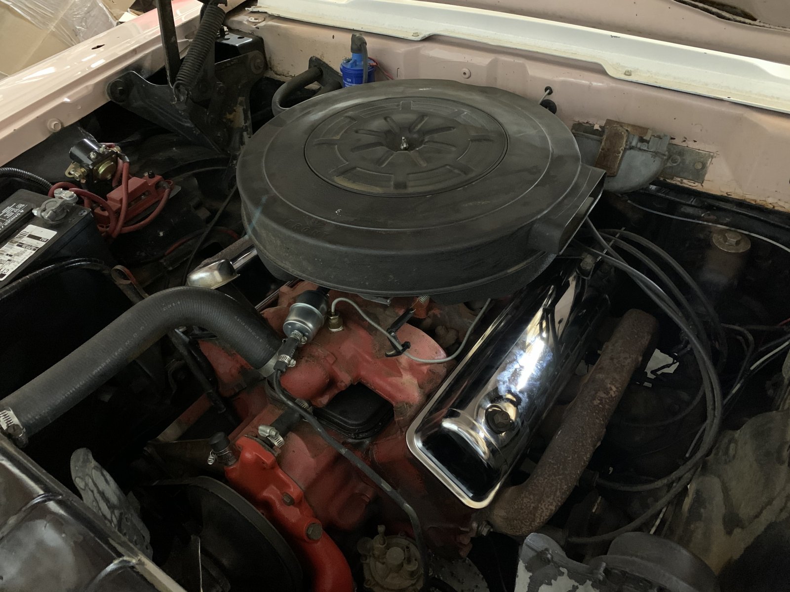

    Started on the gas tank today to find out that someone has previously swapped some other tank into it with a different sending unit. So, can’t make any more progress on that until we can get the right sending unit to start going back together. So, we decided to adjust the valves and put the chrome valve covers on. The valves were definitely loose. Oh, and finally swapped the fuel filter.

    .019” cold.
    You can run the engine with the rocker arm cover off without fear of making a mess. I cut a piece of card board about 4-5” high that fits between the springs and head ledge. I use some 2” wide clear packaging tape on the bottom. The over flow tube at the front of the passenger head and rear of the driver side after warm up should have some oil coming out. There’s not a lot of oil up on the top end at idle with everything open and good.

    Yep, we actually used the method posted by @Truck64 earlier in this thread. Pretty easy to do and now Silas knows how to adjust valves on a y-block.
    http://www.potomacbird.com/pctc/Public_Documents/waltnuckels-valvelash.pdf
    Strangely enough, we also had to adjust the valves on my other sons motor today as well after getting the heads back on it. But, it is a sbc and a hydraulic cam, so obviously different method.

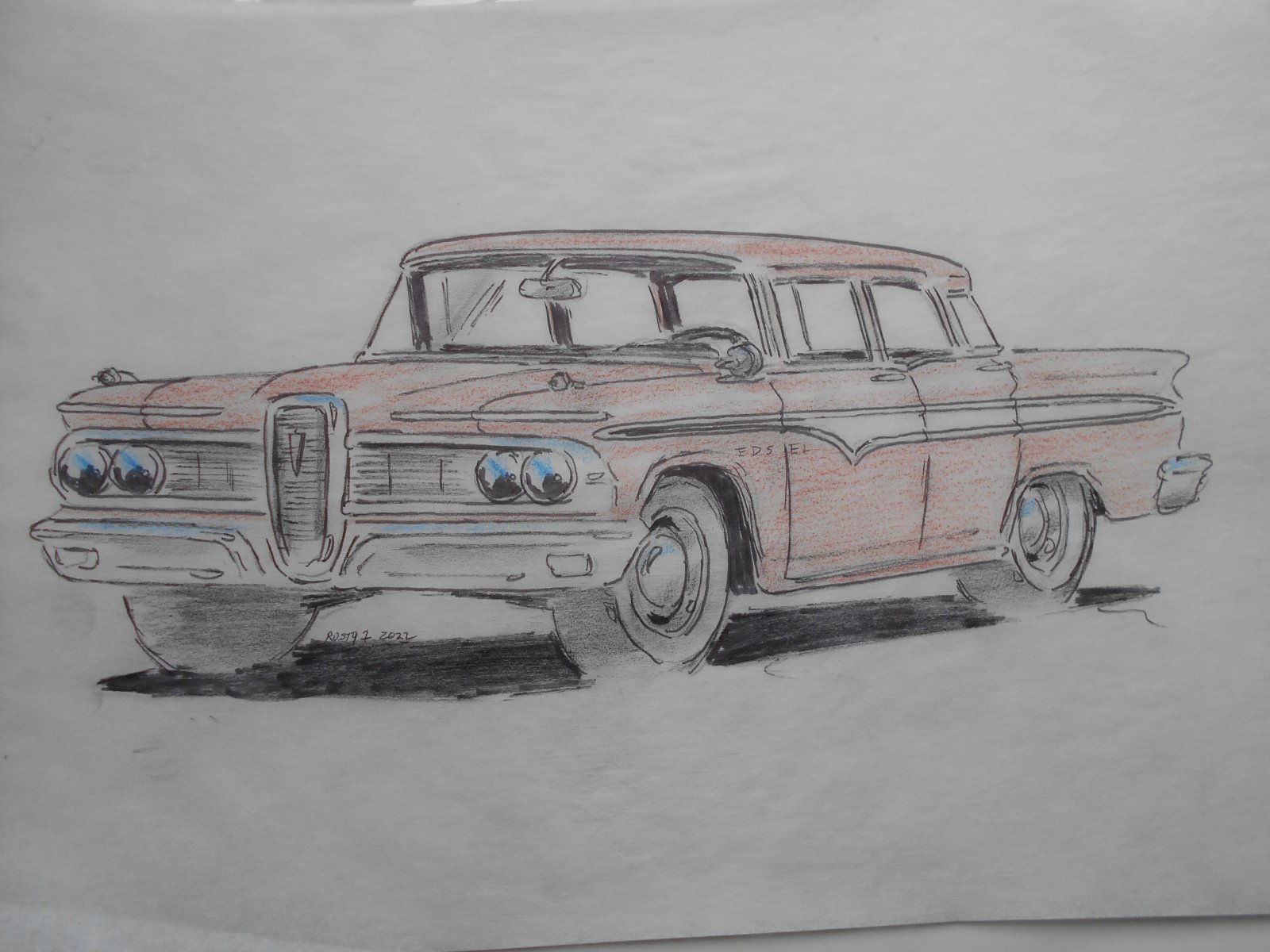

    Sam @rusty1 did some quick sketches of the car over the weekend in different styles and they are just too kool! Folks on this forum are the BEST and I am amazed how many have taken an interest in the young folks coming up in this hobby of ours. Stuff like this is why I hang out on the HAMB! :cool:

  20. That's awesome! Very cool @rusty1
    I really like the second one with skirts. Although the last one appeals to me too.

  24. ...thanks for the comments on the sketches, these were real quickies, and kinda "too new" for me as I have a vintage drawing arm, but I try to push myself into some newer stuff every once in awhile,..glad you guys liked the sketches.
    that Edsel would look good drop'd down about 4 inches.

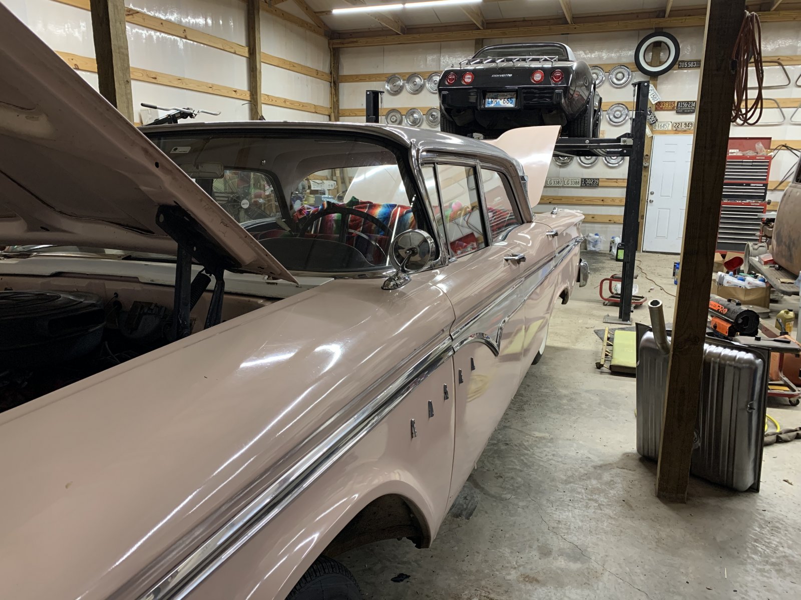

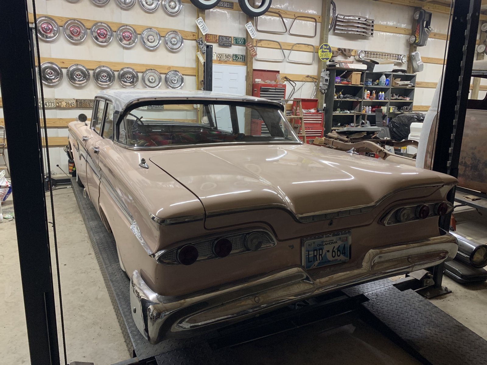

    Got the radiator fixed and back in then got back on the gas tank. We had to remove the mufflers (technically just one) for it to fit in since the 59 Ford tank is offset to the left some compared to what was in it. Once we got the exhaust out of the way, it wasn’t too bad to mount. We didn’t modify the tank at all, just modified the car a bit. We ordered the straps to go along with the tank and just welded a couple brackets to the frame for the rear mounts. Then, we added some length to the front of the straps so they would reach up to the body where the original Edsel straps mounted. Fairly clean install, but undecided about it being offset some. Apparently, that is to clear the spare tire well in the Ford. That sort of thing bothers me, but doesn’t seem to bother Silas, so we are good.
    Next is to go get the exhaust put back together and route the mufflers in the original area outside the springs under the quarters.

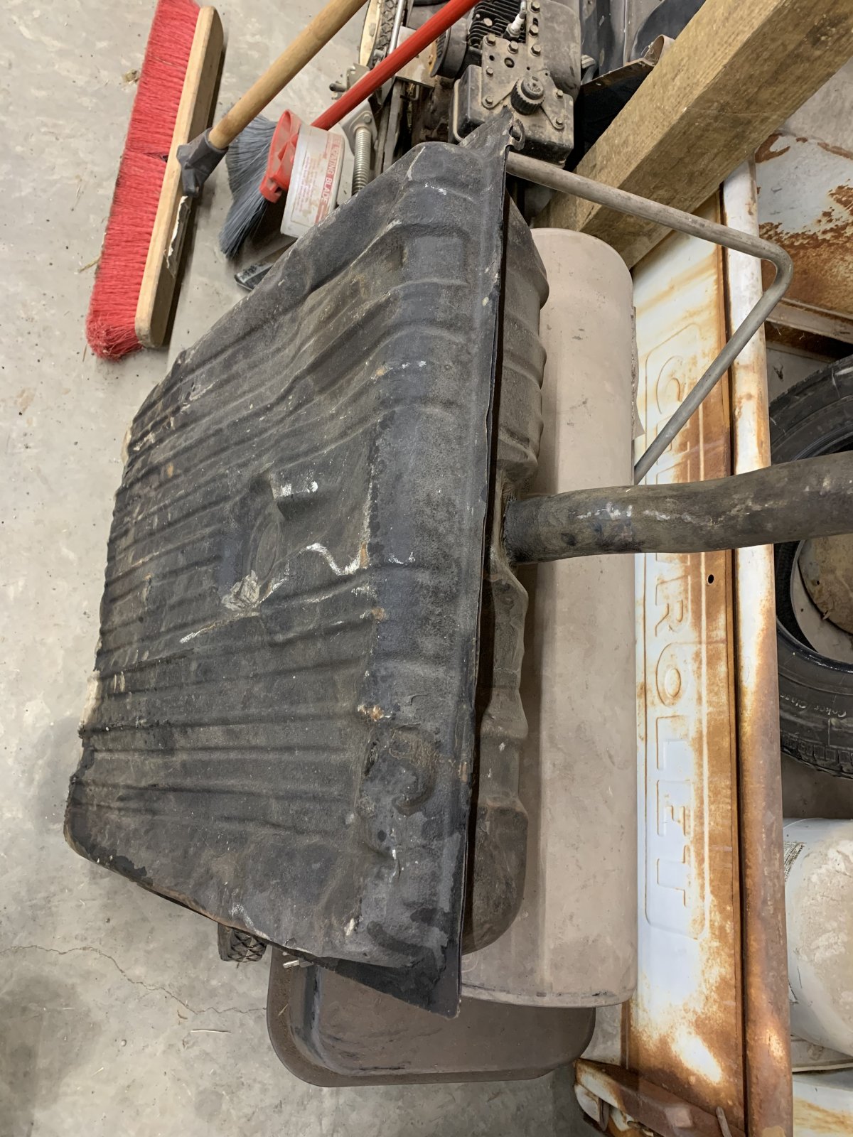

    Here is the tank we pulled out... Not sure exactly what it is other than beat to death and leaky. Someone had modified it at least as far as welding the fill neck in to fit this car. Not sure why they started with such a beat up tank to modify unless it is just all they had. It was a mess.
