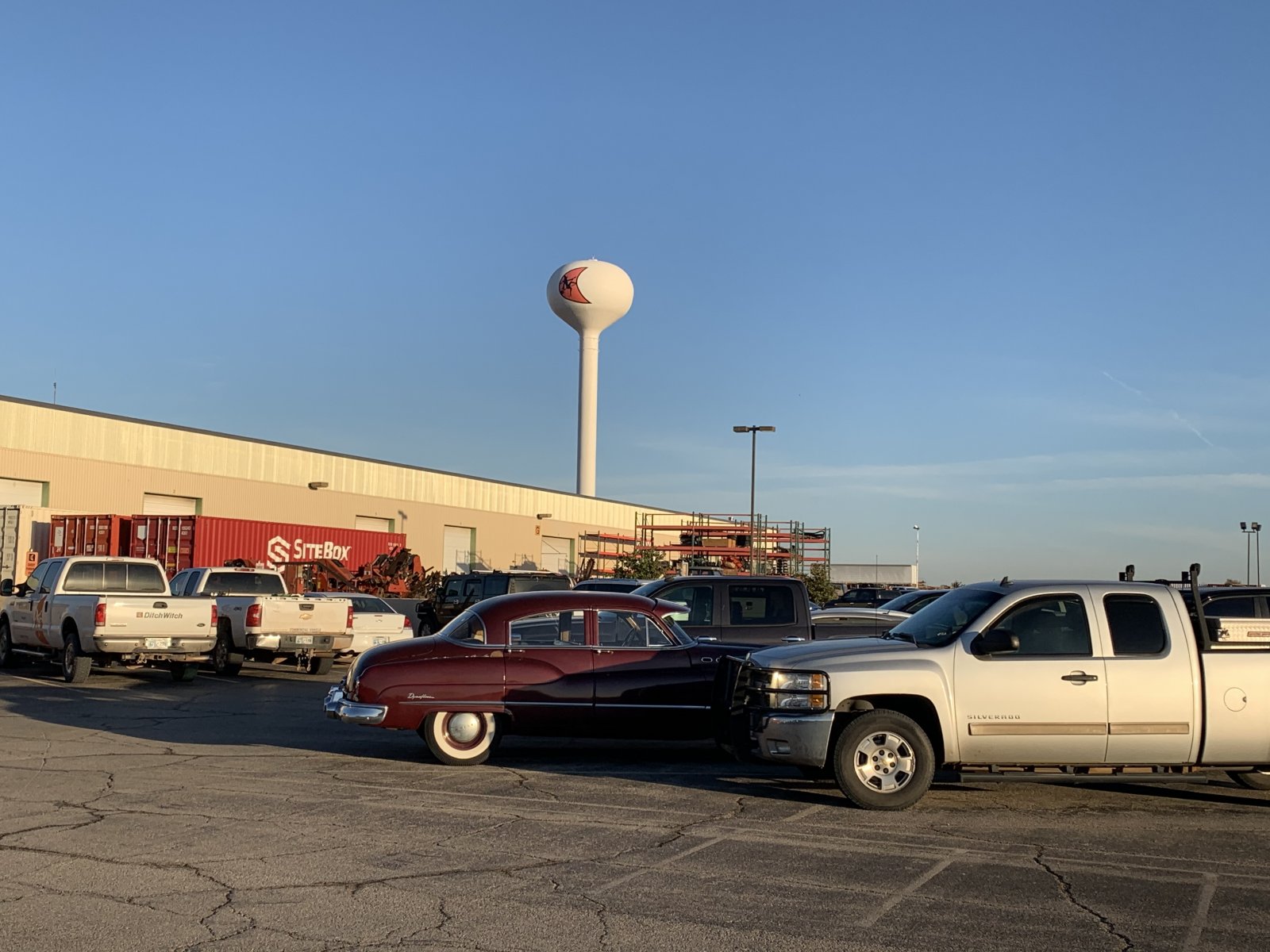

  9. guthriesmith
    Joined: Aug 17, 2006
    Posts: 12,030
    guthriesmith
    Woohoo! Bob got me all the way to work this morning! :cool: I never really doubted it, but it wouldn't be the first time I ended up on the side of the road trying to get to work in an old car either if I didn't make it. Thankfully, there are several guys that come in later than me that can pick me up on the way if needed. :D
    And, as a reminder, this is the town that the car was ordered new in at the local dealer and lived it's whole life until I got it. The first pics in this thread were in this same town.

  12. guthriesmith
    Posts: 12,030
    guthriesmith
    So, for those of you all that either currently have or have had one of these straight 8 Buicks, shouldn't I expect it to do pretty good on the road? Seems it is pretty down on power to me losing up to 10 mph (70 down to 60) climbing some slight hills. I still haven't tried to do any tune up work on the car, but I would expect it to have more power? I know my 56 Ford has no issue at all keeping speed pretty much no matter the terrain. Anyway, just wondering before I jump in and tune it up and am then surprised that it still seems pretty sluggish.
    And, a pic in the work parking lot showing how the old Buick just fits right in...

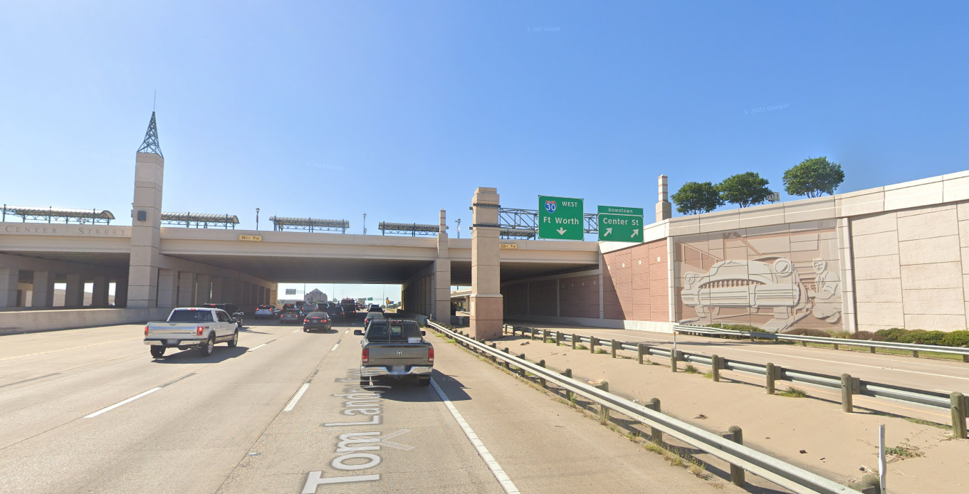

  27. Gotgas
    Joined: Jul 22, 2004
    Posts: 7,252
    Gotgas
    from DFW USA
    When they rebuilt I-30 through Arlington, they added this concrete mural at the westbound exit to Center St. :cool:
    I thought you might appreciate it...
  28. guthriesmith
    Posts: 12,030
    guthriesmith
    That’s cool! I guess I haven’t seen that yet! Thanks!
