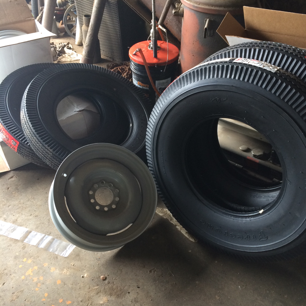

    New shoes
    volvobrynk likes this.
