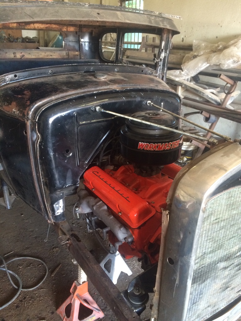

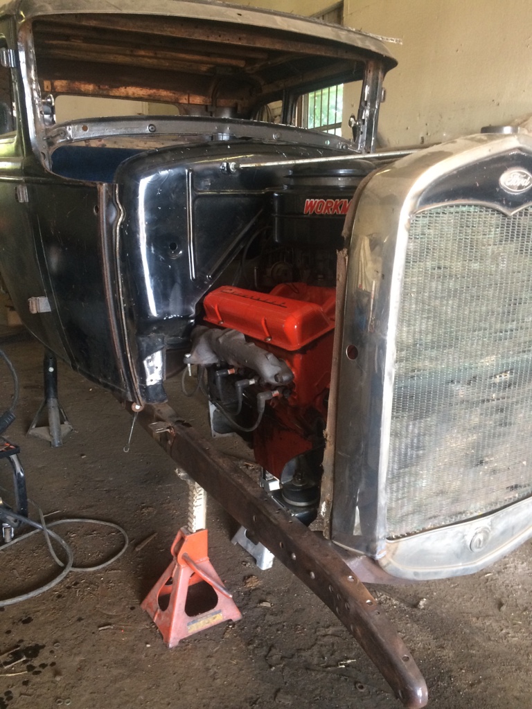

    The little 265 is in its new home.

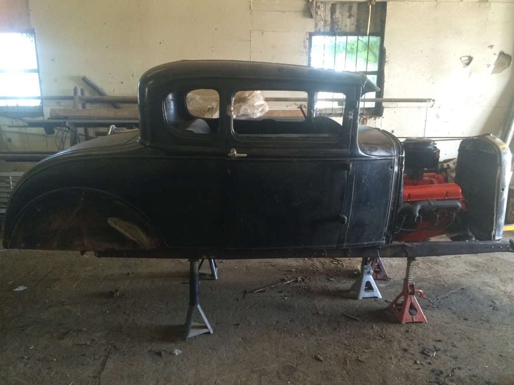

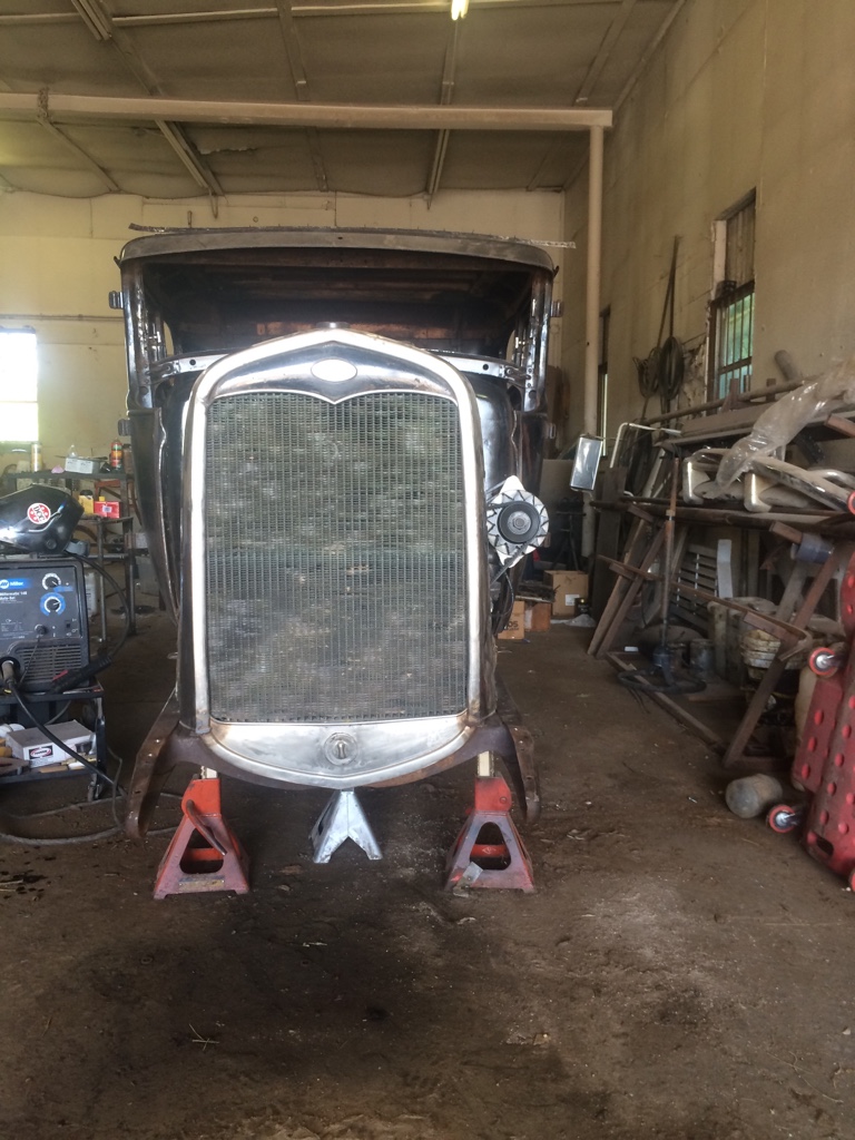

    Cut the firewall up and got it back in and did a little mockup. Should have the front bones split this weekend and the from end mocked back up.
    Now to find a transmission and build pedals and crossmember.
    Get a rear end and get it mounted then it will be a roller again.
    ImageUploadedByH.A.M.B.1467752623.052529.jpg ImageUploadedByH.A.M.B.1467752649.817359.jpg ImageUploadedByH.A.M.B.1467752677.471974.jpg
    Going to either run without hood sides or find a bracket to mount the gen up over the intake.

  8. 55zephyr
    Joined: Sep 5, 2013
    Posts: 132
    55zephyr
    I personally like the genny sticking out the side, kinda looks like it shouldn't be there. I've kept it like that on mine. Cool looking build.
  9. Hot Rod 50
    Joined: Jul 30, 2007
    Posts: 500
    Hot Rod 50
    Thanks man. I kinda dig it the more I look at it. I really wanted to run a hood though but maybe just the top will look good.
