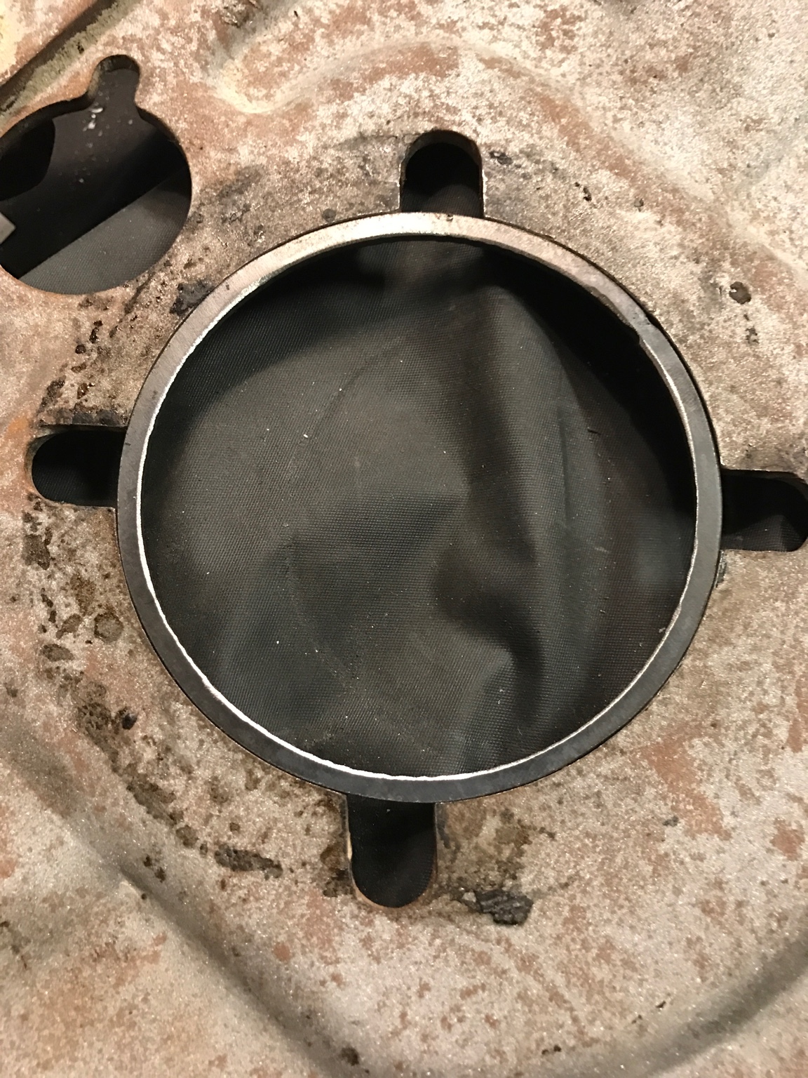

    Cut out some adapter rings on my cousins plasma table to get the 50 F-1 brakes to center up. I bought the kit from speedway and promptly broke a ring. So we made these from steel and will weld them in.

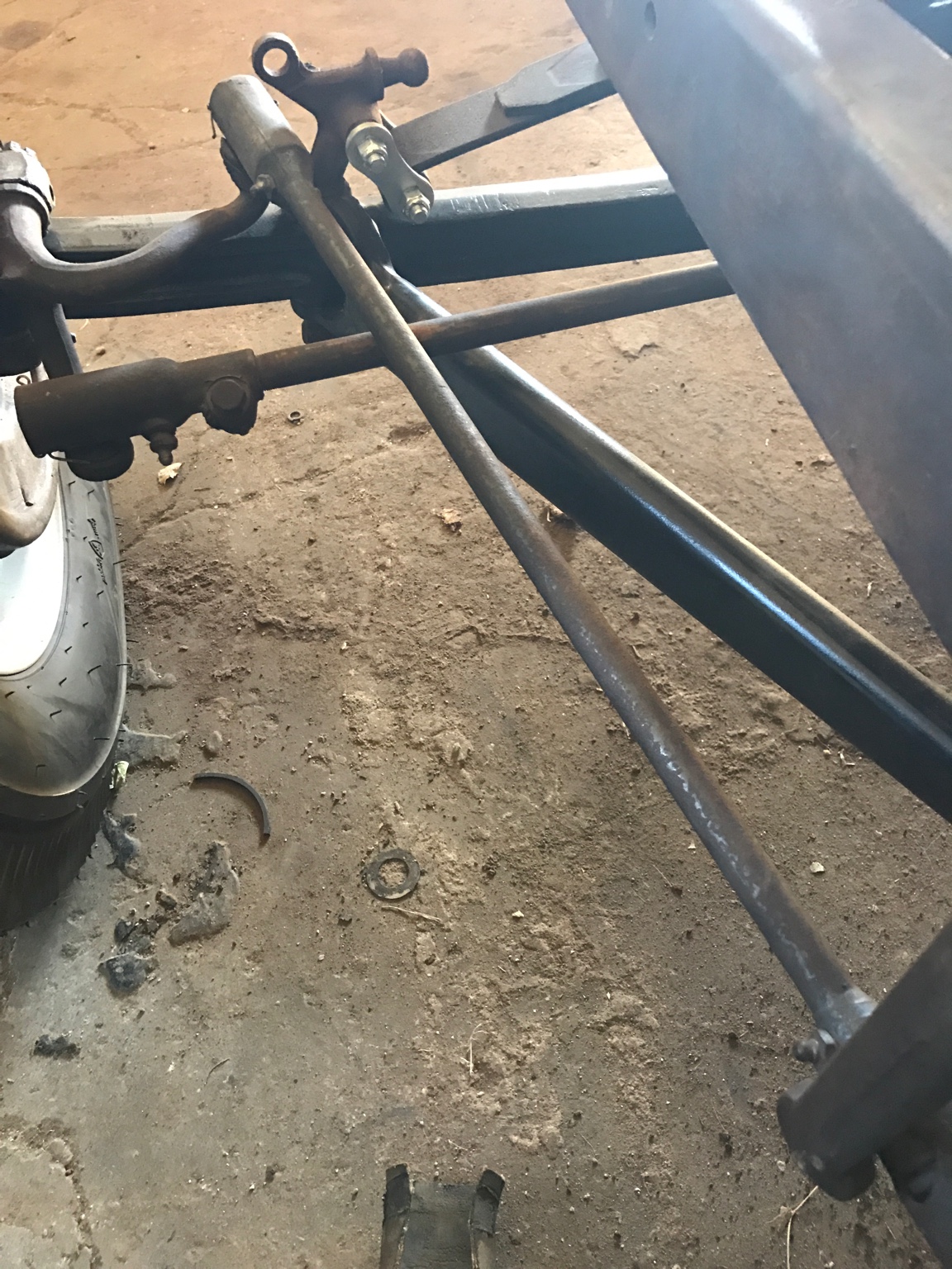

    I played around with the front suspension today and I have an idea.
    I split the wishbones, but on the steering side it all interferes.
    [​IMG][​IMG]
    I'll be building a mid motor plate or side mounts for the 265. If I just made that a removable cross member then make a mount for the ball joints I could set it up kind of like they were originally
    And it clears up a lot of the steering problems.
    Thoughts?

    HERES MY SET UP ILL TRY TO GET BETTER SHOT WHEN I GET HOME
  30. slinginrods
    Joined: Oct 6, 2008
    Posts: 422
    slinginrods
    from florida
    HEAT AND BEND PITMAN ARM AND RUN THE BONES BEHIND IT
