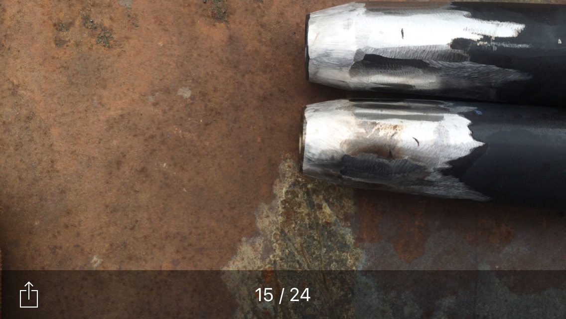

    I bent the wishbone right under the tie rod. I also had to heat the steering arm and bend that up so that the tie rod cleared the wishbone. Good to know someone else had this problem!!!

    Cool. Thx. Ben do you have any pics of it in your thread?

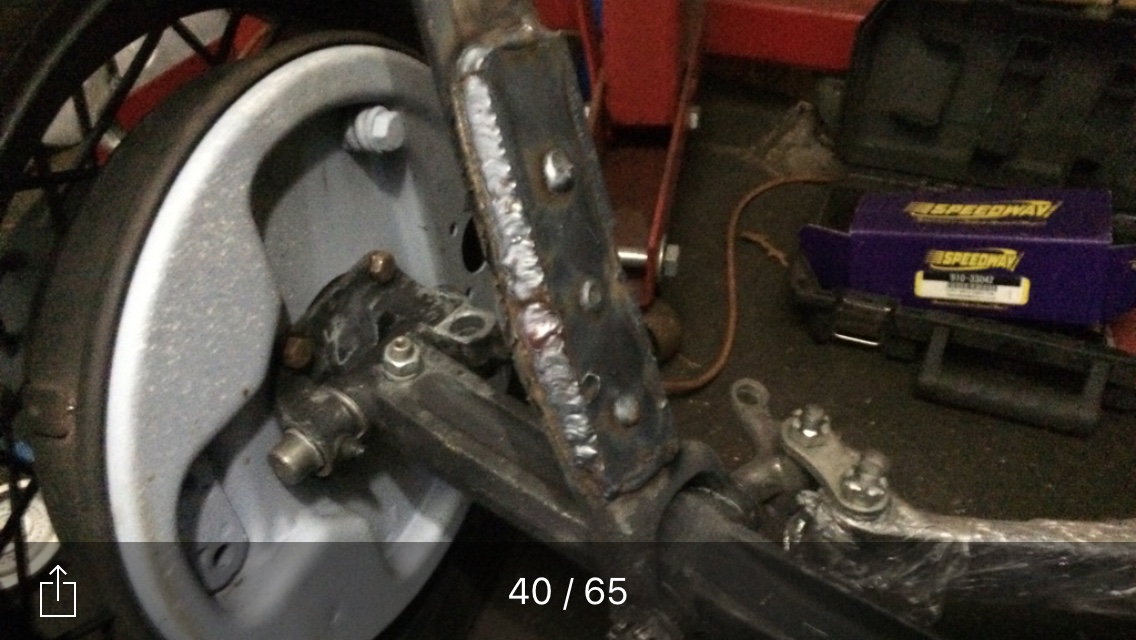

    I'm not using the same spindles as you. But you could easily bend your steering arms to clear everything. Man my stuff looks ****py

    Thanks for the pics. They definitely help. I'll get to bending around on things and see what happens.

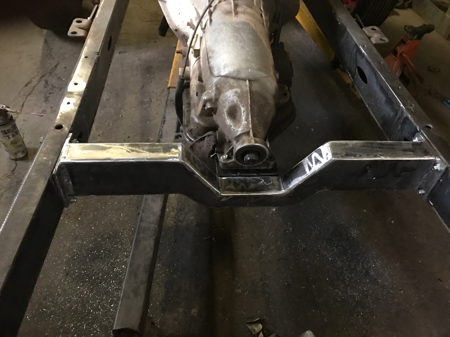

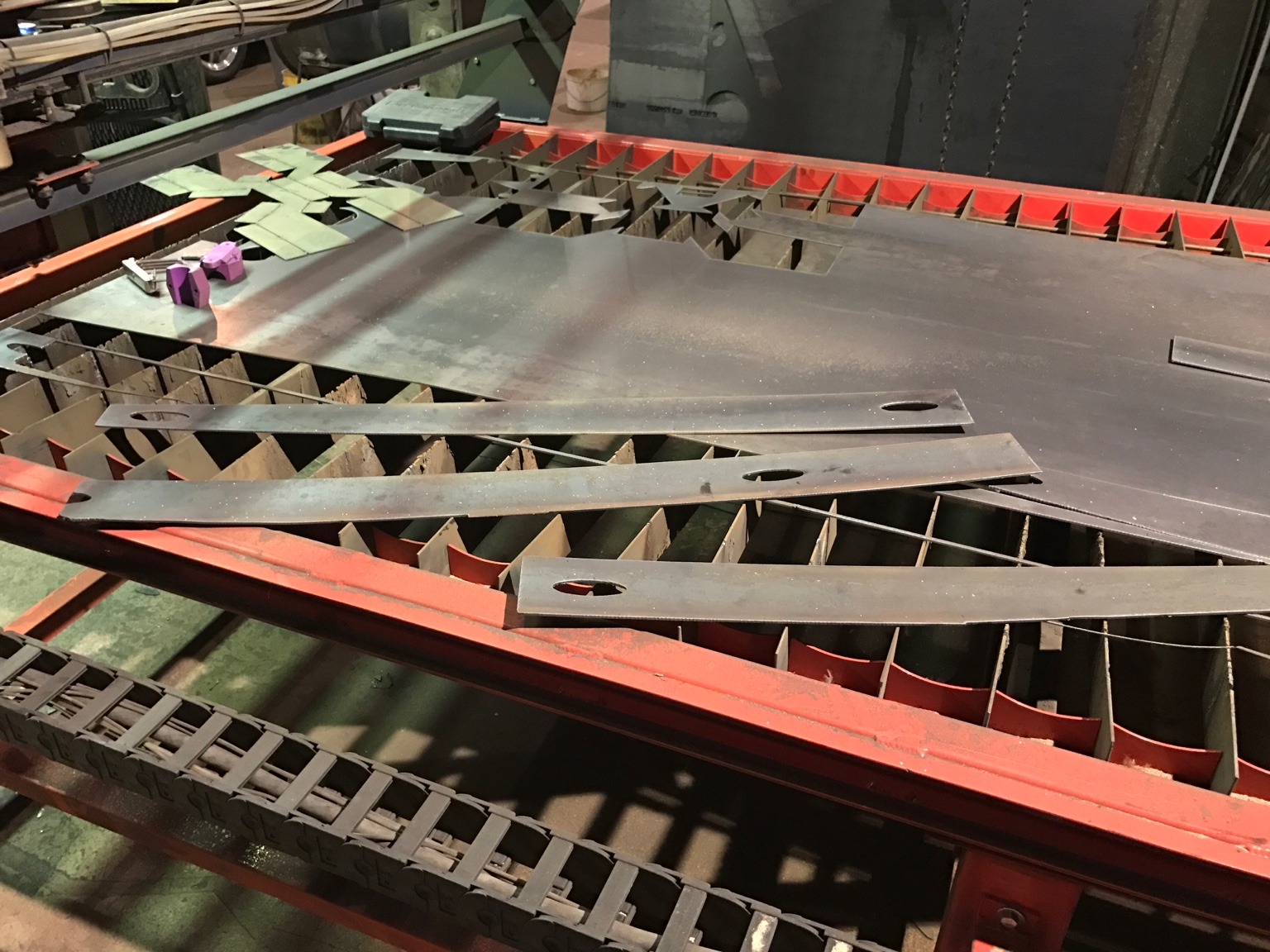

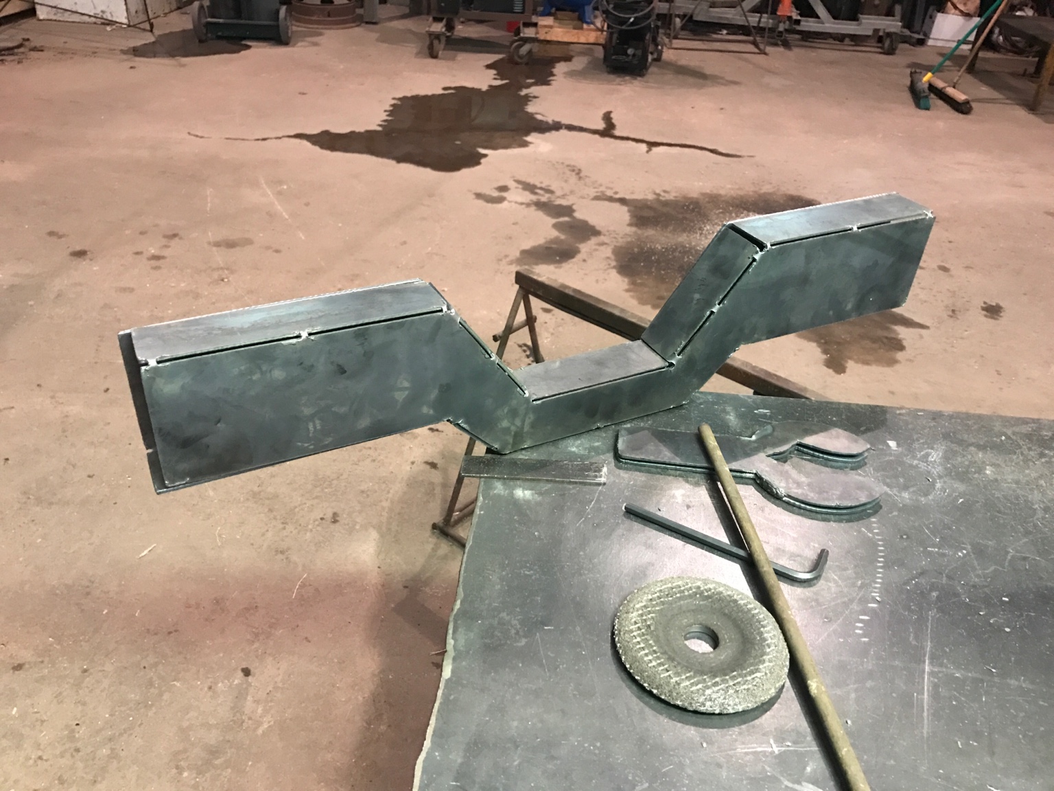

    Finally got around to designing and cutting out boxing plates and a trans mount/cross member. I dig it. It's not super stylish or trad but we built it and it should work. I think my cousin is gonna save this so if y'all want either of these let me know. Should be pretty affordable.
    The Cross member is cut as one piece and bent together and welded up.
