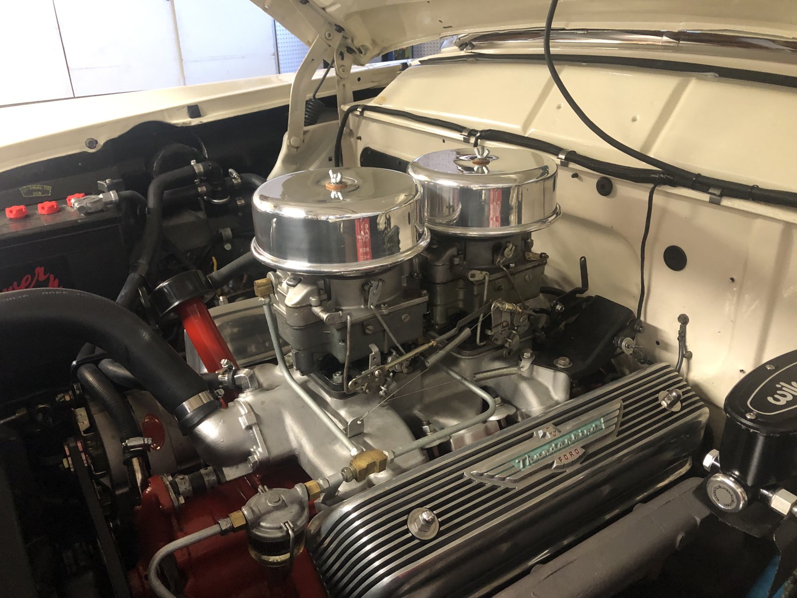

    Since the carbs are mounted reversed I’ll ***ume this is from a 57 T-bird which needs a different valley cover. You can turn them around for the car. The carbs are fine and should work with a 57 up distributor. If someone used earlier carbs you will need a Loadmatic distributor. Ted Eaton has letter on how to covert earlier carbs with 57 up ignitions.
    Overhauled correctly they are fine and get a bad rap. Hundreds of thousands worked fine. Our family owned 2 cars with them. A conversion to later carbs need adapters and AFB’s will work on them. Also any small base WCFB’s will work but it’s best to find identical ones.
    I’ve run 2-4’s on my stock 292 for 7 years trouble free using WCFB’s…good luck 87F809C3-F22A-478E-A2BC-A18A1A2324B0.jpeg

    I think I have the correct valley cover but a hammer can fix one too... i prefer the teapots personally, period rods with period carbs, I will probably dress the engine to look like it was yanked right out of a 57 bird! Appreciate the tips!

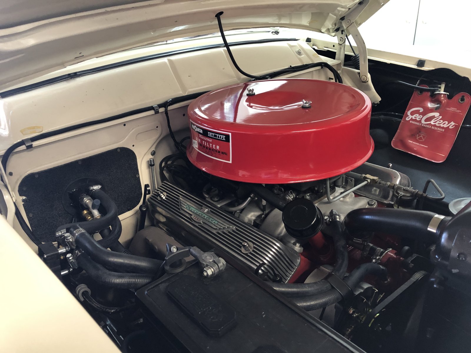

    In 56 Ford offered a performance package at the parts counter for law enforcement and racing. It had a 2-4 manifold, Holley carbs, cam, etc. Merc dealers offered the same package with Carter WCFB’s with were standard at one of their ***embly plants; both were rated at 260 hp. Small base Carter WCFB four barrel carb were used 2 years before the Fords use of Holleys so they and Rochester small base are defiantly “correct” or any early 50’s engine.
    The original air cleaners are the problem to find and expensive when the are. Here is a one year only 56 NASCAR approved Purolator air cleaner for a Ford. The civilian ones were different. A81AC3EF-1EBB-46D2-951E-7528724A74CD.jpeg

    Could probably make an air cleaner that looks dang close to that! Nascar only version would be cool too!

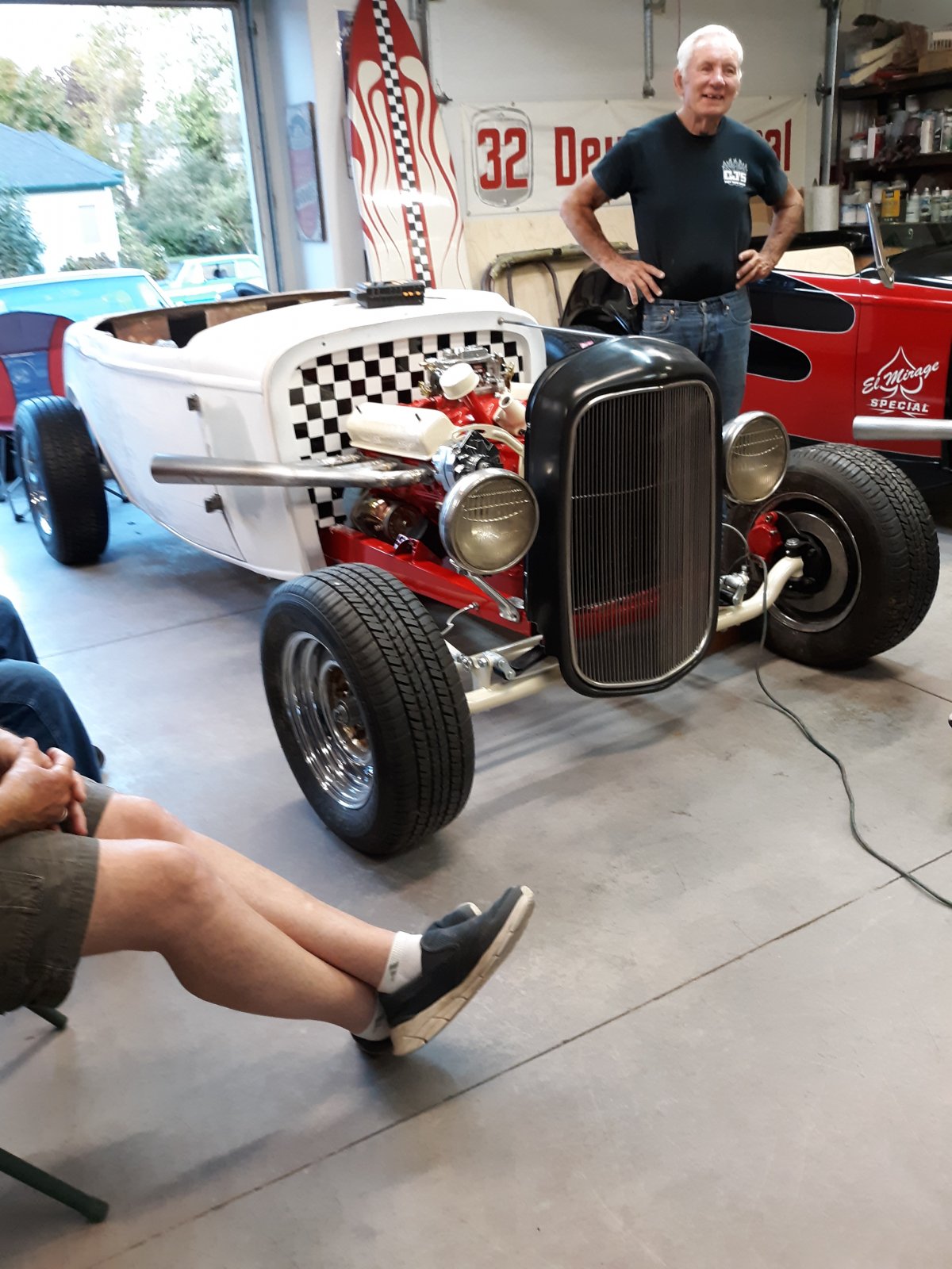

    Well, I have posted in the past about our 1932 Y-Block powered build so I thought I would post the end of the story. Our car sold and went to Washington state last week so we are on to our next build, a 27 Ford track roadster 272 Y-Block powered. The 32 came out great, I hope the 27 comes out as well as it did. Mark 361196820_6593771934013262_7283318108600578470_n.jpg
