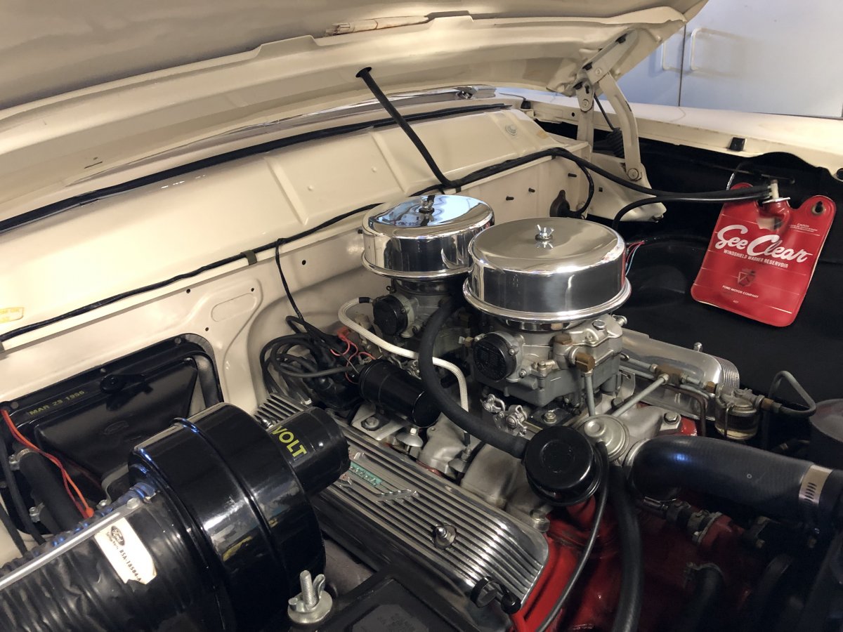

    I´d like to throw out a question to you fellow Y-block folks, my friend Jay has an E -Code 57 Ford with the dual quad 312 on it and I know those manifolds are pretty much made of unobtainium. His car runs very well and surprised me quite a bit. Is there a good aftermarket dual quad manifold? I´m running an Offy 3x2 with 3 94s and whild I do like the looks it just doesn´t perform well, the Holleys keep leaking on me and after a whole lot of headaches I´ve got it run better-ish on only the center carb. I feel like a 2x4 setup with AFBs could set thing thing on fire. Of course now it´s only a 2bbl in fact, but I just don´t want to tinker anymore with those leakin Holleys

    A home-made set-up I cobbled together years ago -
    [​IMG]Baumi - Have sent you a message.

    These don’t leak, not a Ford intake and needs no special valley cover. AFB’s are adaptable as this manifold I bought had them but I did not want AFB’s. There one on E-Bay right now for $450 which about right. 2 adapter’s and 2AFB’s ought to get you in about $1200 ... 94F88D13-ECB5-4D1C-B1A6-9B2C656FDD95.jpeg

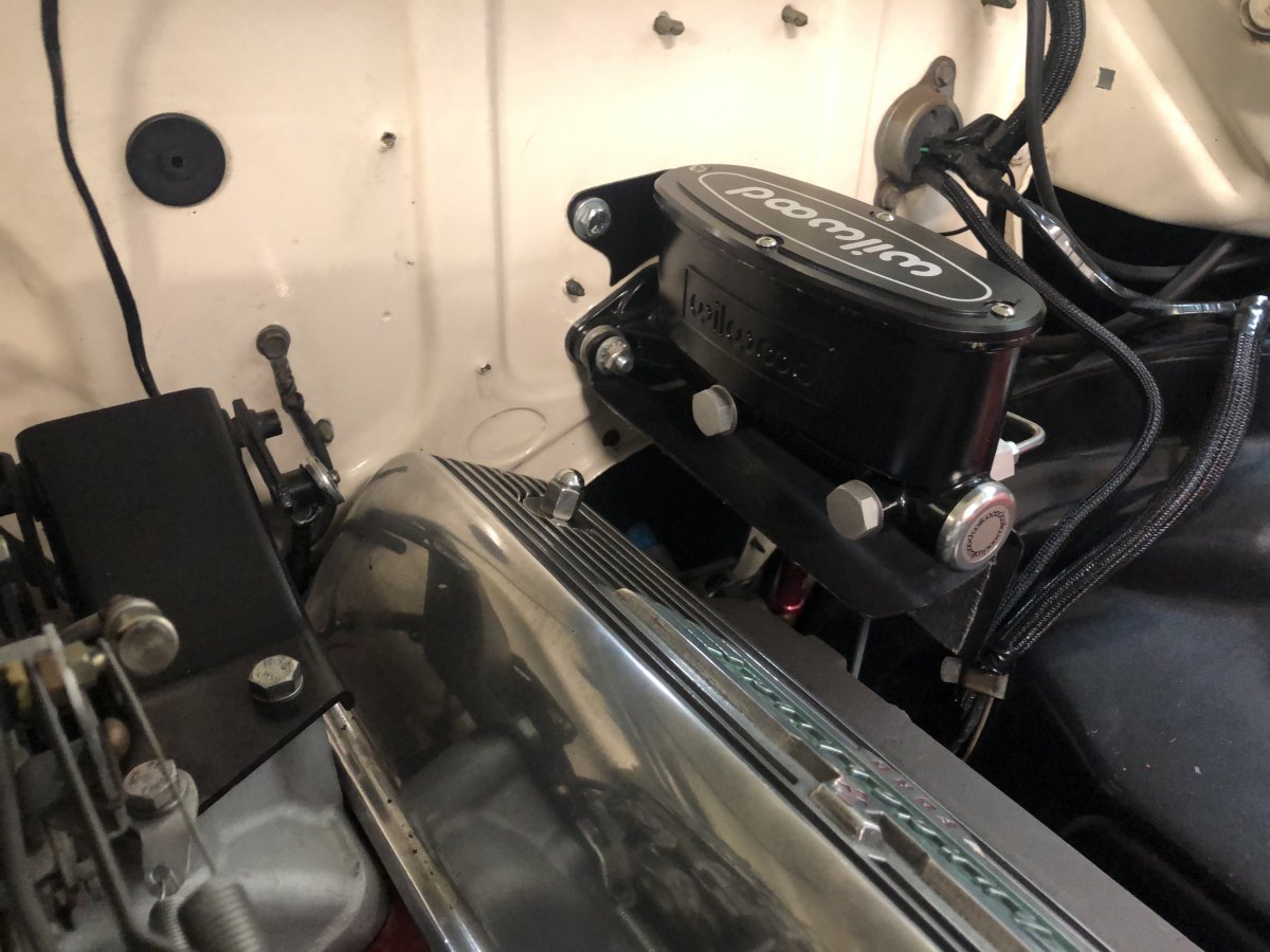

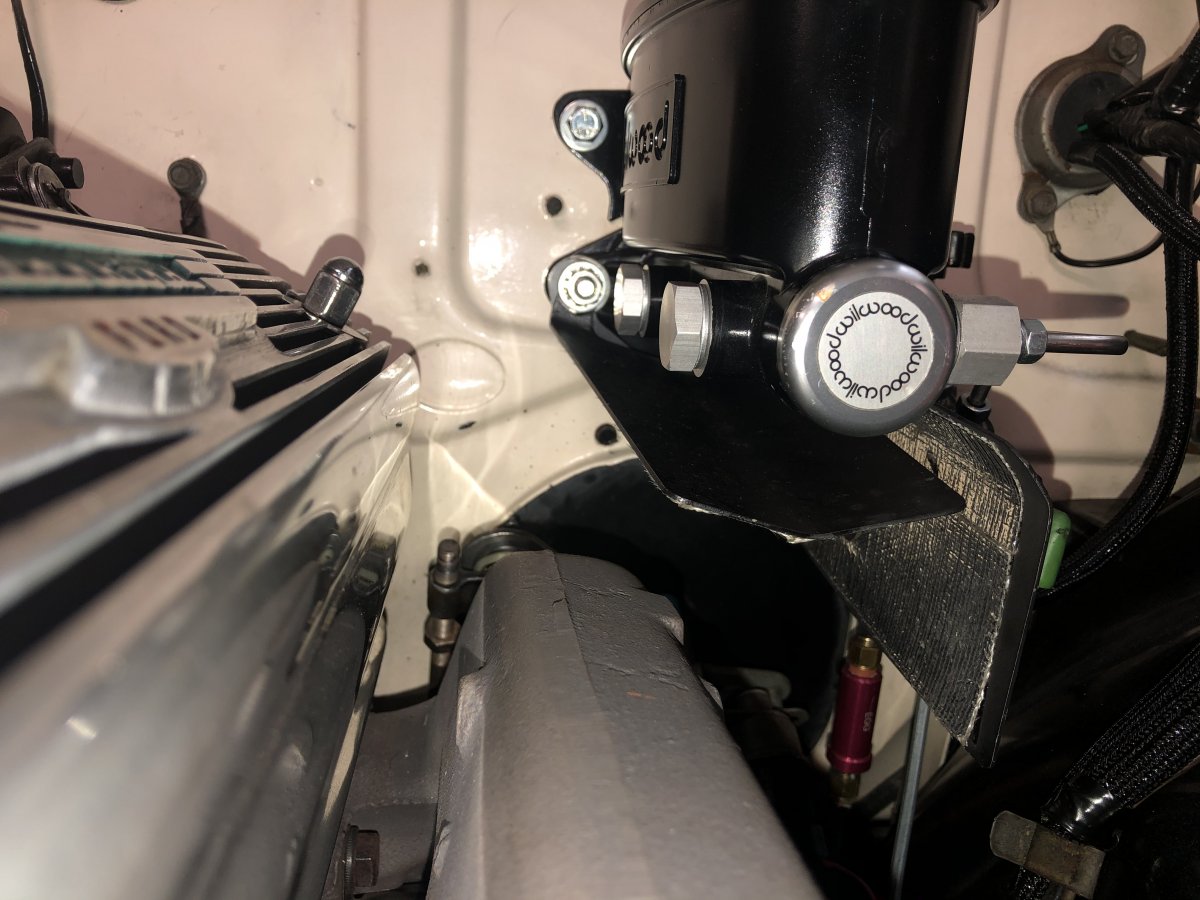

    Those photos show there's more space than first thought.
    I have the Wilwood/w proportioning valve, but also Sanderson ceramic-coated headers. The Sanderson's provide more space between master cylinder, and the ceramic coating is supposed to reduce under-hood temps.
    Catalogs list OEM master's "heat shield" as a drip pan.

    Yes. A 255 would have matched the 55-56 ports but this one came along. I removed the name and number and media blasted it. Found on E-bay 6 years ago.
    Roothawg. Same for a y. Avoid an Offenhauser 3-2.
    Best street is a 57 B or a Blue Thunder manifolds as they both have a heat crossover. Mummert doesn’t have the heat crossover. Many like the Summit 500 Carb which is out of stock currently. Ted Eaton’s tests show up to a 750cfm can make great power but for me on the street I look smaller. Even tho I run dual quads each is supposedly in the 375 range and I drive on the rear one 99% of the time. It’s the 1% that’s fun.
