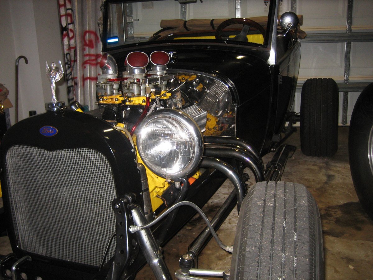

    I mod. the stock draf tube to PVC, with offset cup and rubber gasket for pvc. that then runs to a "T" going each side to center of main logs.of homemade 4x2. made from a old cut up driveshaft by me. Water pump run a little faster>using 1/4in. spacer on Mustang size { 302 sbf} water pump pulley. that is smaller then stock "Y"pulley.

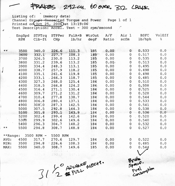

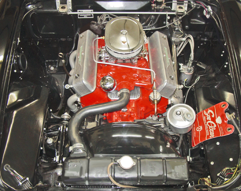

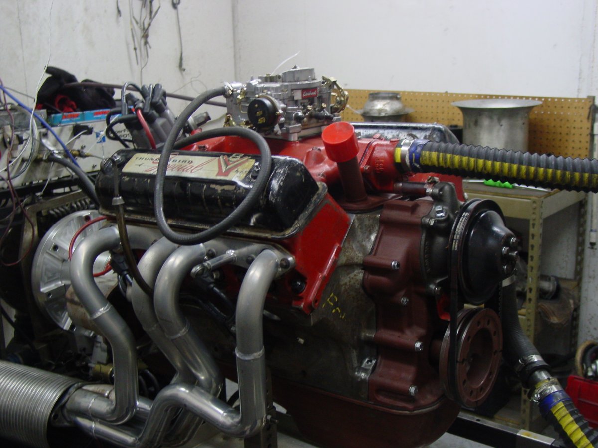

    May as well chime in here.
    Here's some detail on mine. 292 block is around 325ci with 312 crank. all mechanicals were balanced and blueprinted. rods were ground, polished and shot peened, ARP bolts in the rod caps. ARP studs in the mains and heads. Precision Oil pump. Cast Pistons.
    Rollmaster Billet timing gears and chain. Stock rocker arm sets for now. Heads are ECZ-G, Mummert prepared "Street" port. Stainless valves-int. 1.94, ex. 1.60 New hardened seats and guides. Complete Isky rpm 300 cam, springs and lifters kit, 298 lift 270 duration from Ted Eaton.
    Blue thunder intake, I painted it red! Eldebrock performer 600cfm.
    Ford PowerTrain headers made specifically for tbirds 55-57. I ground all the casting surfaces on the block and heads smooth of casting seams. Distributor is Ford factory mechanical tach drive with pertronix and full mechanical advance we ended tests at 31.5 degrees advance. Interesting note: I saw a difference of 15 HP increase on one of the pulls when we advanced the timing from up 1.5 degrees. It may still use more advance yet.
    Things I coulda, shoulda done but just could not find any more money to throw at it is: Hyperuetectic pistons or forged custom pistons and h-beam rods-this would have added an insurance factor because this little engine revs quickly to 5,700rpm and will go to 6,000 scarily easy, it just may not live there very long! This is primarily a street car with some weekend drags but mostly I DRIVE it.
    There was a kid helping in the shop about 30 yrs old who installed it on the dyno - He remarked he'd never seen one of these engines beforeand was skeptical. Was he ever surprised.
    The machinist was impressed he didn't realize it would ever go much over 5000rpm but wanted to know- "who did you say did the heads?- that guy is really goood. It really made the difference in it" . These are probably the last set of iron heads that John Mummert may have done before he got up and rolling with the aluminum heads.
    Not bad for engine out of a junkyard.

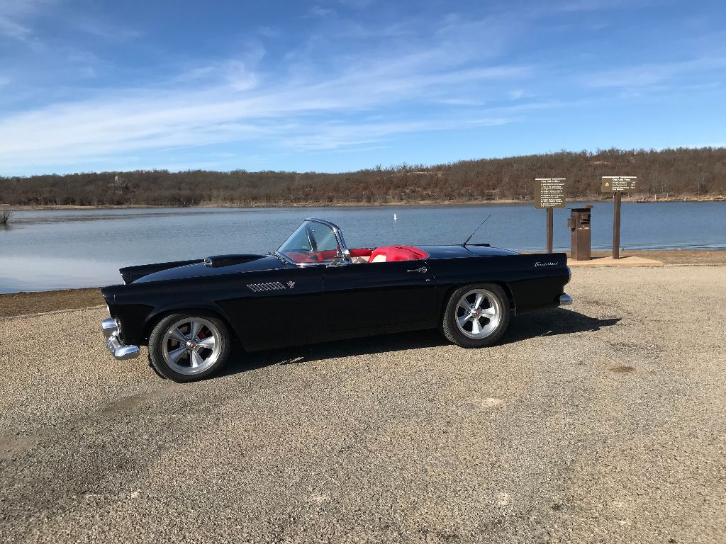

    It resides in this car.

    I know of no source for hypereutectic y-block pistons. Please tell us if one exists.

    y'sguy, what's your total advance, including vacuum?

    y'sguy, according to Mummert's flow chart, those "Street Port" G heads should flow to .500 lift. Did Ted suggest a cam with more lift than the RPM300? He told me that Y-blocks like lift.
  29. You can get forged from Ractec, that's who makes them for Mummert and myself.
