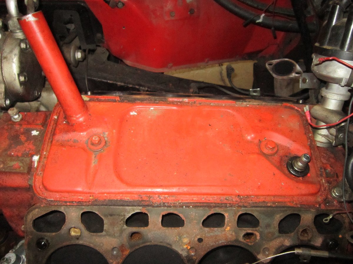

    So that's what it looks like! Back in the early 70's I bought a 2 x 4's intake. Never got to use it due to not having that valley cover.
