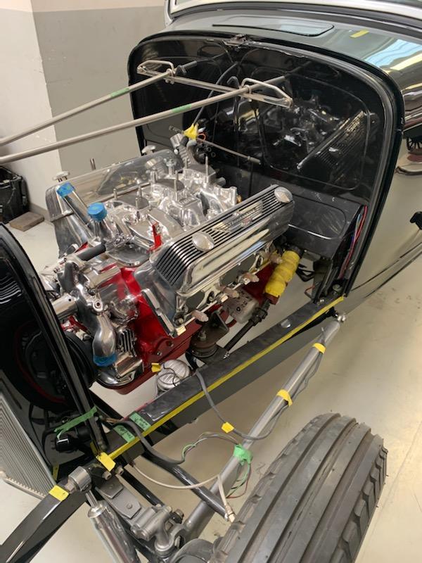

    ABDAAAAB-9D44-4598-9005-EF254FD1FB30.jpeg CA594011-F7BE-4519-B98B-5C1CC2A66661.jpeg B96C753F-8241-4529-937E-04BC3412328F.jpeg CA4D2CED-6DFF-45BD-A23D-CF21474A204F.jpeg Hoping to make the Y Block guys proud!
