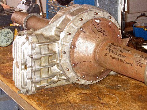

    Where did you get those adapters for the Champ to 40 bells ? I like the better than the ones I have.

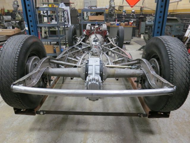

    I used a Rodsville version of the Halibrand V8 with '40 bells and '50 Mercury ends, axles and brakes in my '27 roadster,
    'got a couple thousand pain free miles on it so far..
    it's one of the parts I just had to have in it.
    here is the ch***is coming together last summer.

    The ribbed adapter plates are C.A.E. They are fairly rare. These may be repopped in the future. The center section in that photo is a Halibrand.
