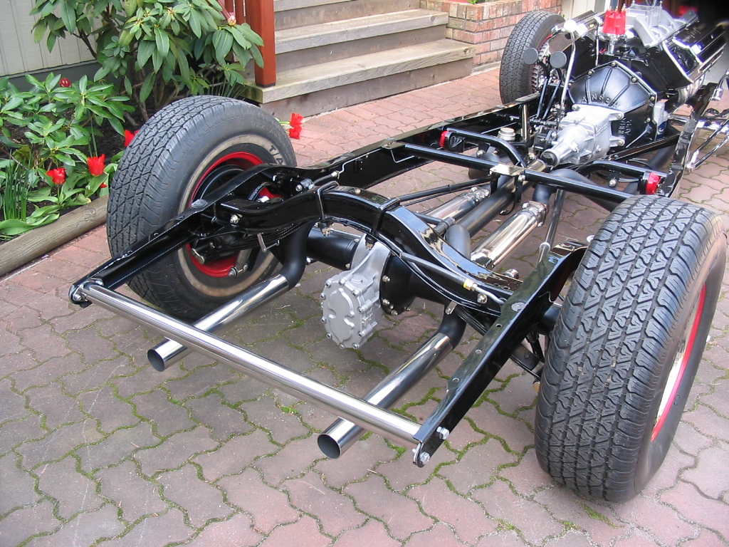

    Quickchanges look good under most any car, but are especially at home under Track Roadsters, being race inspired. The one in the photo is an 11 bolt Halibrand Champ, with steel 3/4 ton truck housings. I built the car for a customer, and after 2 years it was ready to take him for a ride. I had a bucket of change gears (hand me down race parts), and selected a ratio and installed them. We headed down the road, it howled something awful, we could hardly hear each other talking. My only prior experience was with V-8 units and I was plenty nervous, thinking are Champs this loud ? I installed a new set of helical cut gears, problem solved. He has approaching 25,000 mi on it, with no complaints. P1010040.JPG

    Back in the day, when nothing was "harmful to our health", they packed the change gears with white lead to quiet them.

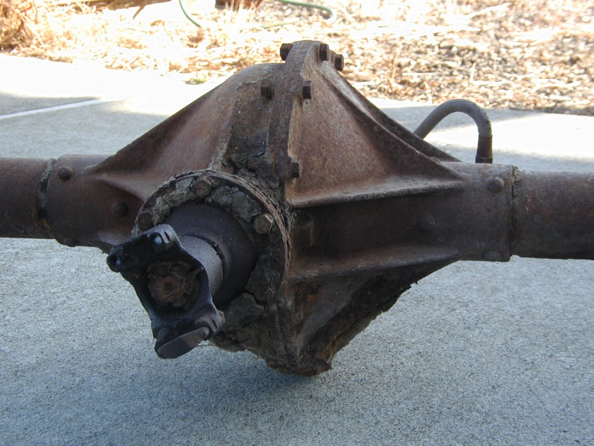

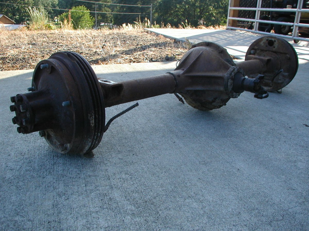

    This is the critter, we call it a "split in the middle". P1010155.JPG P1010156.JPG

    That thing looks pretty bulletproof. What gear ratios did they come stock with? How much wider than a stock banjo were they?

    Gary, the two ratios for Champ rears are 4.11 & 4.86. I would bet the Timken pictured would be 4.86.
  28. Speedwrench
    Joined: Nov 21, 2009
    Posts: 1,032
    Speedwrench
    I'm seeing that Winters is also offering a 4:57 R&P option. Not sure where that came from. I'm thinking that 4:86 is that preferred ratio today.
    I'm a little out of touch on my sprint car technology, but when I was active everyone used 4:11.
