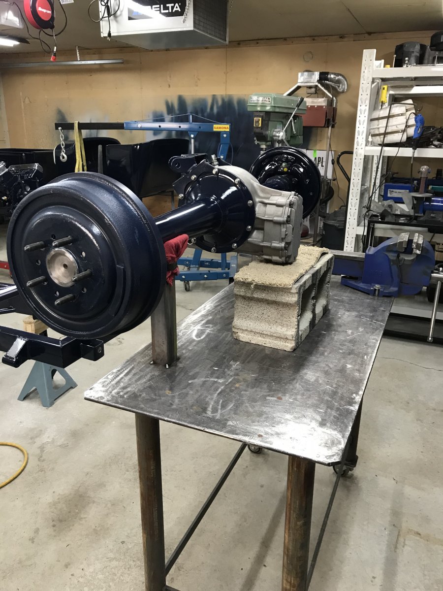

    Did someone say quickchange ? :D
    It’s now painted and in the ch***is.:cool:
    DC2EF673-5A30-4C51-8933-26A6015DF2D5.jpeg C3F9BA2F-D54A-441F-BA98-C0B67A86CCDB.jpeg ECF636E2-E1FA-4A95-B849-F5A555D716B4.jpeg 7689A391-9F62-44EC-A437-15D2EF23A881.jpeg 173A4EB8-89A6-4052-AAD5-822B71FB0F00.jpeg 18127F13-DC76-40EF-BB0D-59B61C979216.jpeg

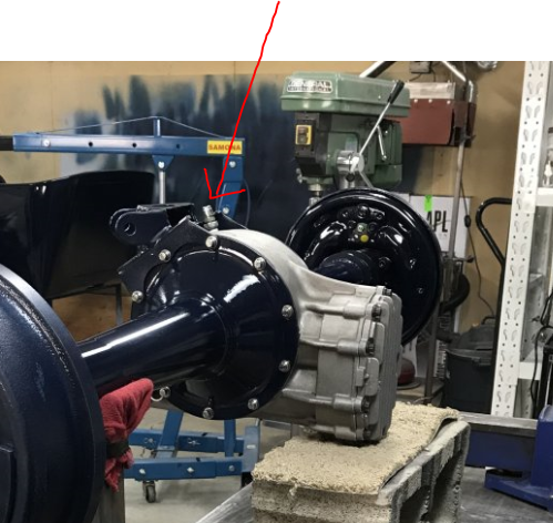

    I have a call into Winters Performance but ill ask here as well (this is where all the smart kids hang out). While I was painting my axle tubes the other night I noticed I don't have a vent. That can't be right.
    I see on Blueone's post above this thingymajig
    Is that a vent? I have a threaded plug up there.

    We had something that looked like that on our 9-inch at Bonneville. I'd guess that it was a factory vent. After every run, the rear of our roadster was coated with grease. We ran a rubber tube up into the top of the rear deck and affixed a small K&N filter to it. Problem solved. I guess the grease would get all up to the filter and not go thru it and eventually run back down. Never made a mess.

    That's a Mopar rear axle vent adapted to a reducing bushing that I made to replace the fill plug.
    I'm hoping that it will vent without leaking oil. I think it should work fine.

    Ideally, the vent would be on the side bell to avoid having the ring gear throw axle grease at it.
    I have seen them vented just about everywhere, including the main case, change gear cavity, and axle tubes. Occasionally more than one. It doesn't take much, but as Stan Back said, a long tube with a filter at the end seems to always work.
    On race cars we use the tube with a funnel at the end. This makes refilling after a gear change easy peasey. A filter cloth (rag) in the funnel keeps the skutz and fugs out! :D

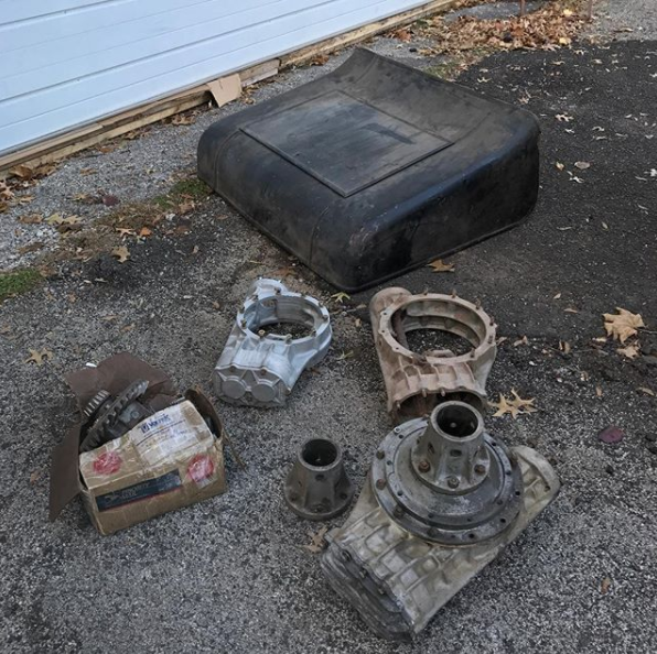

    My little haul from yesterday. Been wanting a 201 for my roadster project since day one and glad to have gotten an affordable start on one. I got a big box of gears and parts with these, but was curious if the QC gears are interchangeable (or what parts in general are) between the 301 and 201's? I plan to keep at the least the 201 and might save one of the 301's and sell one on, but don't want to shoot myself in the foot by selling something I may need.
    Outback and rod1 like this.
  30. GearheadsQCE
    Joined: Mar 23, 2011
    Posts: 3,670
    GearheadsQCE
    Alliance Vendor
    Virtually nothing from the 301 will fit a 201.
    I'd like to see the axle tube adapter on that 301 a little closer. I knew that these existed but have never had one.
    Looks like good stuff.
