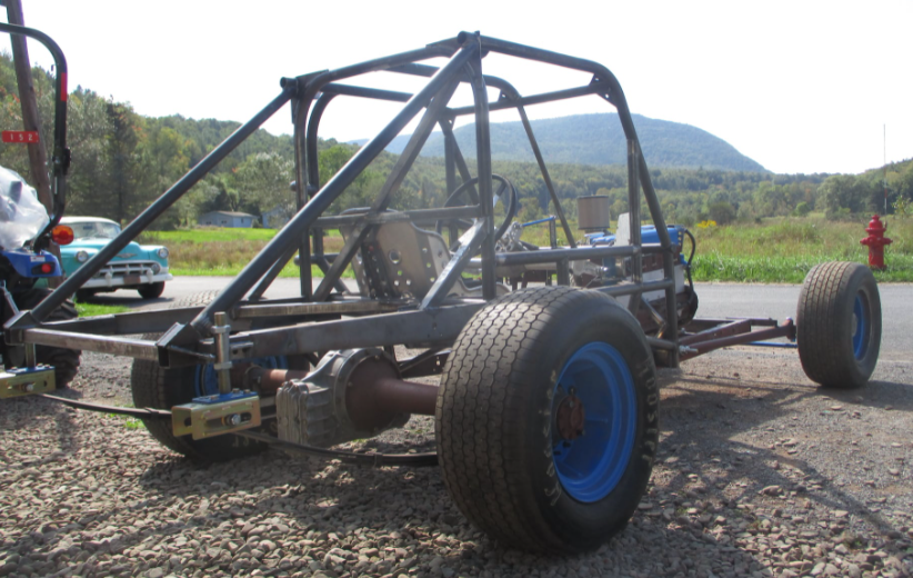

    My grandson likes his!

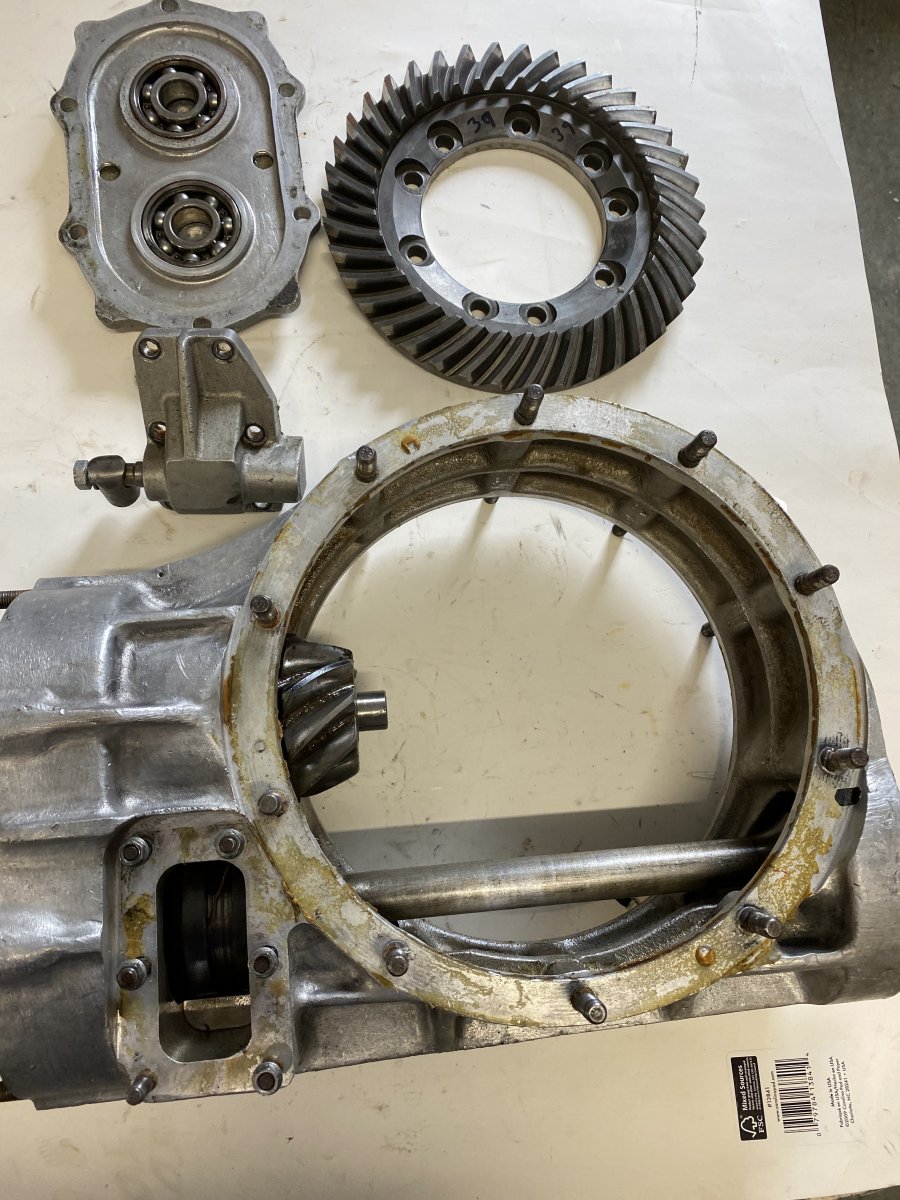

    GearheadsQCE

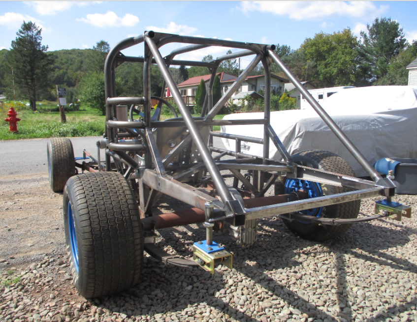

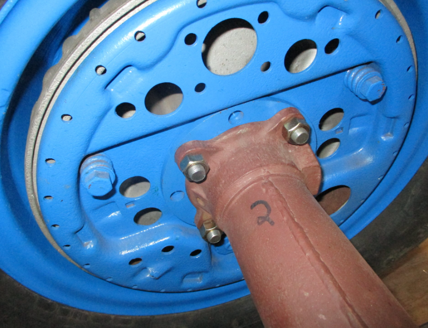

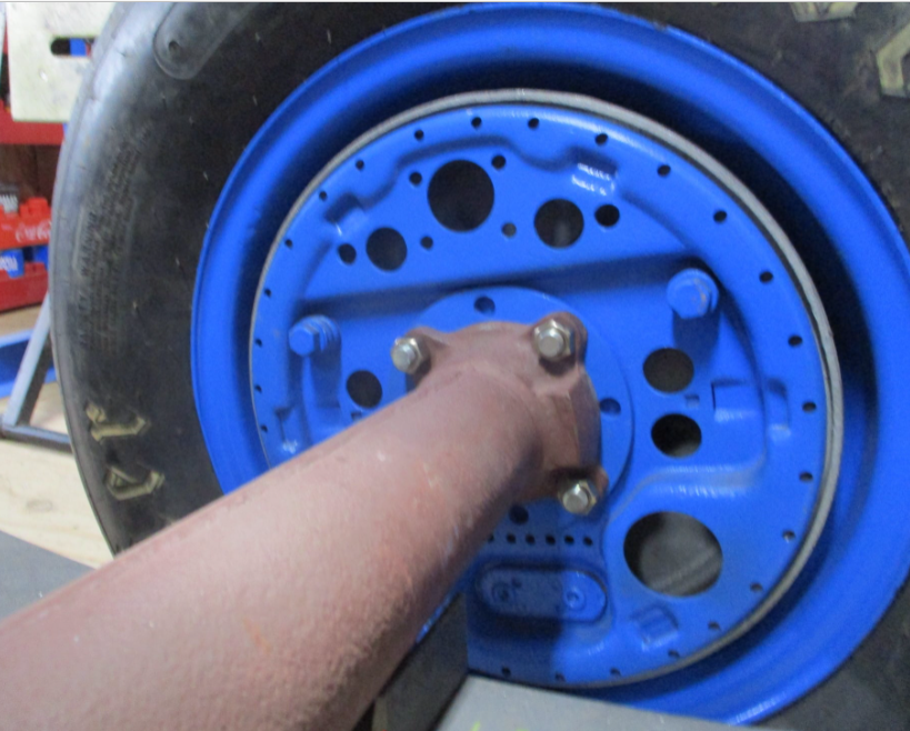

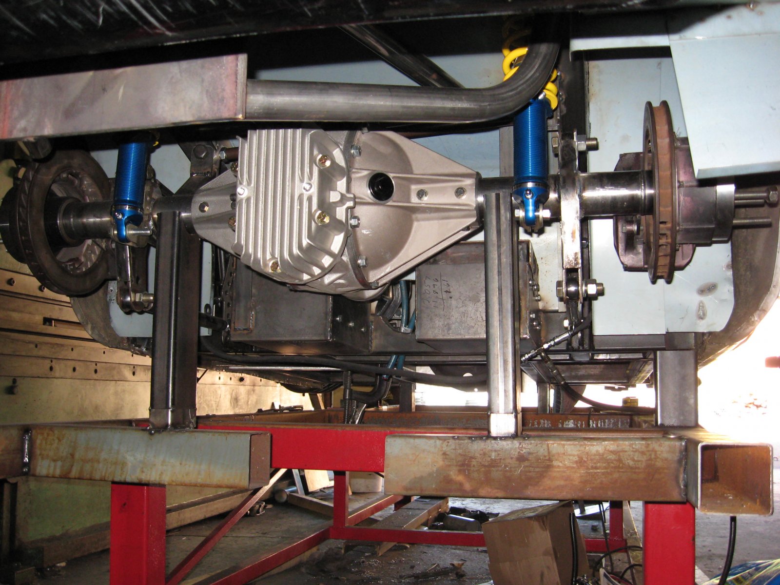

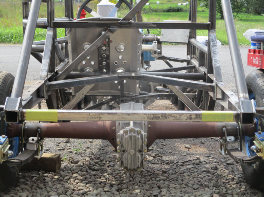

  16. My Haliband Champ under the ch***is (built form 3 model A frames) note spring mounts are only tacked to make it a roller for a vintage racecar show
    upload_2021-10-30_9-57-22.png upload_2021-10-30_9-59-23.png upload_2021-10-30_10-1-44.png upload_2021-10-30_10-5-1.png upload_2021-10-30_10-9-31.png

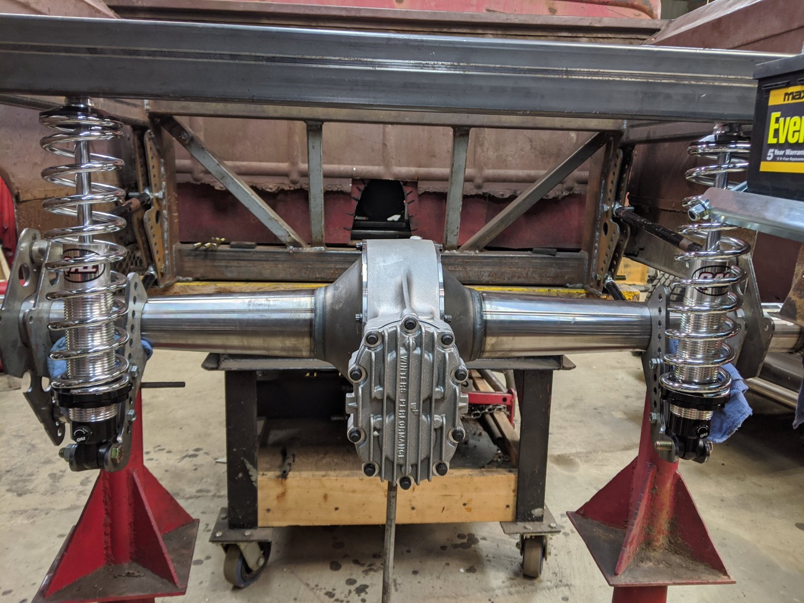

  24. 300racr
    Joined: Apr 1, 2008
    Posts: 580
    300racr
    from Phoenix,Az
    Just picked this up today. Frankland Champ qc.Got it and a few sets of gears ,will be going under my next project. 20211222_140452.jpg

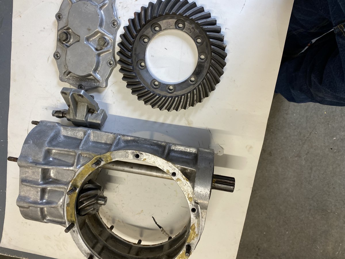

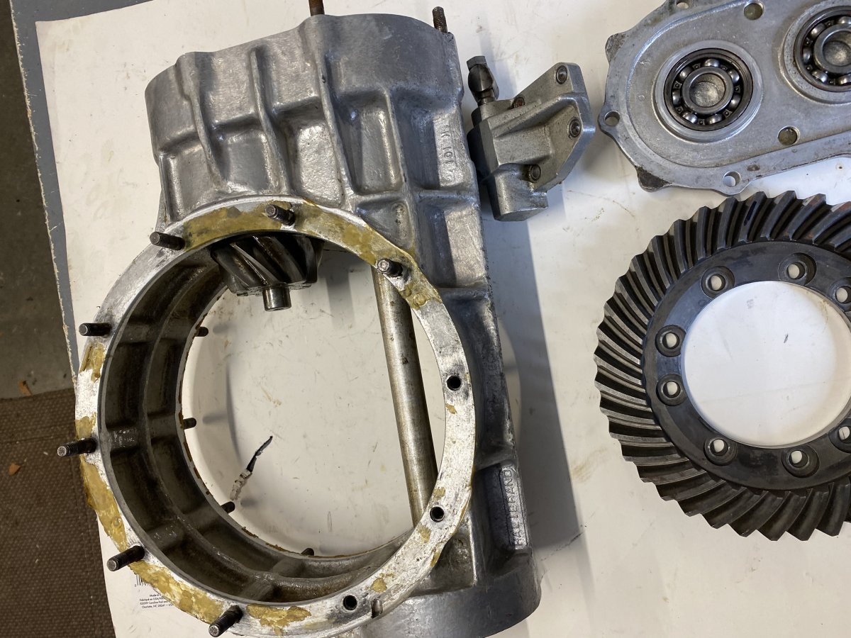

    I have this Halibrand 101 that I’m putting in my ‘29 Banger. It has the linkage for an in&out. Does anyone have any ideas on how to address installing a shifter? I’d like to keep it to disengage while flat towing.
    9FB7CB01-87E3-49E6-BA73-7808CCA9C548.jpeg 39991B38-F71E-45E5-9DBC-0D69CEF746FF.jpeg 8B69FB37-4AB9-4702-8AF6-9397D03D3CA8.jpeg
    Outback, stillrunners and loudbang like this.
  28. jaracer
    Joined: Oct 4, 2008
    Posts: 3,046
    jaracer
    The last sprint car I drove had a push/pull cable installed on the shifter. That's about as simple as it gets.
