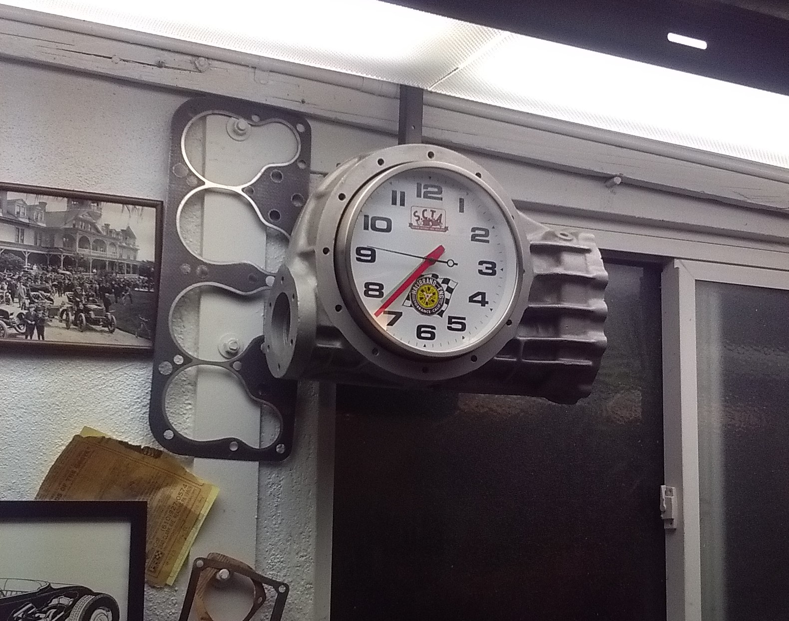

    When they are too blown up to run, ya just need to find a new use for them!!

    Only time will tell.

  20. Time moves faster in a Quickie . . .

    Day light saving time-quick change!
