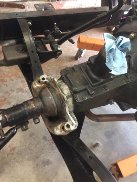

    Stabbed the motor in and something isn't right. Either my yoke on the trans isn't letting the torque tube slide in all the way, or I forgot to mockup everything with that center socket piece...either way I'm going to mess with it this week after work and figure out what I need to do.

    Are you running a stock A rear end? I am not sure but isn't the torque tube that works on the back of the V8 transmission different than an A torque tube? Could that be part of your issue with things not fitting together right? I don't know for sure but I thought they were different. Looking good and I cant wait to see this car in person. I liked seeing it last fall. I have been following along since you started this swap. Are you going to make the Dirt drags or the Hill Climb?
  19. Post your question and picture on fordbarn. You might be OK but it has been many years since I looked closely at that part of the car.
    Charlie Stephens
  20. So things are looking up. My good buddy Bryan from Deluxe was nice enough to help me solve my new problem.

  21. We made (correction...he made) a 5" sleeve with about .001 of interference for a nice tight fit. Had to heat it up to even get it on. Material from the driveshaft and torque tube was removed and faced with his lathe and mill to make sure everything was square
