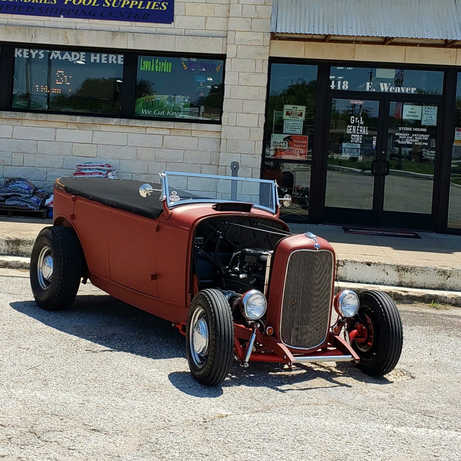

    The tub is finally done and the red '30 that was supposed to be a quick fix 'n' flip turned into a two year project...but it's almost completed so it's time for The Arin Cee Roadster project to re-start. (Arin will be thrilled...!)

  12. missysdad1
    Joined: Dec 9, 2008
    Posts: 3,307
    missysdad1
    Thanks! It's my daily beater. It was originally ***embled by Bob Perreault and except for removing the top and hood it still looks pretty much as it did when he had it, but it is vastly improved under the tin...'er, gl***. It has taken me a couple of years to get it sorted out the way I like it. For example, I've replaced the engine, transmission, exhaust, rear gears, steering column, front seat and interior, headlights, wiring, shifter, floors, got rid of the hu****ous long-haul oversize gas tank while also adding the hot water heater from a '47 Plymouth under the dash. And, the rear seat has been removed and replaced by an area designed to hold the clothing, tools, cleaning supplies, folding chair, cooler, etc. in an orderly fashion while leaving lots of room for groceries, parts or whatever I'm hauling on a particular day. In addition to groceries, I have hauled lumber, paint, thinner drums, plumbing supplies, dog food, rusty junkyard bits and even a transmission back there on occasion. So, even though it's a hot rod I use it more like a truck. Thanks again for the kind words.

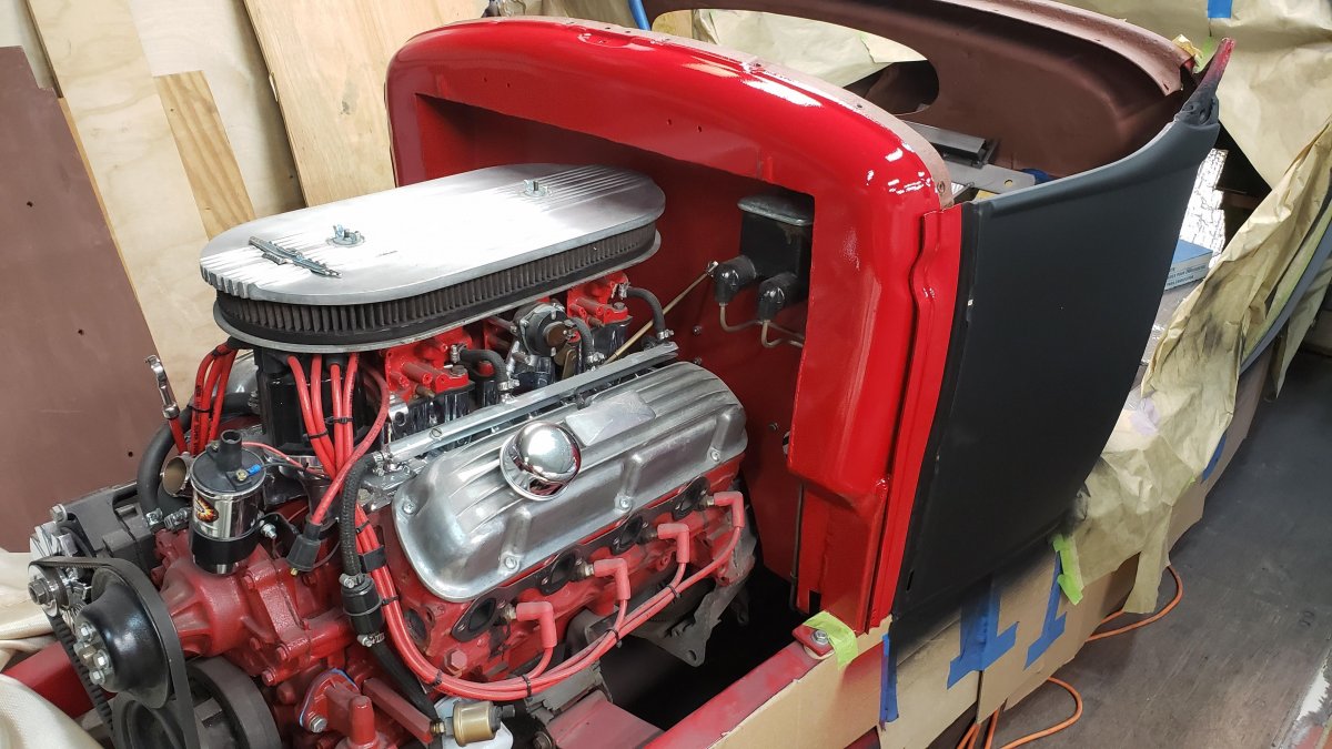

    Back to business...
    This is more or less where the Arin Cee Roadster is today as far as build progress is concerned. You can go back over the previous 10 pages of progress reports to fill in the details. The most important aspect is that this is not going to be a "modern" build in terms of details.
    It will sit higher than most current hot rods and will be un-trendy to the max. But I will let you in on a little-seen-today proportional "gimmick" that you'd never see unless I mentioned it. Study the photo of the radiator shell/headlight and see if you can pick it out before I explain it...

    Well, okay then, it's time to get back to business on Arin's roadster. These photos were taken yesterday, after making a major effort to clear away the clutter and find all the parts which had become ****tered over the last few months. I did a light inventory, and while I was at it I changed the details of the concept just a tiny bit. More to come on this as time goes on...
    Arin's roadster is at the rear of the shop while the recently-completed red '31 is closer to the front along with my beater '32 tub.
    A little dusty but none the worse for wear, Arin's '29 is further along than I'd remembered.
    It's almost all old-school and will remain that way during the remainder of the build.
    The ch***is is done and plumbed and all the sheet metal is fitted. So, next on the agenda is getting it running and repairing the body panels. Onward...

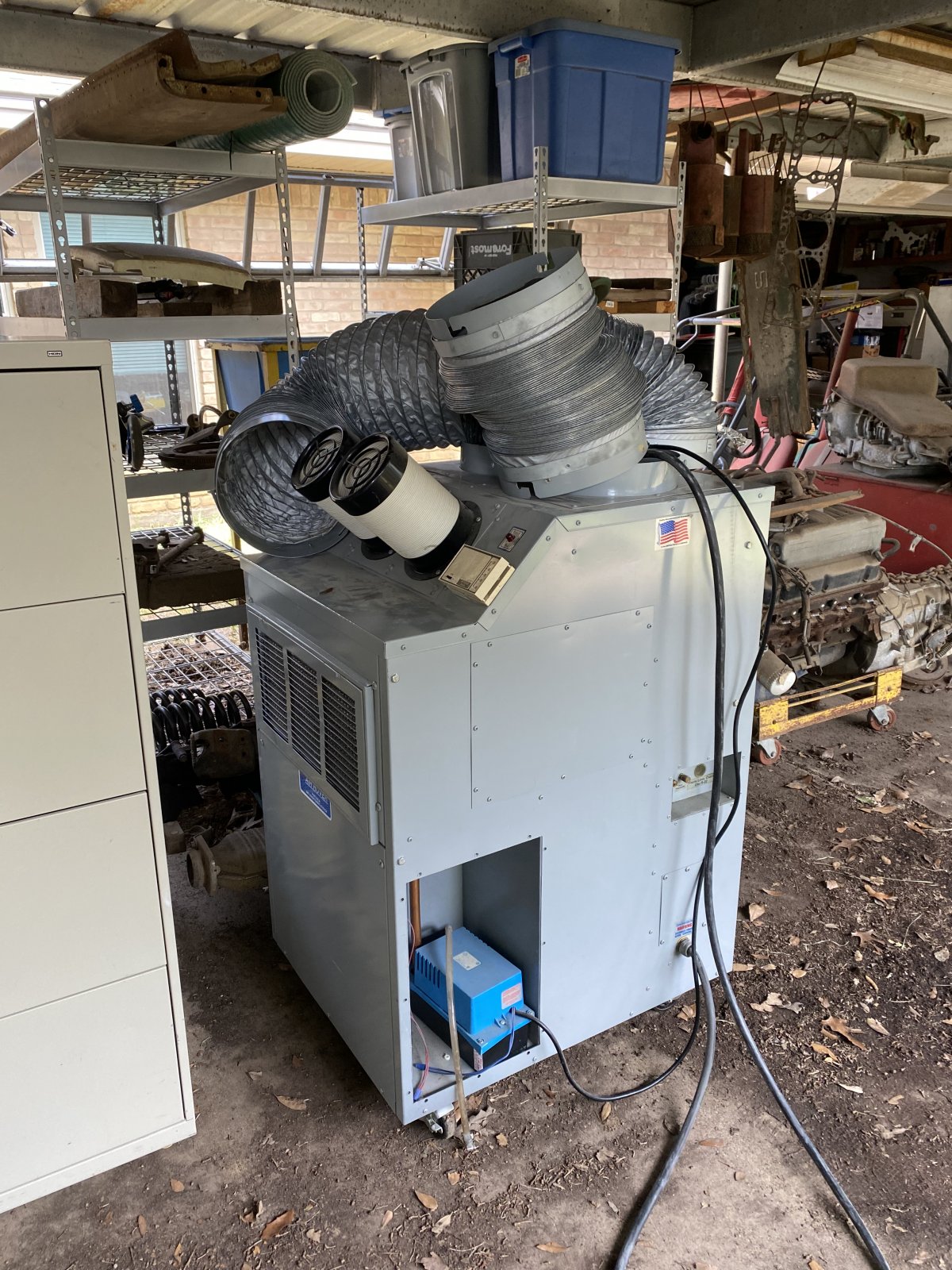

    Eric I hope you figured a way to cool that place you need one of these. AIR ROVER portable AC .Frank 8C153F43-D9CF-4A4E-829F-B1315B6E4E89.jpeg

    Hi Frank! Yep, it's not exactly chilly but it's workable inside the shop at this point. I got the two A/C units working as they should and it's not bad, even today when it's 95* outside. I'm just now working on getting the motor ready to start up and have been fiddling with the Corvette dual-point distributor you gave me. Looks like it's going to be a drop-in-and-go part. Thanks again!
