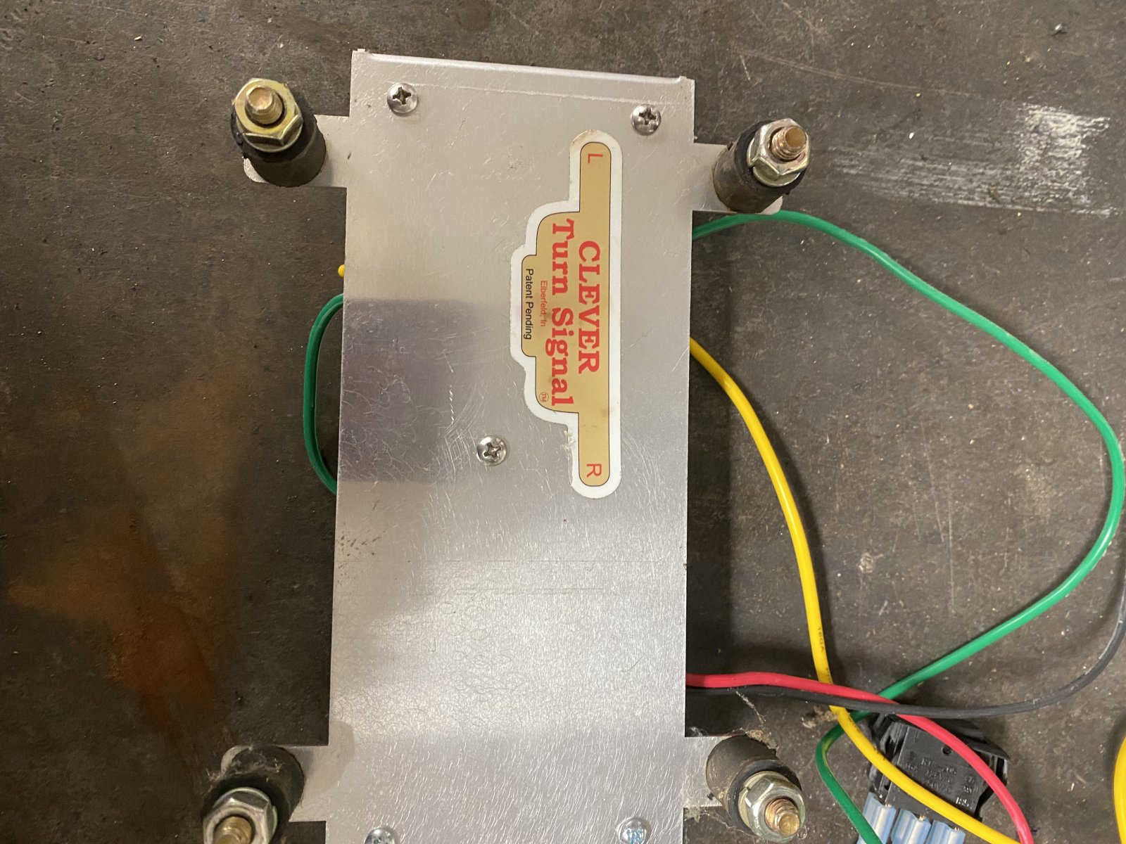

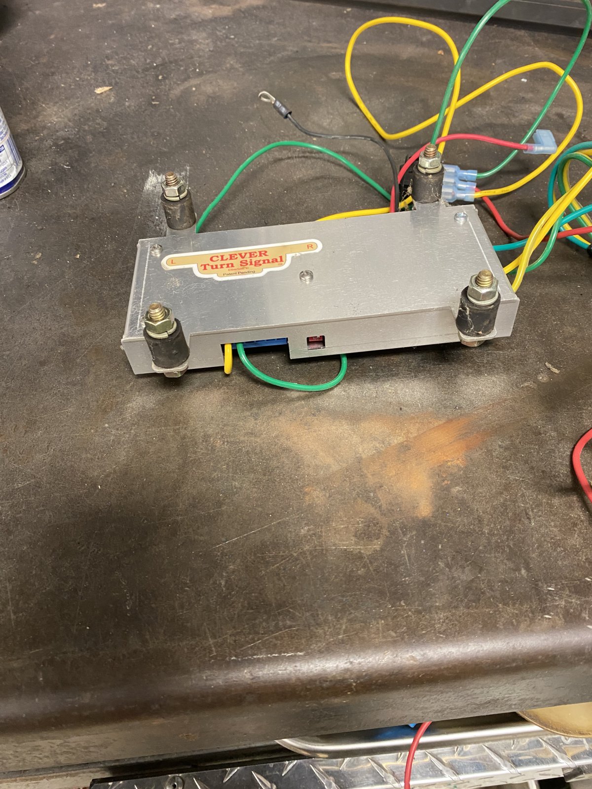

    Eric they make a self canceling turn signal that’s mounts under the dash and all you need is a rocker switch to activate it it’s about 4x6 and about 1 in. tall PM me if you are interested in it . That way you can keep it off the column for a more traditional look. Frank

  14. 1-SHOT
    Joined: Sep 23, 2014
    Posts: 2,908
    1-SHOT
    from Denton
    Eric I believe this is a motorcycle accessory. I got mine on Evil Pay Frank DF2F65FF-9F4D-4A68-980B-964CB120C184.jpeg 6D7473F0-D984-4C28-839C-20B3AC7E0212.jpeg 7A2CF073-52CA-41EB-B058-C1D0761CCA69.jpeg
