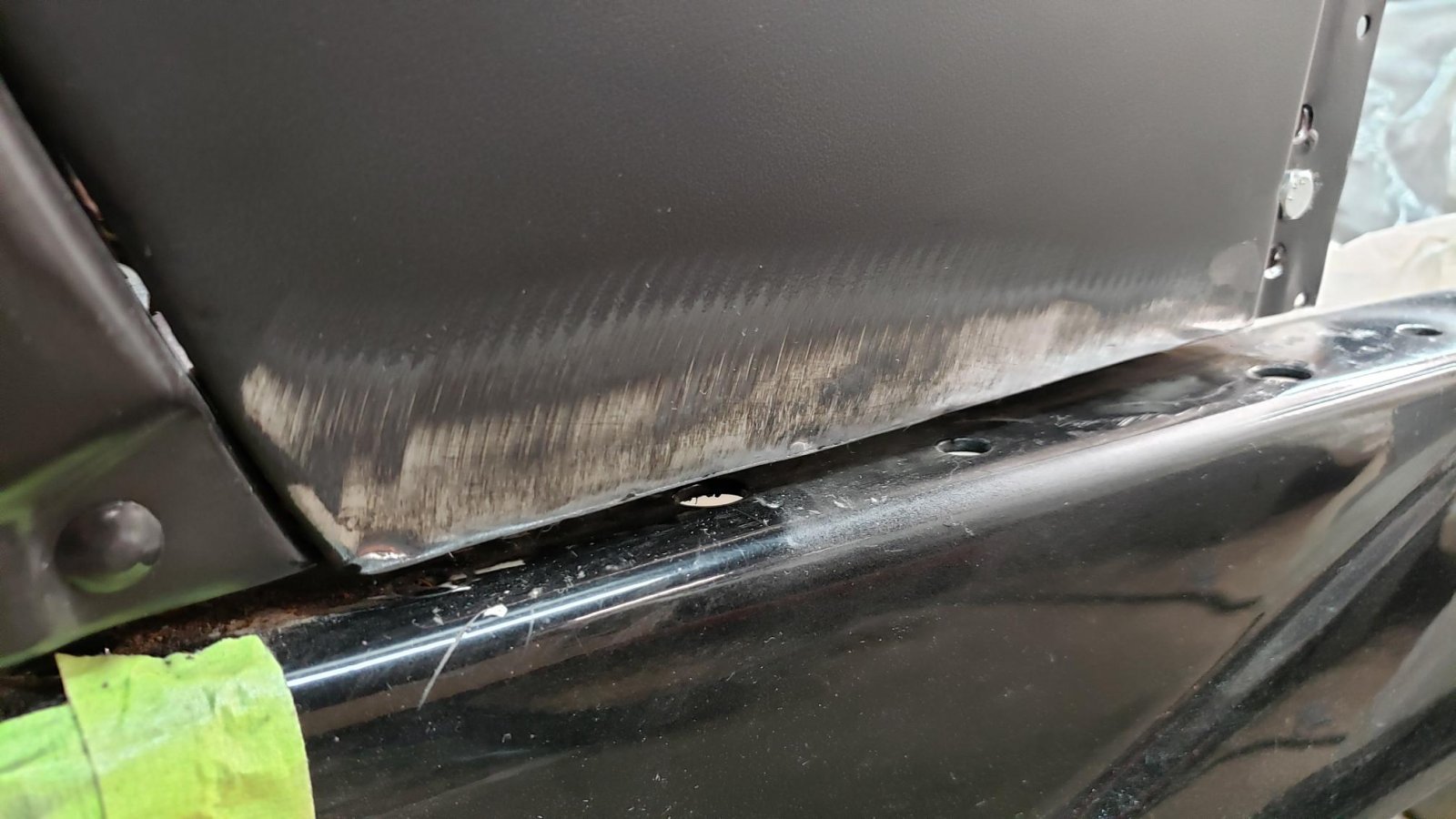

    I covered the welding of the repair panels a couple of posts ago. The next step was to apply a thin coat of body filler to the welded areas in order to blend them into the surrounding surfaces. I had welded up and metal-finished several other areas on the body as well. These got body filler also.
    The next step was to apply Direct-To-Metal Primer to the bodyworked areas to lock everything down and give a really good base for everything to come. I used Eastwood brand DTM material - two-part 50/50 mixture ratio - in black because the final color will be dark. Even in hot weather this material takes several days to set up, but when it does it really grips the metal and bonds very well to epoxy primers, both regular and high-build.
    As I discovered with my previous build, the red '31 roadster, the body metal MUST be very, very clean in order for DTM to bond properly. This means scrubbing it with hot soapy water twice, rinsing well between washes. Once it's dry the metal is given a careful application of DX-330, PrepSol or some other quality wax and grease remover and wiped dry before allowing it to evaporate for at least 15 minutes. The reason is that some contaminants are oil soluable and some are water soluable. You need to eliminate both, and that means a two-stage cleaning process. With that done I gave the body two fairly heavy coats of DTM. Won't be ready to sand for a week or so.

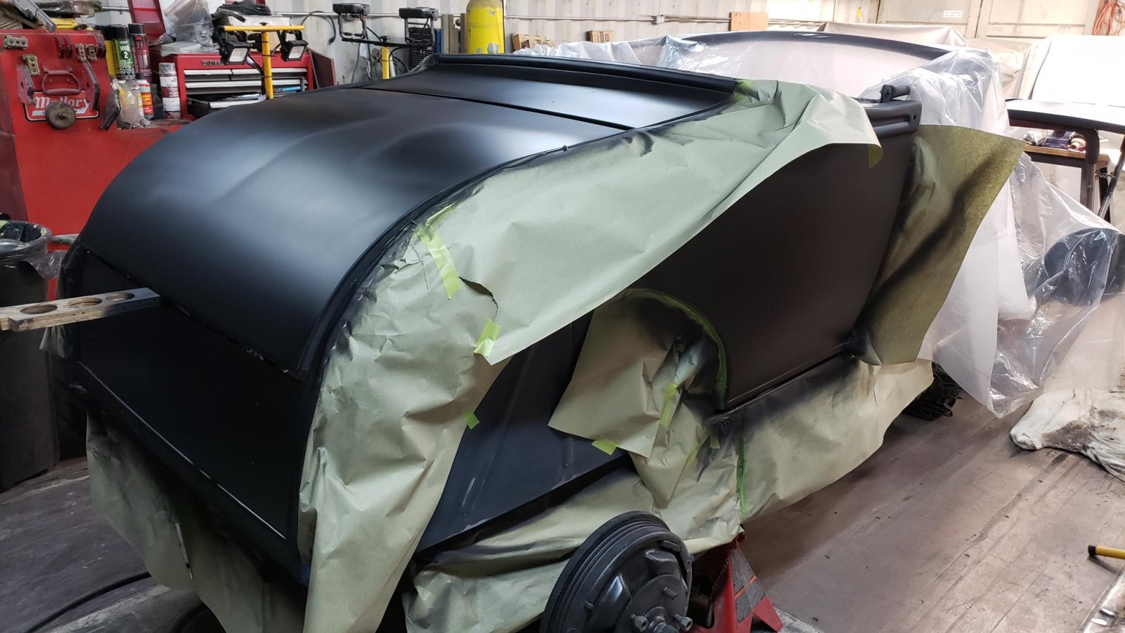

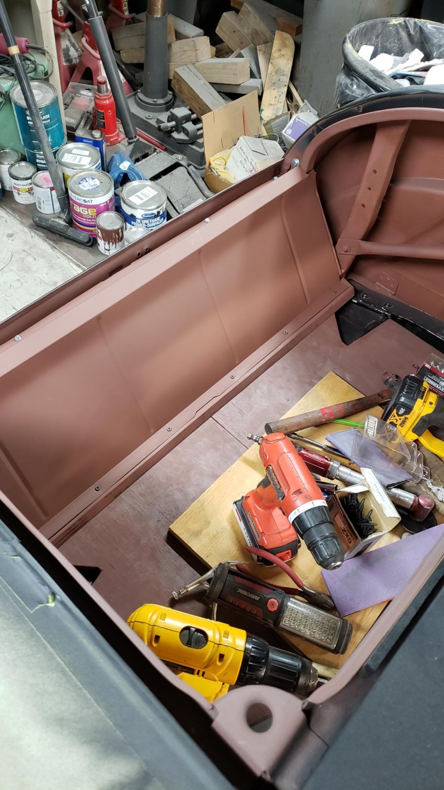

    More progress...in no particular order.
    Since the Arin Cee Roadster has been converted to a trunk-style roadster from a rumble seat-style car, a different rear trunk panel was necessary and had to be adapted to fit this body style at the same time. This took a little head-scratching, especially since the floor is no longer original, but I got it done.
    Some parts of the body took very little high-fill primer while other parts took a whole lot. To save material which has become very expensive in today's economy I masked off the different panels and applied amounts of primer appropriate to the needs.
    Prime. Block. Prime some more. Block some more. Repeat...
