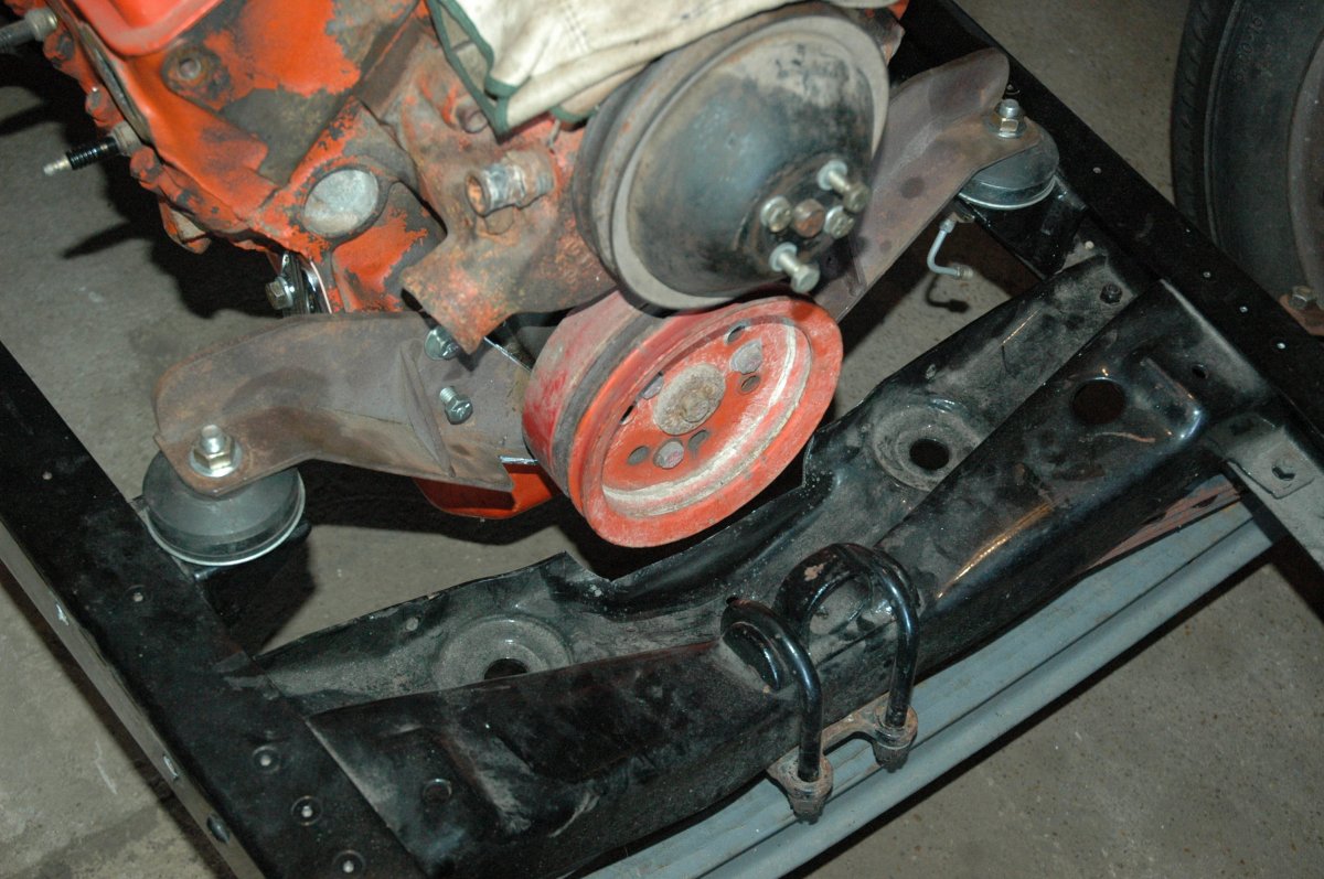

    Okay, a couple more hours stolen from work in order to make more progress on the roadster. Stupid stuff, really, but things that must be done before I get going on more complicated and artistic things.
    The motor has to sit where it's going to be in the frame before anything else which attaches to it can be done. So today I did the painful cutting of the original '32 front cross member to allow front pulley clearance. Yes, I could have raised the front of the motor a couple inches to get this clearance but there are a lot of unintended negative consequences to doing that so I just prayed for forgiveness and made the cut. Then it snugged right down on the biscuits and all was good...even the distributor clearance was right on the money.

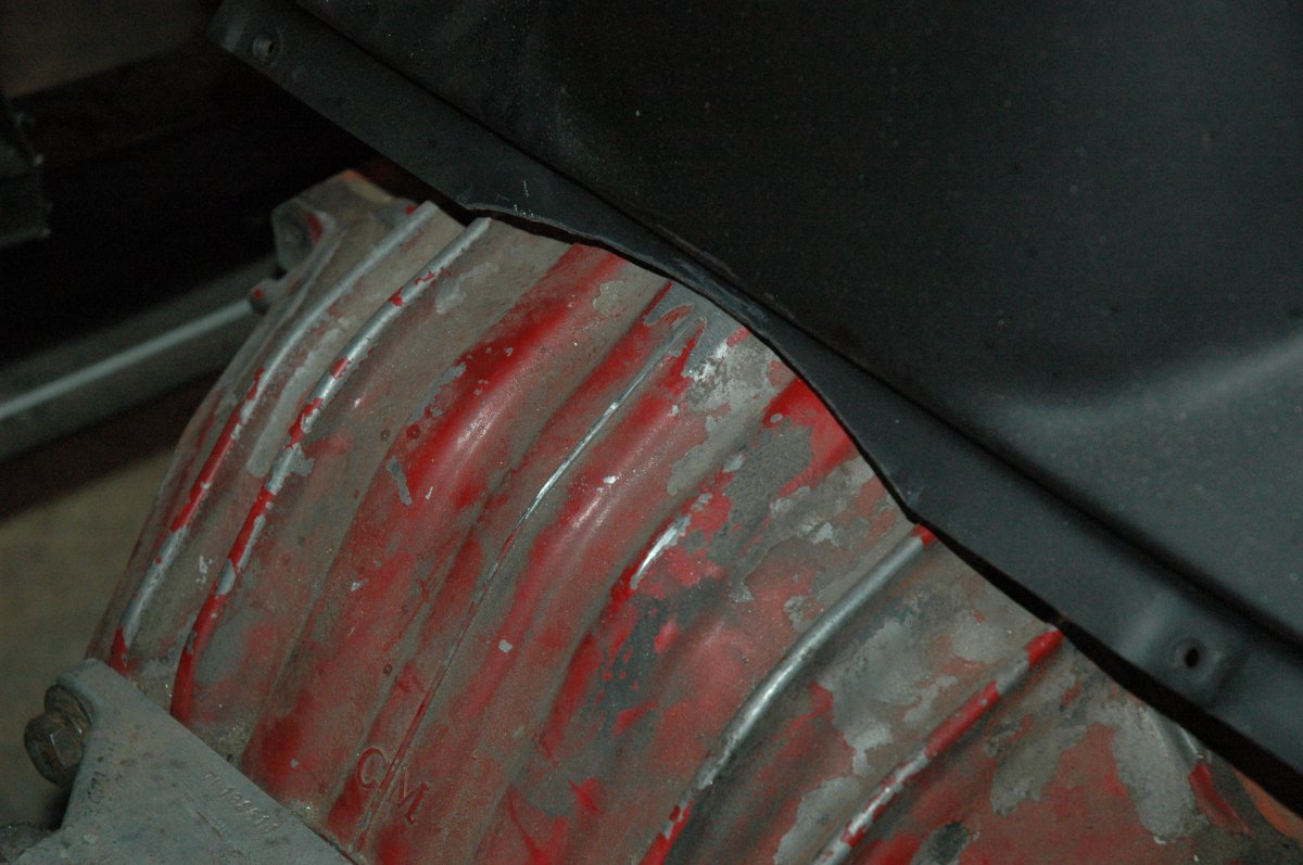

    Getting the body down where it belongs was next. I made the cut in the toe board support to clear the bell housing - not really a big cut, but necessary. And then I trimmed the body around the rumble lid hinges to clear the frame rail stubs in the rear. The body had already been modified by the previous owner so not much was required to get it to sit down properly in the back. Now that its sitting properly I can cut the previous owner's rear floor work out and replace the subrails and floor properly.
    Yes, I'm aware that the body will come up a little bit when I put the new subrails and floor from Steadfast Manufacturing into the body and shim the body as required for proper frame fit, but what I did today will make the body fit nicely for now. It'll fit even better a little higher when all that stuff is in place.

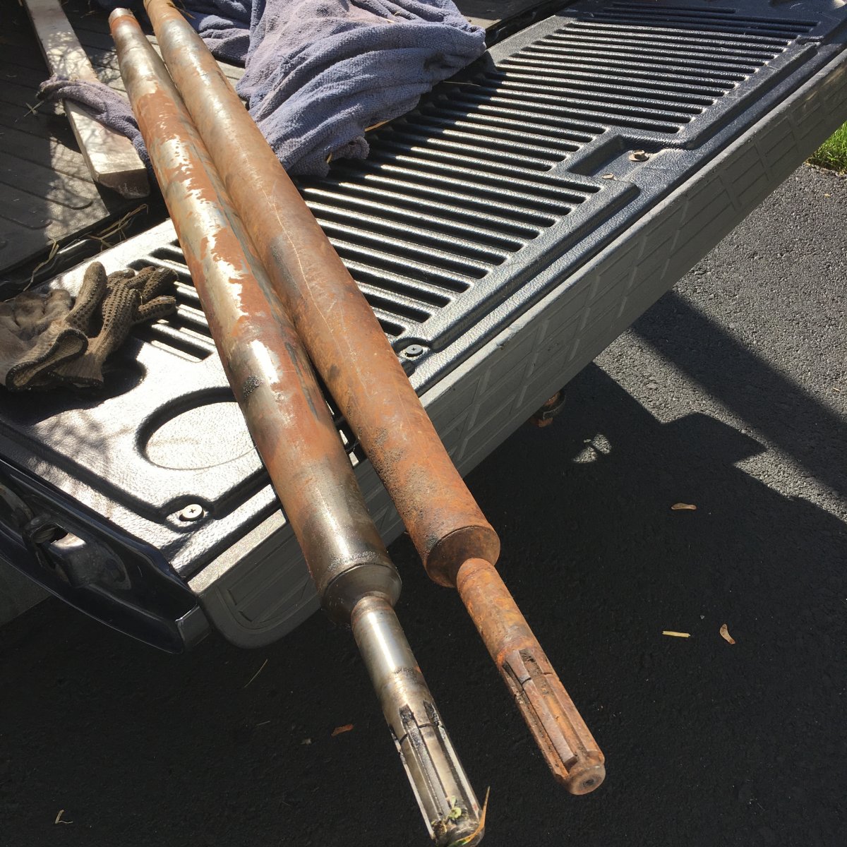

    Then, to build the lakes-style under-car pipes, HAMBer Josh came through with a pair of '36 drive shaft tubes which will be used pretty much full length with motorcycle baffles.

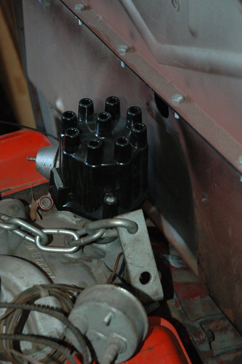

    This evening my friend Frank - known as 1-SHOT here on the H.A.M.B. - calls up and tells me he's in the neighborhood and can he come by? Sure, says I.
    Next thing I know he's shoving this mint early Corvette dual-point distributor into my grimy mitt, telling me it will be much better off as part of my roadster than sitting on the shelf of his shop. And he won't take a dime for it.
    So, what can I say but "Thank you, Frank!" This is the one part I really didn't think I'd ever find to put the finishing touch on my faux '55 Corvette engine. It's perfect!

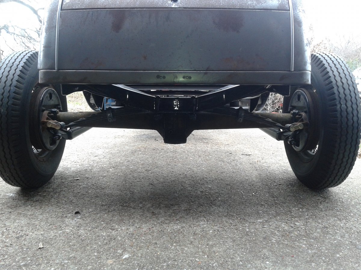

    Okay, I finally got the custom-made Posie's rear spring installed...after much wrestling and cursing.
    Once I got the spring to fit up inside the stock '32 rear crossmember I had to compress it in order for the Pete & Jake's shackles to fit. With virtually no weight on the rear of the car this proved problematic until I figured out that a pair of large C-clamps would work. Sorry, no pictures, but I put the clamps on the top of the rear crossmember as far outward as possible and under the spring and cranked 'em to compress the spring. Worked like a champ with zero danger.
    With Posie's Super Slide lowering springs now on both ends the car sits at exactly the stance I wanted. Late '40s hot rods still sat quite high, but dropped axles were becoming available so many were noticeably lower than stock. My car will sit slightly lower when it's finished as a function of weight being added. It will also have a slightly steeper rake to the front once the big 'n' little tires have been installed. Should be "just right" in a historical context...

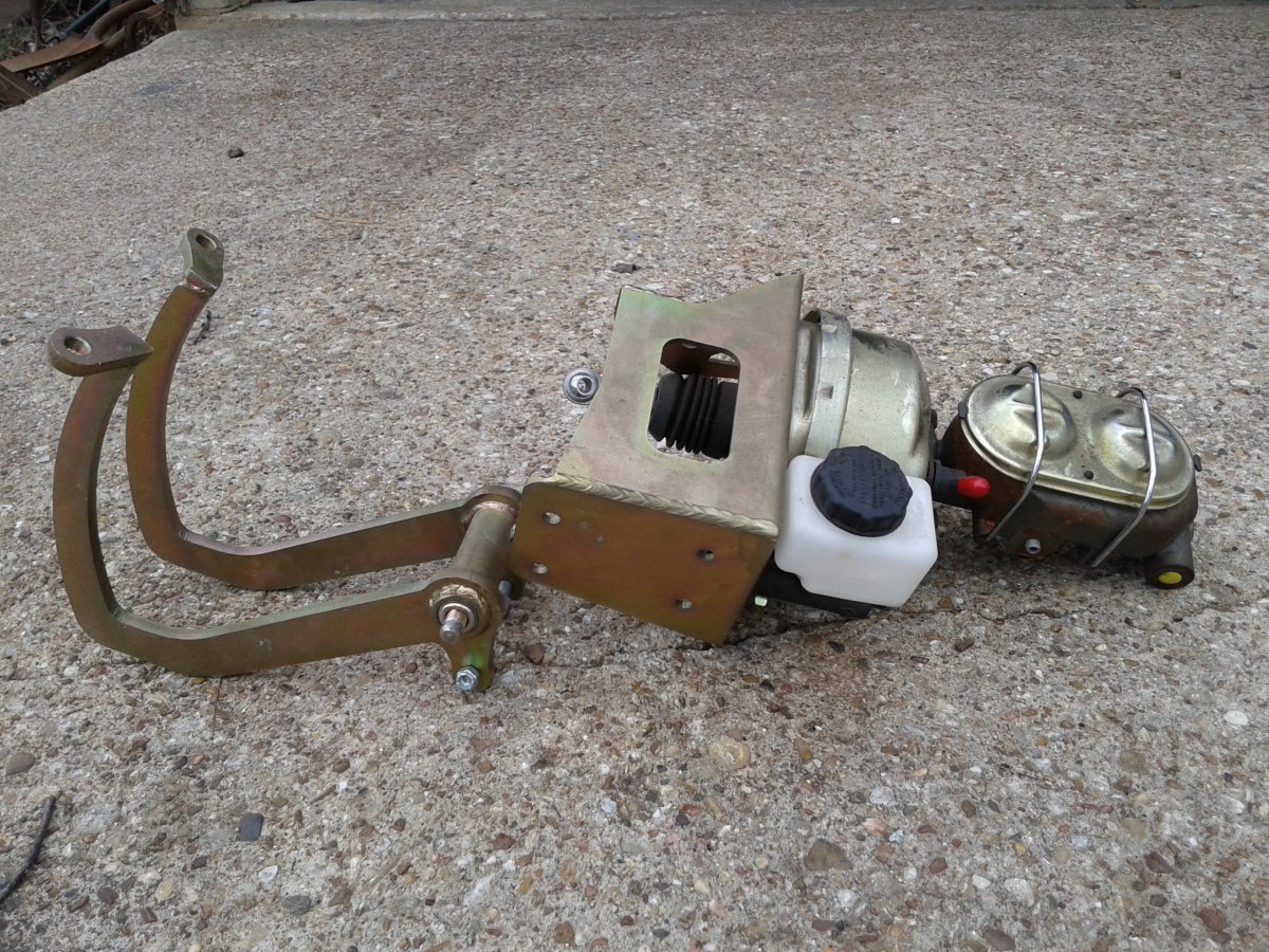

    Next order of business seemed to be adding the pedals for brake and clutch. I have a firewall-mounted set of swinging pedals which use a Chevy pickup dual master cylinder, but these would be out of place on a post-war hot rod - too new. So, I decided to utilize the mount already attached to the frame (see photo) and just find the brake/clutch ***embly that bolts too it. It will be under the floor so won't detract from the early flavor of the car.
    Didn't take long to find one, new-old-stock but shelf-worn, on eBay. Good price, great seller, and arrived just a few days later. Nice part, as advertised. One eeensy-weeensy little problem: The bracket is too low on the frame so the master cylinder and booster tangle with the crossmember. And, if that wasn't enough, the bracket also mounts the master cylinder and booster too far to the center so they tangle with the Hurst Compe***ion Plus linkage on the Muncie 4-speed. Unh-oh...
    So...the next order of business is to cut the bracket off, shorten the legs and remount it higher. Looks like that'll take care of the problem...I think.
