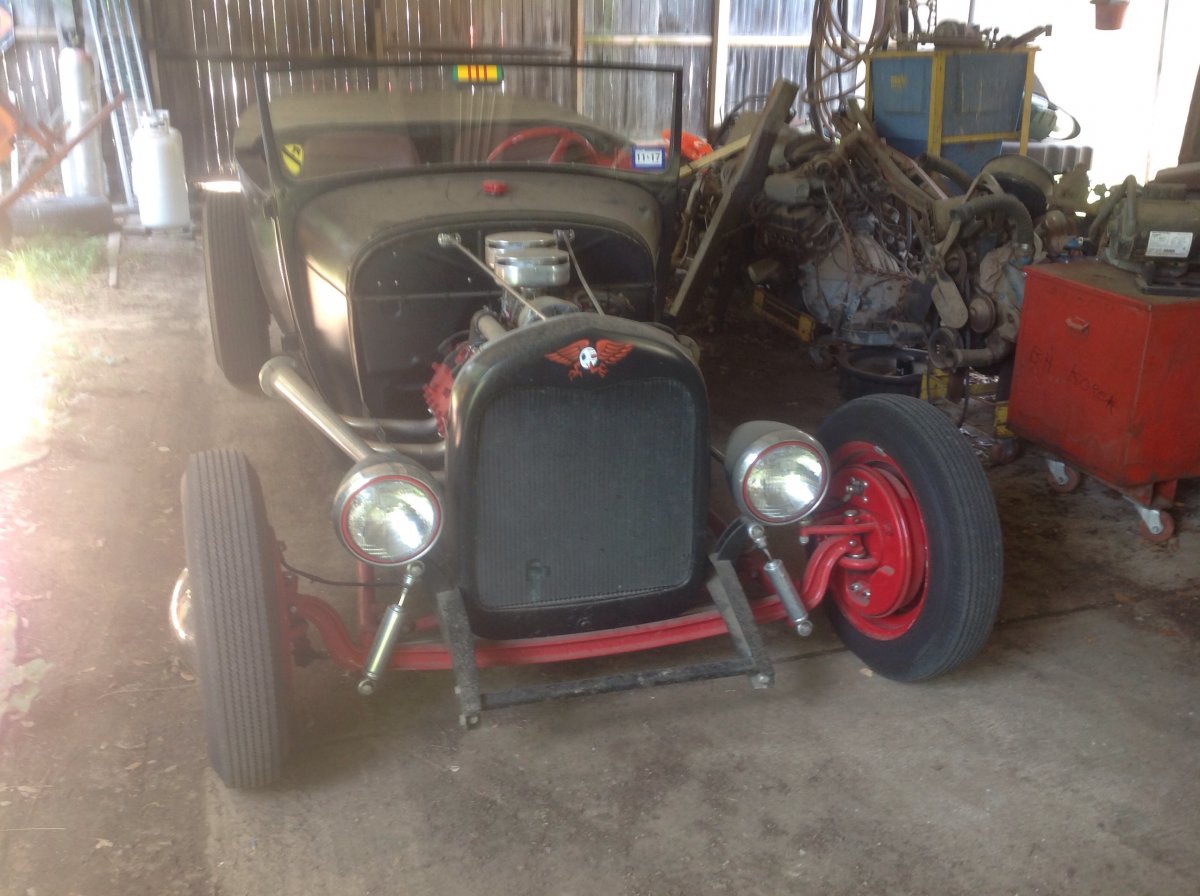

    The next step is to get the proportions right. Getting the front and rear suspensions in place to set the all-important "stance" was first, and that part's pretty much done. I've got some roller wheels/tires on the car that are close to the ones I'll eventually use so the "stagger" is pretty much like it's gonna be. Now comes the hard part, figuring out where to put the radiator.
    Lots of folks have put forth their opinions as to how this "should" be done, but most involve a Deuce grille shell...which is NOT where I'm going with this car. Instead, I plan to use a stock '28-'29 radiator shell with a one-piece hood top, much as was done on some SCTA and CRA roadsters back when they were doing dual duty and had to meet the safety rules for both kinds of racing.
    Good friend Chip (need louvers ? is his handle here on the HAMB) of Hot Rod Central Louver Co. said that in his experience there's only one way to get it right: mock it up, then step back and see how it looks. Repeat until it looks "right". Then order a custom radiator to suit.
    Good advice, I think, so that's what I spent my morning doing today...
    (Geez, I'm going to have to rattle can that grille shell black to cut the glare and bring it back to visual balance. It looks huge!)

    And no, before anybody asks, I still haven't decided what to do about the early hot rod I stumbled my way into. Right now I'm leaning towards switching bodies, keeping the gennie body for the Arin Cee Roadster, and putting the Brookville body onto the banger ch***is and letting it go to a new home. We'll just have to see how it goes...

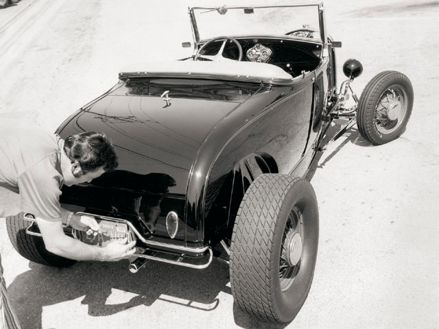

    Thanks, Marcus. I saw Bud's car for the first time at the Detroit Street Rod Nationals a very long time ago - 1972 to be exact - and shot the s**t with Bud as he cleaned all his rubber with lacquer thinner from a baby food bottle! I liked it then and like it now, but it's not on my list because it's just not "old timey" enough for me. Nice car, don't get me wrong, but it's a little too cliche and not really what I'm looking for. I am interested in how he treated his radiator however and, since there's a wealth of photos of it on the internet, I will study them closely and see what I can learn. Thanks for the nudge!

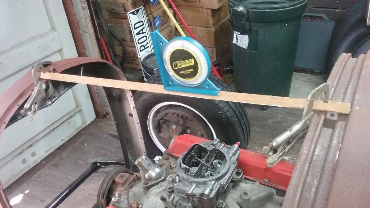

    In the meantime I took my angle-finder and compared the hood angle on the Arin Cee Roadster to that of the old stock-bodied car I found, using the door tops as a constant index/reference point. Looks like they are on the same plane on the stocker and a negative 2 degrees to the front on the Arin Cee car as it's currently mocked up. This will give me a great reference, but I"m still anxious to hear from others who have used this combination of parts and hear how they did it. Frank is going to send some photos of his tub which has really great proportions, so we'll see where it goes from here.
