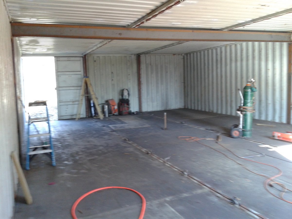

    When I started this thread I was building Arin's roadster in a little cement block shop behind my house, most of the work happening outside because the inside was packed full with just enough room to slide the car in at night. I've always built my stuff this way. It's certainly authentic old school with lots of noteworthy hot rods having been built under the same conditions...or worse.
    But while still making slow progress on Arin's car - with him chewing on my *** to hurry up at every opportunity - I've also been busy moving and, in the process, building my dream shop. It's a little different, crafted from old steel shipping containers, but it's just exactly what I'd hoped it would be. Kevin Taff of Alvarado, Texas, did all the grunt work from building the steel framework on which it sits, welding the three containers together, cutting out the walls, installing overhead beams and even fitting it with lots of 220, perimeter outlets, overhead lights and heavy duty shelving. Thanks, Kevin. It's perfect!

    Definitely more room than you had before, and better lighting.

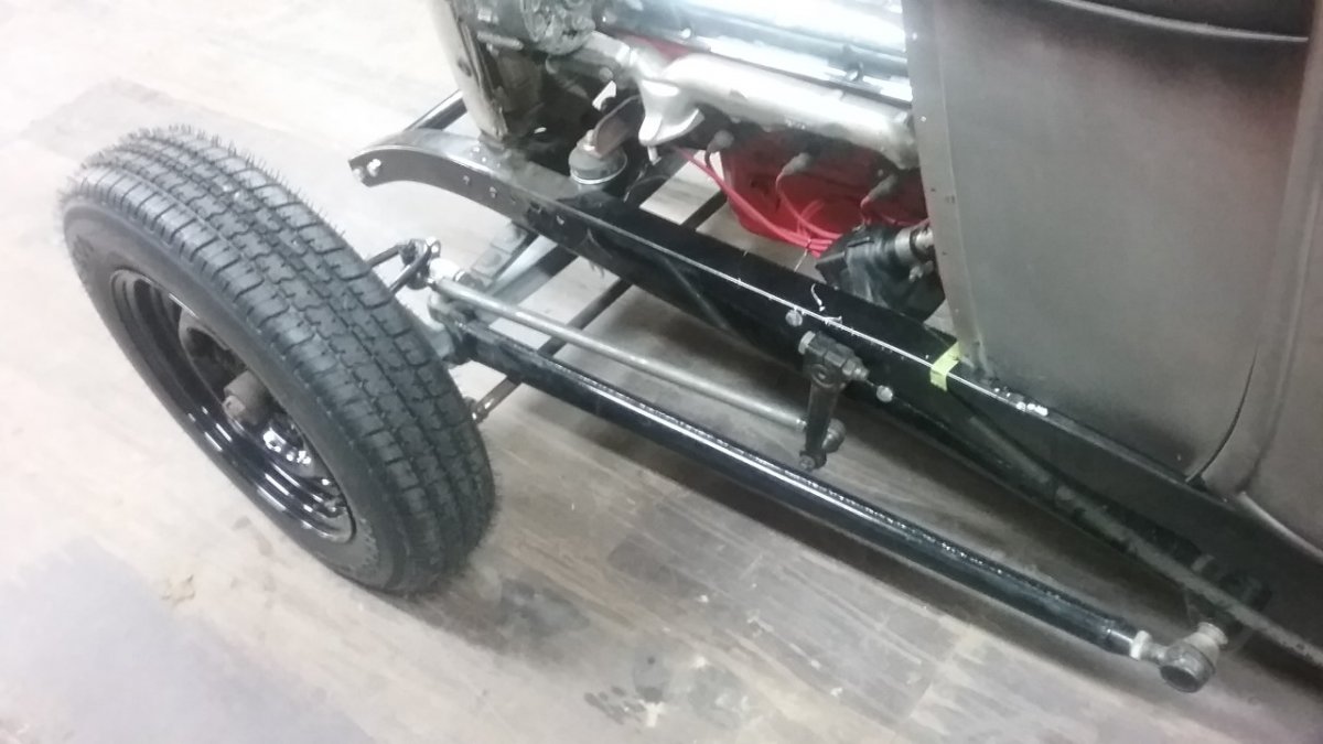

    Baby got new shoes...and a sorely needed tie rod modification and front end alignment. The wheels are real-deal '48 Mercury 15-inch steelies powder coated by Top Koat Powder Coating in Kennedale, Texas. They are actually for the 'banger roadster build, but will do just fine on Arin's roadster until I can afford the 16-inch bias ply Firestones I really want. The drag link should be here in a day or so, as will the steering column drop. One step at a time...

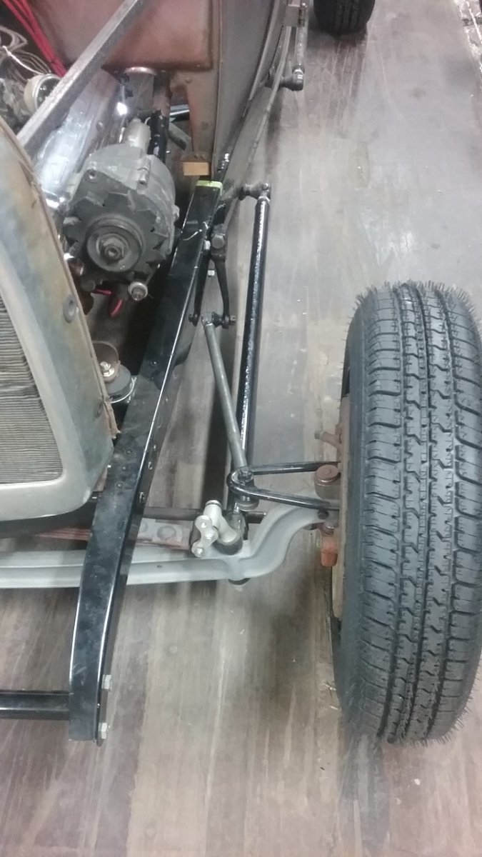

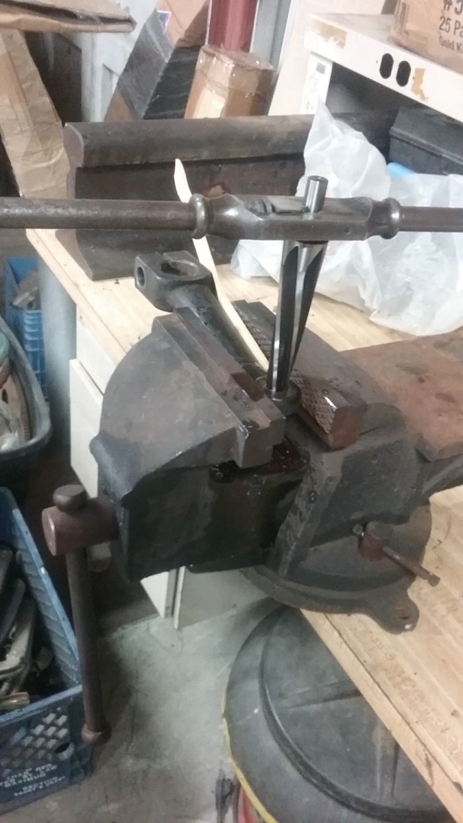

    Good news...and bad news today. The good news is that the Speedway custom-length drag link arrived this afternoon and fit perfectly. I used a Speedway reamer to reverse the taper in the pitman arm to move the tie rod end from the outside to the inside so that the drag link wouldn't tangle with the radius rod. The bad news is that when I went to adjust the steering box I discovered that it was flat worn out...
    new roadster steering 11.jpg new roadster steering 12.jpg new roadster steering 13.jpg
    loudbang and Stogy like this.
