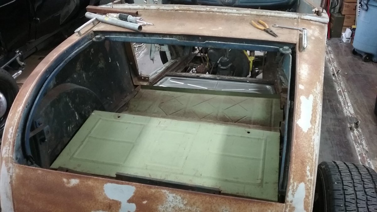

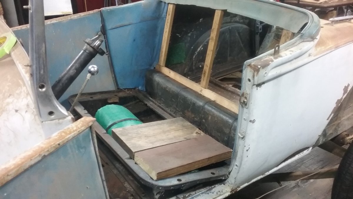

    Between last night and this afternoon I was able to carve enough time out of my schedule to take out the rear rumble seat riser/floor in preparation for cutting the subrails to allow this body to slide down over the Deuce rails. This body has very little rust but all the fasteners holding the floor down were pretty well stuck. But between drilling, cutting and occasional bouts of cussing I was able to get 'em all out. What's left is in pretty doggon nice shape, too bad I'm gonna have to cut up those virginal subrails...

    Not all hot rod building is glamorous, but it's all necessary. Raise your hand if you've ever done this...

  8. missysdad1
    Joined: Dec 9, 2008
    Posts: 3,307
    missysdad1
    Yup, done that too, but the problem with a short me and a tall Model A roadster seat is getting low enough in the car but still tall enough to see over the steering wheel....and be comfortable at the same time.
    Back in the day the trick was to remove the bottom seat springs and stuff cushions into the curtain pan to get the driver lower in the car. I have deduced that sitting on the boards as they are in the photo and leaning back to the rear seat cushion support puts me in a very good position, low enough and with plenty of leg room to be comfortable.
    But...when one factors in the thickness of the upholstery and the steel lumbar support (!) it just doesn't work. So it looks like I'll have to go with a flat floor and look for a seat that will give me the position I want and still not look too new. Any suggestions...?

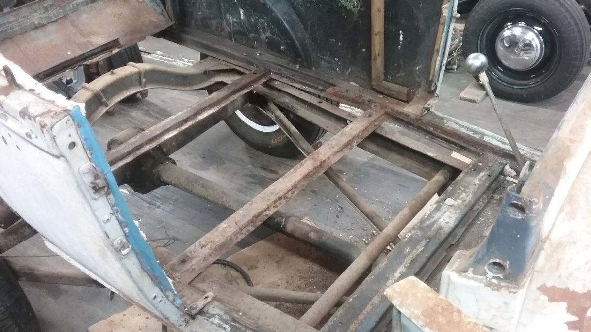

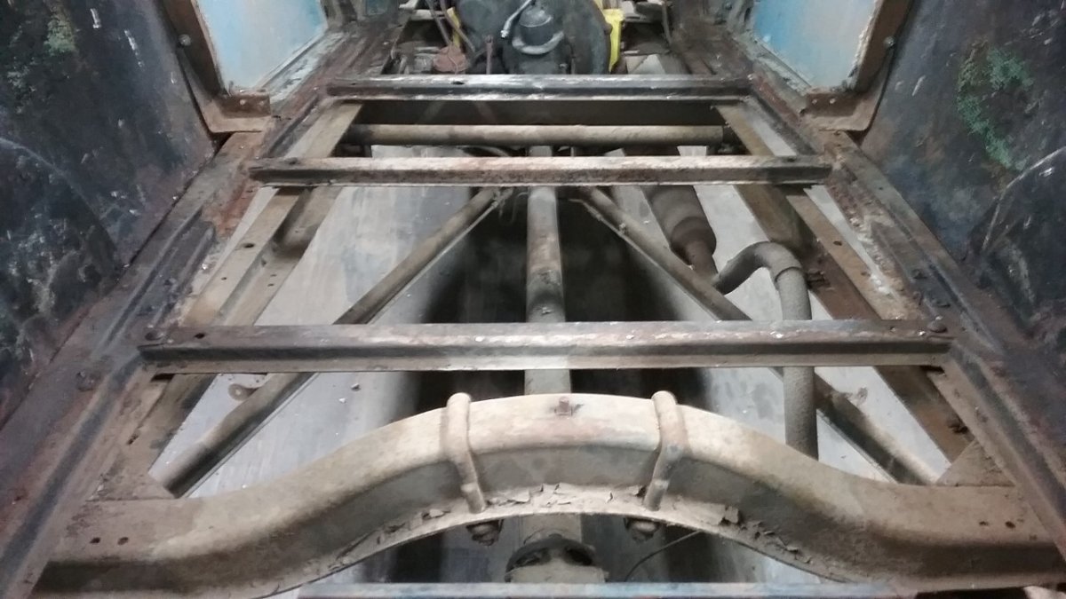

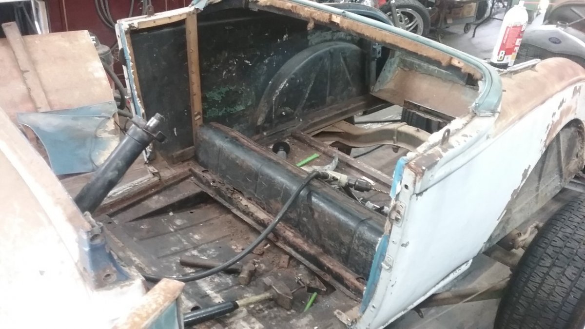

    More dirty work today, removing the floors. The floor pans were somewhat rusty, but any one of them could be saved...if I was inclined to have stock floors...which I'm not. I haven't made up my mind for sure but I think I'll use the primo metal floor pans I got from Matt (Texas Speed) a while back. My other choice would be to use plywood as I did in the coupester which worked out well.
    Next step is to clean up the cross members and sub rails. More dirty work, but nobody ever said that building a hot rod is glamorous...

    As I suspected might be the case, none of the floor pieces I got from Matt will work in this car, with the possible exception of the curved inner rear panel which is unique to rumble seat roadsters. The others are stock floor pieces including the rumble seat riser and rear floor which will be useless once I've butchered the sub rails to accommodate the Deuce frame. Oh, well...anybody need some nice rumble seat roadster floor pieces?
    So, I grabbed some cardboard and made a pattern for the middle floor. I'll use this same technique to make the patterns for the front floor and toe board when I'm ready. I'm using the metal floor piece from the Brookville Roadsters body as the pattern for the forward middle floor. There should be plenty of material in a single sheet of 3/4" marine plywood to make all four pieces. The far rear floor is curved to follow the new frame/ sub rail shape so will be fabricated from sheet metal by rolling it over an empty acetylene bottle. Should be just about right...

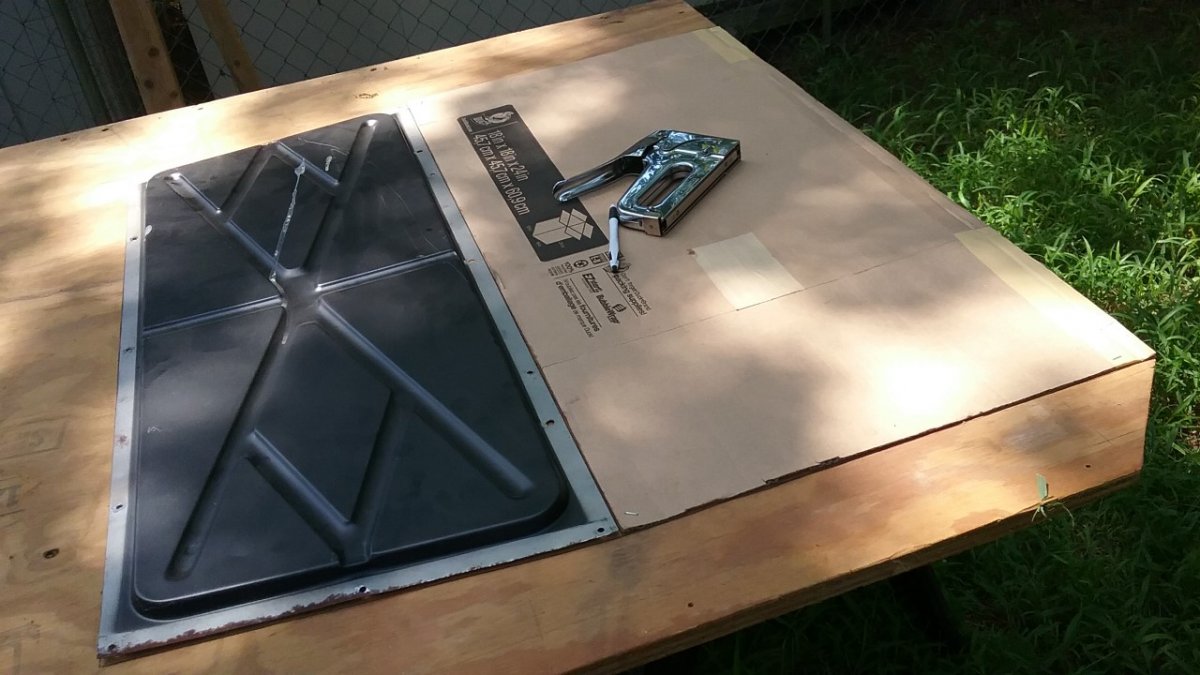

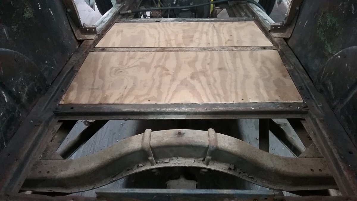

    I didn't plan to, but when I came across an old piece of 3/4" plywood in the back of my shop I decided to spend an hour or so in the Texas heat cutting and fitting the new floor boards. Not a big deal really, but put me yet another step forward towards getting Arin's roadster on the road...

    Nice job Missy floor boards literally....:D...and good grainular line-up. Just thinking the heavy wood, would have built in sound deadening would it not?
    loudbang and missysdad1 like this.
  15. missysdad1
    Joined: Dec 9, 2008
    Posts: 3,307
    missysdad1
    Actually, the weight gain is marginal over the original Model A metal floor pieces. They are pretty doggon heavy! I used plywood for the floors in my coupester which has worked out very well. The front floor and toe board are made of wood in the original Model A construction so using it in the rest of the floor isn't revolutionary, and hot rodders have been doing what I'm doing since forever. The original rivet holes are used along with counter-bored pan head machine screws to make everything nice and neat...and easily removable should the need arise. I suppose the dense wood would give a sound deadening effect, but roadsters are so noisy who'd notice...

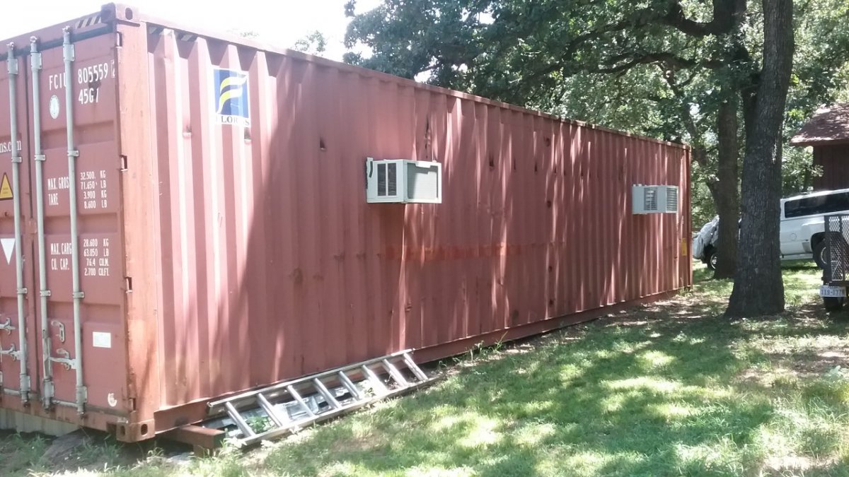

    Just finished putting two air conditioning units into the new shop today. Not enough to cool the place on really hot days, but on days like today - in the mid-90's - it was comfortable enough to work on the roadster with both the new a/c units running at about half speed. Most of the year just opening the big doors at either end and turning on the squirrel cage fan has been enough. I don't think anything will cool it in August though, so maybe I'll just take a vacation and go somewhere cooler until the weather in Texas moderates...

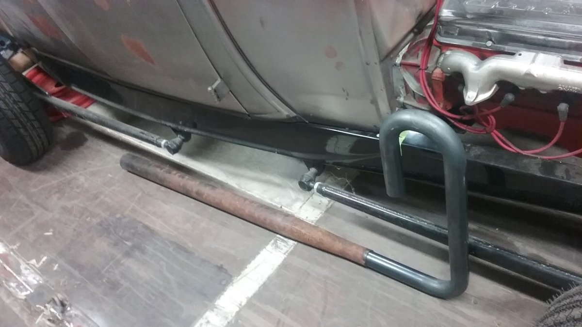

    In keeping with the track/street / lakes roadster flavor of the '40s - '50s hot rods, I decided to run Ford driveshaft tubes as exhaust...under the car, not as headers. This was fairly common for a time, as shown in Don Montgomery's books on early hot rodding. I like the raw look and think I can get used to the sound. I think it'l be quiet enough without dampening, but am prepared to add baffles if it's too loud.
    I got the two '35 - '36 Ford driveshafts from the H.A.M.B. cl***ifieds from a fellow H.A.M.B.er named Josh as I recall for a very reasonable price. So today, armed with an angle grinder with a cut-off wheel and a chop saw similarly modified, I went about beginning the exhaust system by cutting the driveshafts to length.
    Here's a tip: Cut the splined male end first, just behind the weld seam. Cut all the way around, just through the tubing, not all the way across. Then heat the tube to expand it and drive the male splined end IN just to break the bond. Then use a long piece of 3/4" conduit inserted through the other (female) end to drive the male splined end OUT. Much, much easier this way, trust me!
    I then measured the outside diameter of the tube to determine where the taper began and cut the female end off with the chop saw. The overall usable length turned out to be exactly 47". Now, as soon as the 1 3/4" mandrel bends arrive from Speedway I'll continue to build the exhaust.
    Yes, I could have had Joe's Muffler Shop whip up a conventinal exhaust system, and it probably would have been cheaper and certainly would have been quicker. But, as some of you may be discovering, I really am an old school hot rodder. Besides, I promised Arin I'd do his car the way his mentor, Pete Millar, would have done it back in the day...
