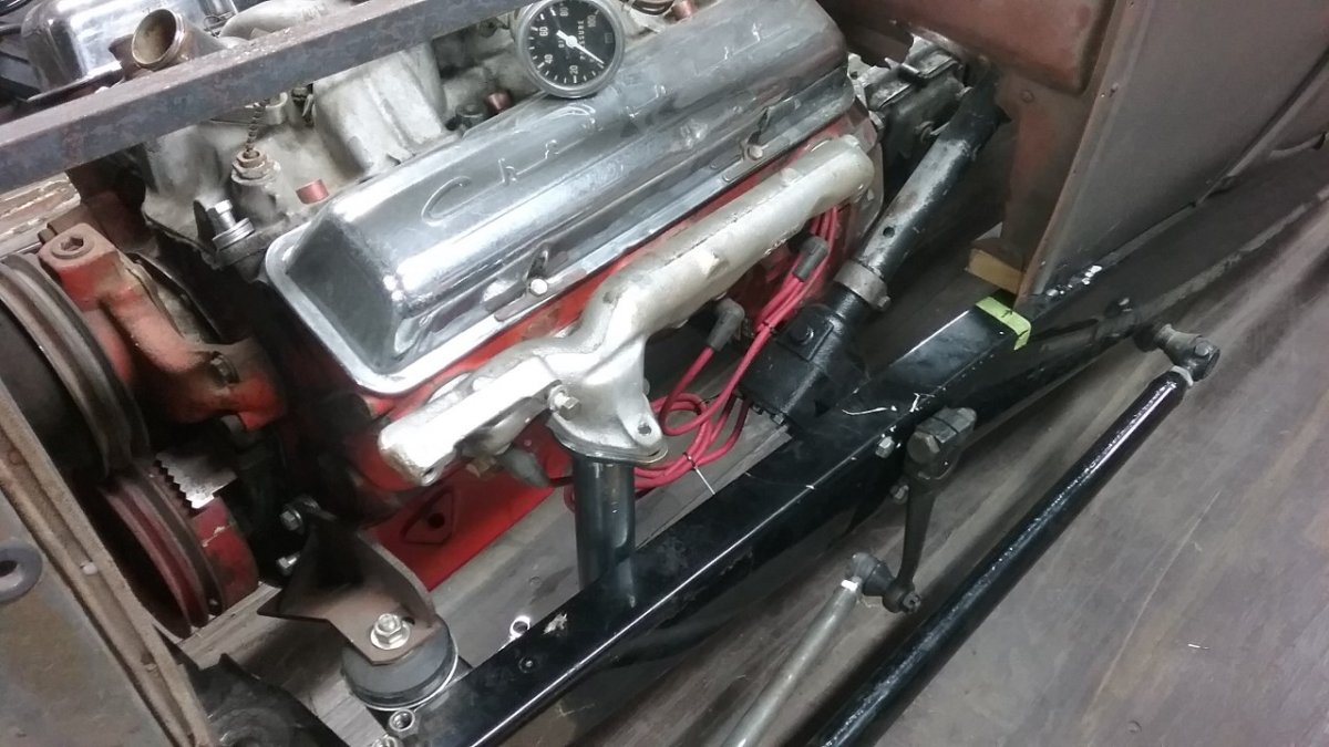

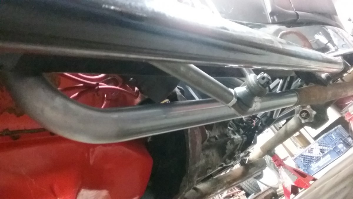

    While I was under the car tacking the exhaust pipes in place I discovered that the reverse lever and rod on the Hurst Compe***ion Plus shifter didn't clear the crossmember so while the forward gears worked fine the car wouldn't have gone into reverse. I decided to fix it in the simplest way possible, by cutting out a section of the tubular crossmember,, turning it upside down and sideways,, and welding it back into place. This would give the lever room to swing and a small cut to the side would allow the rod to clear as well. Worked like a charm...
    new roadster 120.jpg new roadster 118.jpg new roadster 115.jpg new roadster 116.jpg new roadster 117.jpg

    Took a few minutes and ****oned up the modified crossmember today, and photographed the final layout of the exhaust tubes. I'm keeping this one as simple as humanly possible, not unlike the "roaring roadsters" of the late '40s which got their dirt track performance not from gobs of horsepower but from making the car as light as possible.
    The roadster in the final photo (photo credit goes to Don Montgomery, "Rockerhead" here on the HAMB) is the well-known '27 T-on-deuce-rails circle track roadster driven by Manny Ayulo to many victories and was considered the car to beat for a very long time in the late '40s CRA races at Ascot, Carrel and other SoCal dirt tracks. It was perhaps the epitome of hot rod racing technology at the time with wide track, long radius rods and low engine location. You may notice the not-so-subtle similarities between Manny's roadster and Arin's...
    new roadster 122.jpg new roadster 123.jpg new roadster 124.jpg new roadster 126.jpg

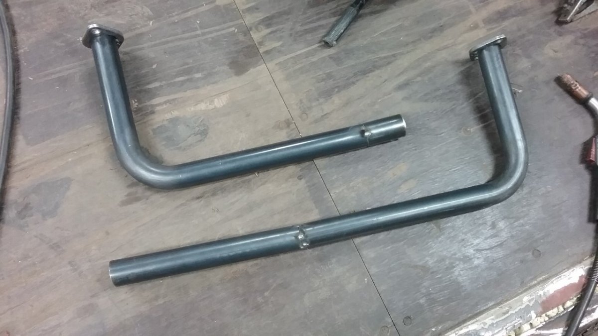

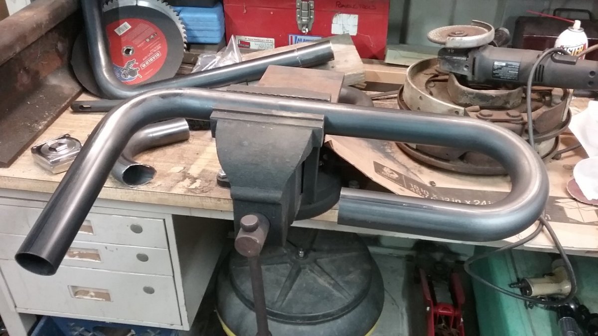

    Flush with victory following my successful attempt to get the upside-down '40 juice brakes working on the 'Banger Roadster, I decided to fill in a couple of late-evening hours by building the head pipes for Arin's car. I've shown the components earlier in this thread, all sourced online, including the manifold flanges which fit the '55 - '56 Chevy cast iron exhaust manifolds I'm using and the 1 3/4" tubing bends I got from Speedway Motors.
    Building the head pipes was really simple thanks to superior planning and a healthy dose of dumb luck. The drop section of the tubing bends turned out to be the exact length I needed to get the pipes to line up with the '36 Ford driveshaft tubes I'm using as collectors. One of the pipes is a little longer than the other due to the manifold design but other than that they're mirror images of each other side to side.
    They're just tacked together now - it was getting late - so I'll finish 'em up in the morning. G'night all.

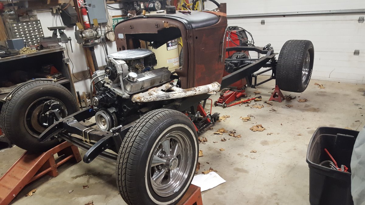

    Over the weekend I finally got the two roadster bodies switched and onto the ch***is where they will stay. The Brookville body is now on the 'banger ch***is and the Henry body is on the '32 rails which is under construction as the Arin Cee Roadster.
    Not to waste any time today I did the rear subrail modifications that will allow the A body to sit correctly on a Deuce frame. It's not rocket science, but I want mine to be a little bit different than most. I want the trunk to have a flat wood floor like the rest of the car. So instead of removing the original subrails and replacing them with curved ones from Steadfast Manufacturing as I had originally planned, I made it so that the frame comes up through them, leaving the original floor support intact.
    I found a little rust I hadn't expected so didn't get it finished today, but the photos show how far I got. It's going to work out just fine!
    new roadster 158.jpg new roadster 161.jpg new roadster 162.jpg new roadster 163.jpg new roadster 164.jpg new roadster 165.jpg ...

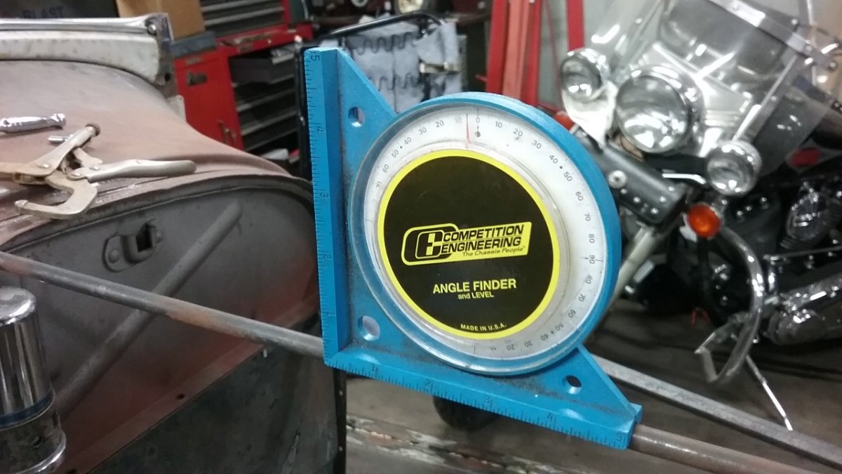

    With the Henry '29 body on Arin's '32 rails where it will stay I decided to revisit the radiator / radiator shell issue. The 2" upward sweep of the Deuce frame at the front places the '29 radiator just that much higher than stock. So what's a guy to do?
    I had previously decided that I'd go with "tradition" and leave the '29 shell at stock height even though this would produce a slightly awkward hood line. This is how it was mostly done in the past and didn't seem to bother the old time hot rodders one bit.
    But this time, with the car blocked at ride height and everything mocked into place, the angle finder came up with a slightly different reading: four degrees downward at the hood hinge while the top of the doors was six degrees downward - a difference of two degrees in the wrong direction! And this was with no rubber between the radiator and the frame which would further aggravate the situation.
    The problem is, for me at least, once I'd seen a '29 on '32 rails with a flat hood line the old school way of ignoring the misalignment just ground on me - a lot. So today I made a huge concession to hot rod "progress" and ordered a 2-inch chopped radiator from Custom Auto Radiator of Forked River, New Jersey. These are the same people who built the radiator in my current coupester with which I am very pleased both in the way it cools and with the outstanding workmanship. (www.customautoradiator.com)
    The new radiator will be built to my specs and should be delivered within a few weeks. And it will give the car the right-on proportions that I'm after with this build.

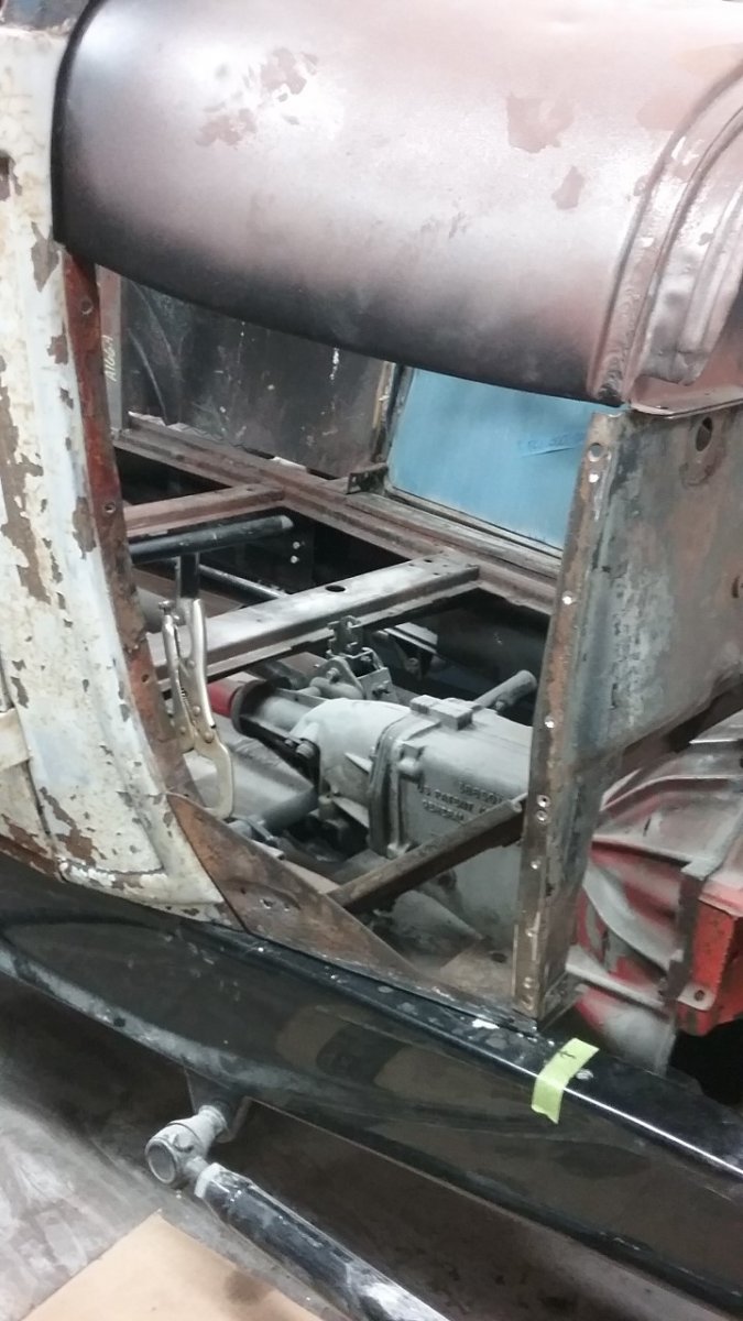

    With the cowl section of the body removed and the rear subrails modified, the body itself settled down nicely onto the frame, so I marked the location with tape for reference during the body mount fabrication.

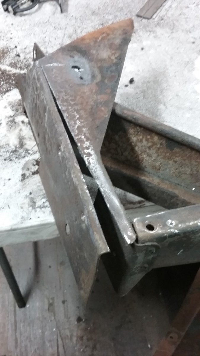

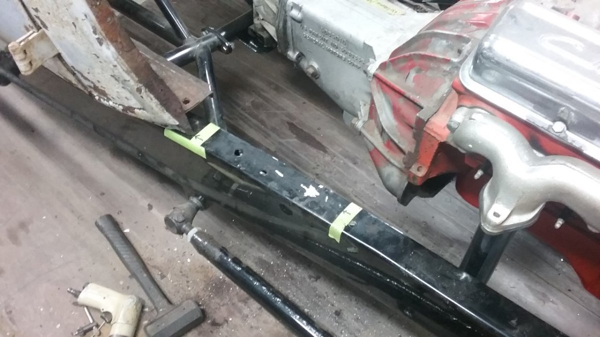

    Lots of progress today. Instead of cleaning the shop I decided to tackle the front body mounts and the wedge-cutting of the cowl to fit the upsweep of the Deuce frame. This will allow the front portion of the body to sit flush on the frame and will bring the front of the body down about a half inch at the cowl. Yes, it's a lot of work to go through to gain a measly half inch, but when combined with the shortened radiator the overall effect is very slinky...

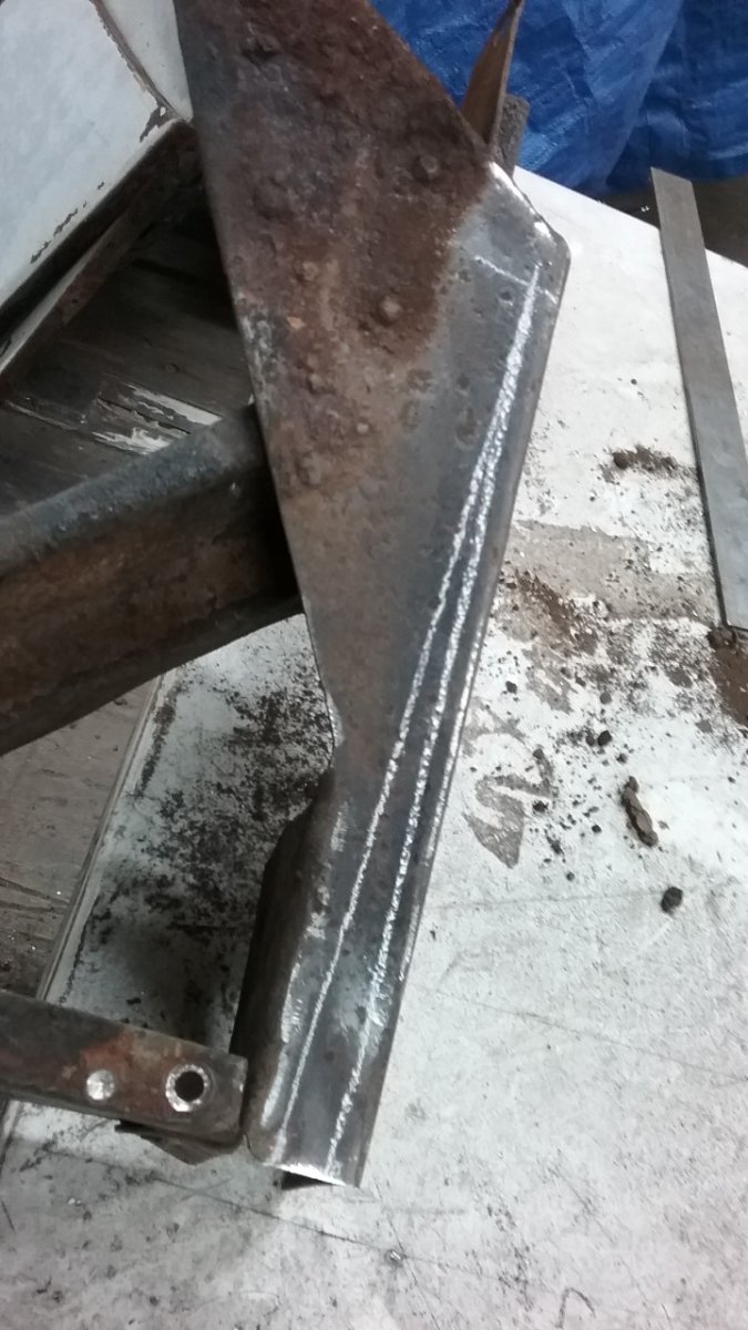

    After peeling off the lower cowl panels, I marked the wedge to be removed - about a half inch at the front to match the upsweep of the '32 frame.

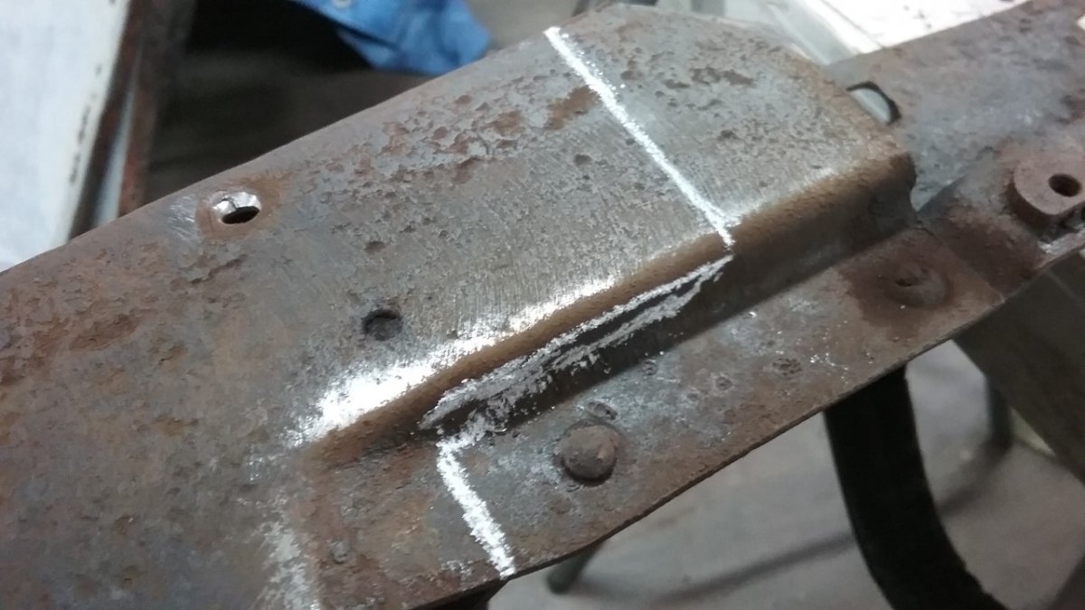

    A similar amount must be removed from the inside of the inner structure as well.
    I used a cut-off wheel to remove the wedge on the outside, same on the inside.

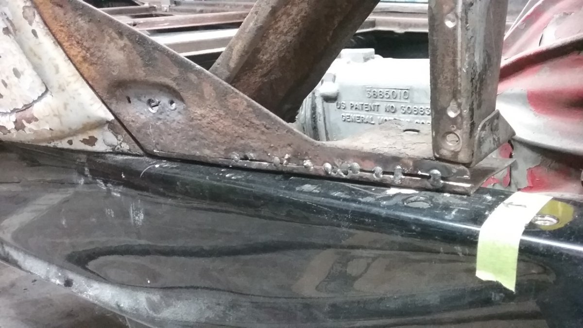

    I had removed just a little bit too much material so I adjusted the gap to suite, then tacked it together on both sides for a trial fit. There needs to be enough space for the outer sheet metal to slip between the inner structure and the frame when it gets put back on.
    Yup, everything fit the way it's supposed to when I mocked all the pieces back together so I welded it all up solid. I'll cut the outer sheet metal to match and reinstall it once I've finished fixing the rust.
    A casual observer might not notice but Arin's roadster is starting to look downright slinky thanks to closing up the gap between the body and the frame and the slight re-angling of the body downward at the front. More to come...
