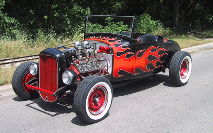

    Proportionally, another problem the car had was that the windshield was just too damned tall. You can visualize the issue from this old image of version one of the car:
    So, the obvious issue is to chop the damned thing. Unfortunately, I was under the knife when Keith did that and didn't get any progress shots at all. When I finally did get out to the shop is when my battle with the rebels got really heated... I was certain that I was dodging bullets while taking these images of the final product:
    Nice and tidy now...
