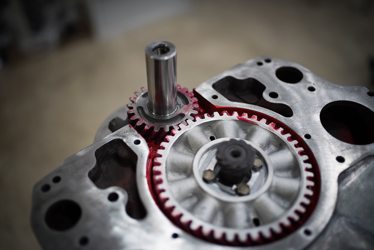

    Anyway, after the crank was in Keith stabbed the 400 jr. cam:

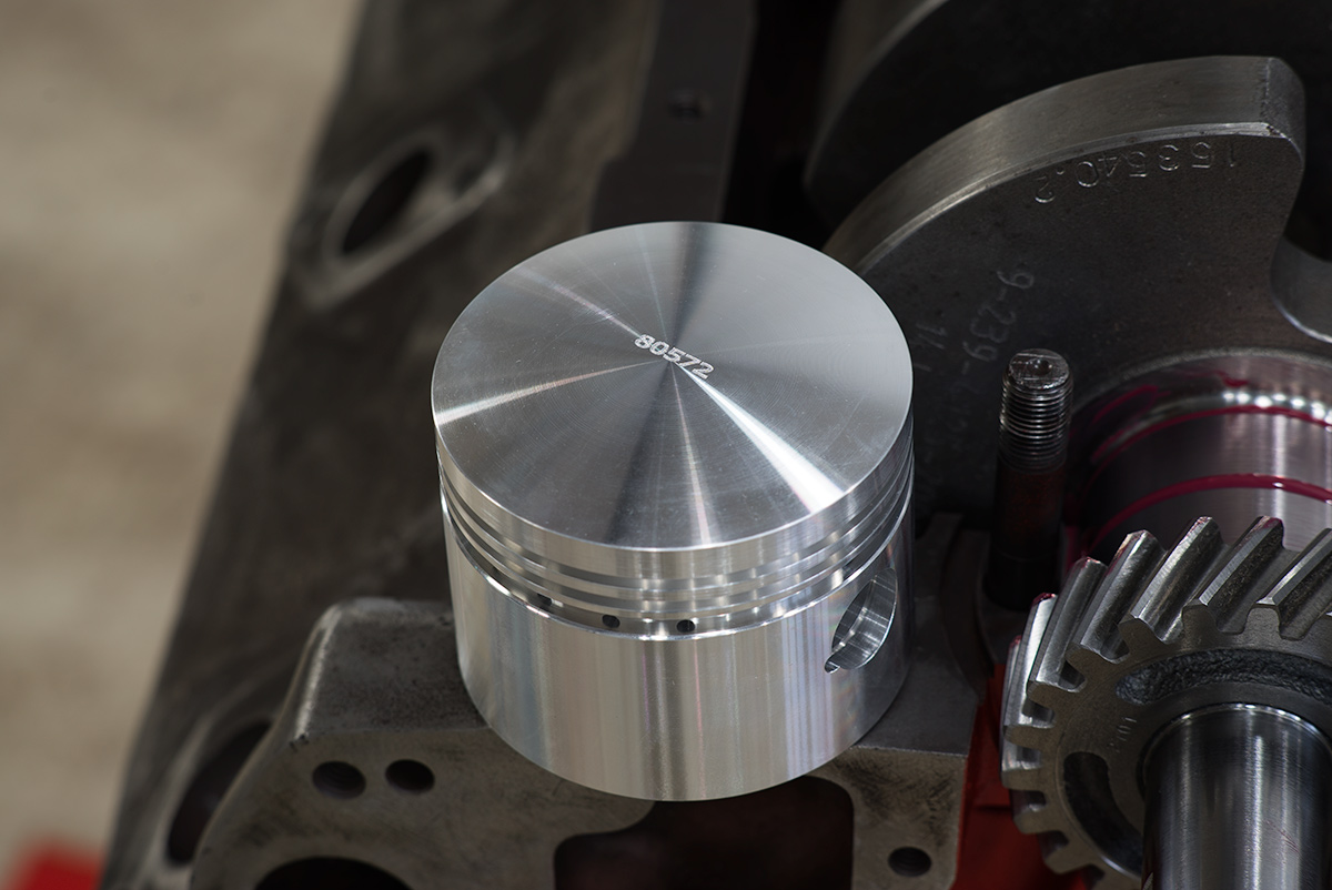

    Then, it was time for the pistons... The pistons Keith is using are Ross and they are both light and gorgeous as all hell:
    As I type, Keith is plugging in the second piston...

    Never understand why builders put cam in after crank. I find much easier to gently feed cam through cam bearings when no crank in the way. Then crank goes in second.

    Ryan , maybe you show us how Keith enters the piston with rings
    In the releived ( or is it spelled reveiled?) block ?
    I causes trouble with the stepped deck .
    Thank you

    I honestly don't see how the crank could get in the way... Keith tends to make **** look easy, but the cam slid right in... took seconds.
    Not sure I follow you. The pistons went in conventionally.

    The piston ring compressor doesnt lay flat on the engine block deck,
    There is a litte gap where the relieve is.
    The piston ring may slip out there while you install the unit.
    Might not be a problem with 1/16 relieve and "normal" rings,
    But with metric rings and a 0.187 inch relieve.
    So i was wondering if Keith modified the ring compressor.
    Michael

    Gotcha... So this block doesn't have a real deep relief to it. Keith likes compression better than flow... cuz well, the flow on a flathead is ****ed anyway.
    Essentially, he just made sure the ring gap wasn't lined up with the relief and then gave the piston a solid tap to get past the relief. They went in like ****er.
    That said, on blocks with a really aggressive relief he makes a ring compressor to fill the relief space to make it easier.

    Have to admit; I have the cheap engine stand that only bolts on bellhousing so cam goes in horizontal - he able to do it vertically with gravity holding it straight. Even with long bolt in end of cam, easier with no crank in the way.

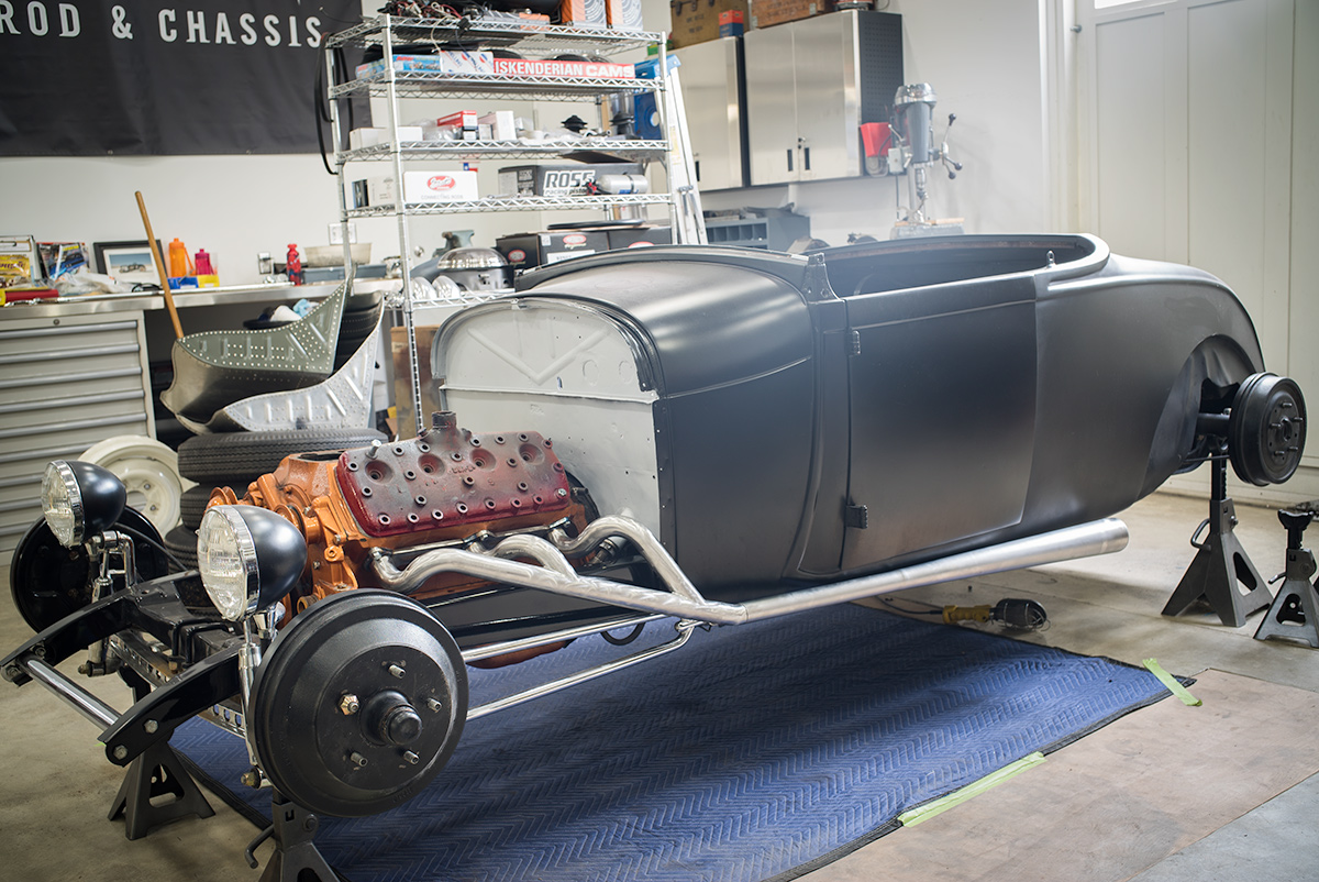

    While waiting on parts for the motor, Keith decided to tackle the firewall. It's in rough shape... Through the years, a number of wholes have been drilled, roughly filled, bondo'ed, etc... You can kind of see that in this pic I posted earlier:
    Anyway, it would have been nice to cut it out and do a new firewall for sure... but the budget and timing didn't work out for that kind of thing. Instead, we created some templates and called FPM metals to have them cut some engine turned panels for us. They turned out killer.
    Note: protective plastic is still on the panels obviously...
    As I type, Keith is currently out in the shop creating a piece to hide the 90's where the top and bottom of the firewall come together... Updates on that soon.
